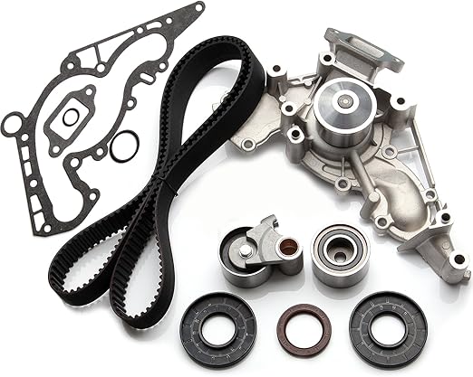

Not sure it there is another (more complete) kit available but here is what I got:

Looks very nice! I don’t see a tensioner.
does this kit have a name and/or model number?
many of us selected the Aisin TKT021 kit.
https://www.rockauto.com/en/catalog/...nent+kit,16088

Here is the description provided by Amazon:
Timing Belt Kit with Water Pump, ECCPP TBK298WPT for 1998-2007 Lexus Toyota Tundra 4Runner Sequoia 4.7L 2UZFE

this kit does not include a tensioner...you MUST change the tensioner...below is the link to your kit.
Amazon Amazon
here is the OEM kit TKT-021, do you see the tensioner?
Amazon Amazon

Why would they even sell a kit without the tensioner? That's just craziness.

Lower price, attracting buyers. This kit is not Aisin. Read one comment, water pump seal blew almost cost him an engine.

Should it matter that the kit is also for a 4.7 liter and our SC's are 4.3?

good catch!
i think these kits are for both engines...it says it fits the SC430.

Thanks to all who responded. The info was very much appreciated. Today I returned the kit I originally bought and ordered a different one- this one has a tensioner.
