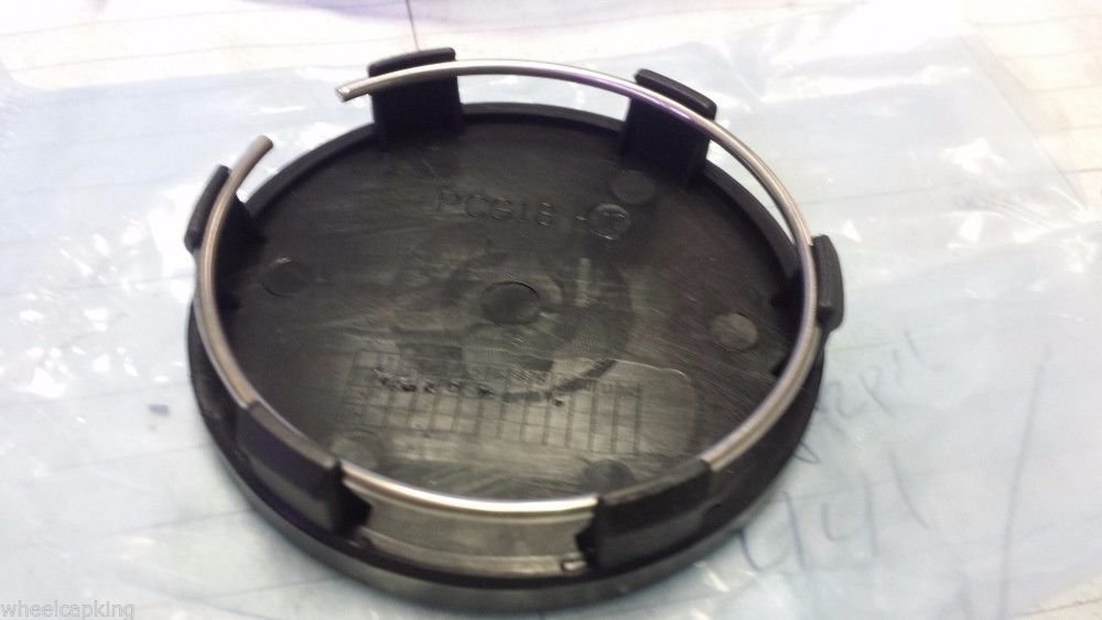

these CT200h center caps are 2 1/4" (although not black, but paint could fix that if they would fit in the new wheels).
Does anyone have any experience with center caps? Is there anything different about aftermarket wheels or is one 2 1/4" cap the same as the next?
this is what the back of the aftermarket wheel cap looks like:
Here is the back of the ct200h cap:
