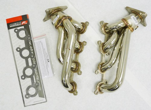

I wish there was more data on the OBX headers. Less than half the cost of PPE. But PPE has dyno sheets on this forum that show about a 20hp gain. I can't find a dyno sheet for the OBX.
Also, the general consensus is replacing headers is so labor intensive, if there's a defect (which is more likely in the case of OBX) you would lose a ton of money replacing them.
https://www.ebay.com/itm/OBX-Racing-...-/173105515879
