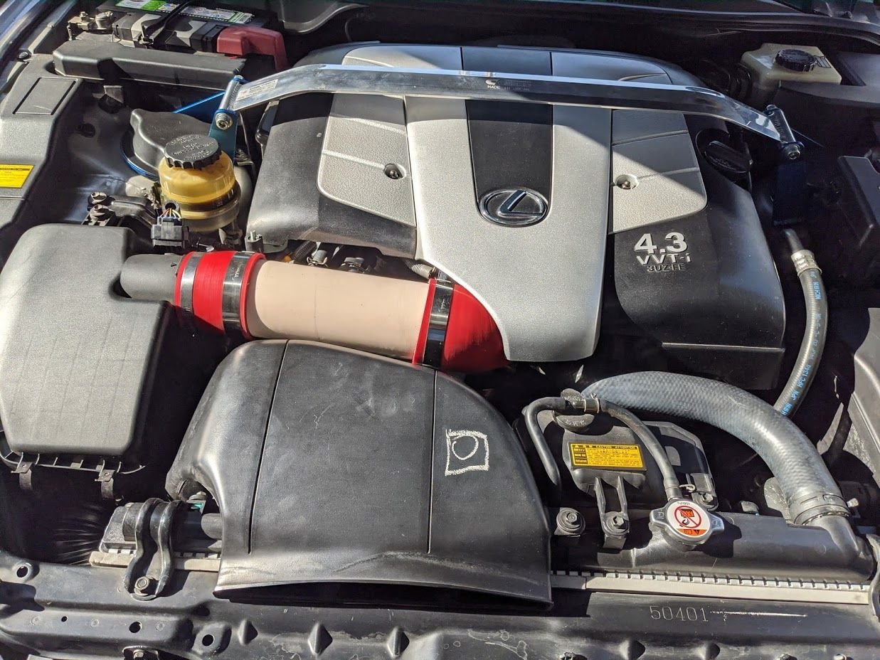

Hold my beer...
Did this in anticipation of the new ECU mapping.
You are correct, the OEM design is the best I've seen so far.
The temp is about 5-10 degree higher than ambient temperature.

Originally Posted by digitatc
Hold my beer...
That looks pretty good, the only word of caution I would have is that from my research, it seems the "helmholtz resonator" in our intake tract is actually functional. There were dyno sheets I came across where an aftermarket intake pipe actually lost torque on the dyno. This was true on my Miata as well. YMMV but something to think about.

Before I did this, I was searching as well, and seem to me it helps reduce noise so I was like wth, I want more noise.
I'm right there with you... I debated about getting rid of it because I kind of wish the car was a little louder.

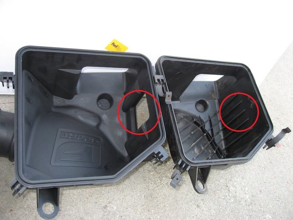

Nice job. I also made a hole like F sport and broken all slats in intake box like on this photo. Now i like my intake sound.
what car is that F sport intake box from?

That airbox is the IS F sport bottom part.
very interesting... I assume it's not the same size, so we can't swap, can we?
I wonder what effect the smooth vs slotted airbox has.
EDIT: Here's another CL thread talking about the regular vs f sport airbox on an IS.
https://www.clublexus.com/forums/per...ntake-box.html
I'm curious, did either of you notice a big difference in sound? I don't think this will generate any power, but I'm considering it if I can get a little more growl.

It's not the same. He just want to tell us that he did break all the fins from the SC430 box to make it like the IS F sport airbox.
Smooth > more intake noise.
I think the fins are there to reduce the noise.
