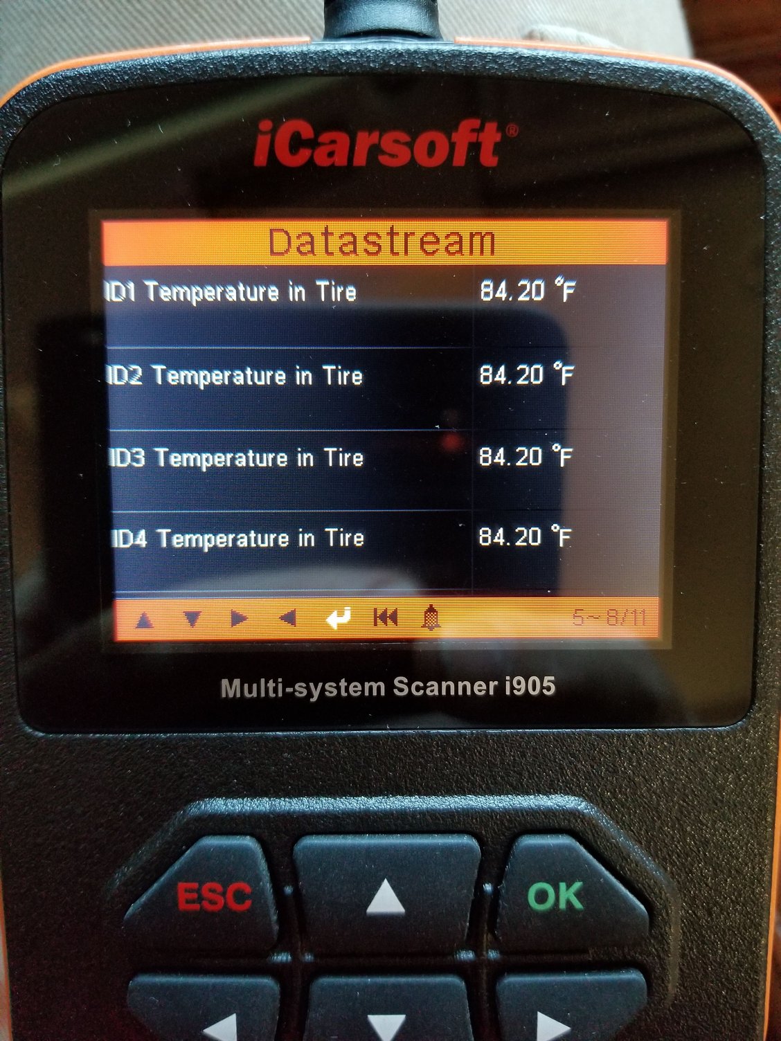

Well. The i905 surprised me again. It not only gave me tire pressure. It gave me tire temps and Battery voltage from each wheel.

What is the chance all four tires are the exact same temperature to a tenth of a degree?
Just asking.

Would you happen to know what full batt voltage is? The i905 was an accidental buy for me. But it properly diagnose my top failure too. Dead on. I need to start going through YouTube and see what exactly I can do with it. I'm a big proponent of everyone having their own scanner. It's just one of those things that we only pull out when somethings wrong. And I know it can do more than that. A lot more.
Just asking.
Good question. She had been parked jnder a carport all day and hadn't moved. These are after a couple of short drives.

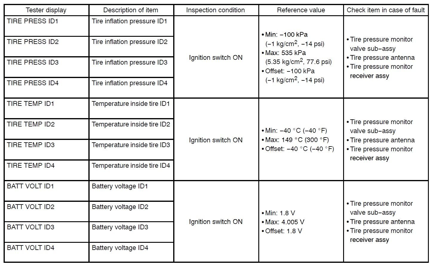

Good to see you're getting different values under differing circumstances.... Here is a chart with the Reference Values for the TPMS sensors. As well as a PDF with component locations throughout the car. (02-06 year models)

Perfect. Battery voltage min is 1.8V. That means I probably have awhile before I have to change them out. Considering the best price I have found for a set of four was $322.58. I can use that for a couple of other things right now.
