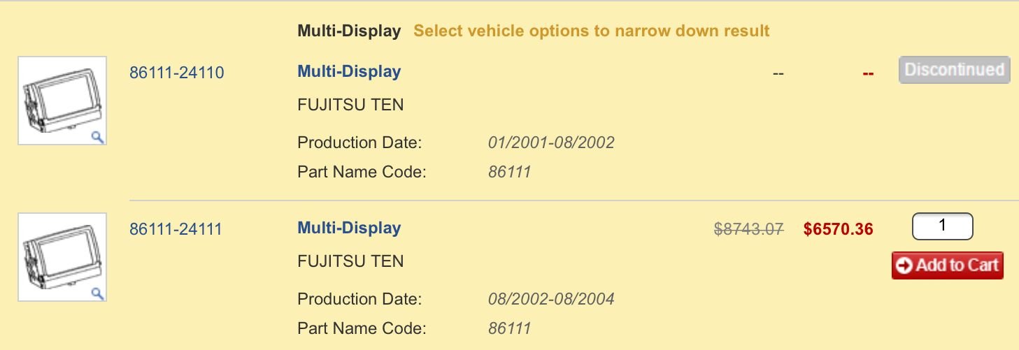

Last month my Nav-Screen started to act up, no more tilt and no more closing of the door. As I just had the car at Lexus for the 2nd time around fixing the front airbag, i asked them to diagnose the unit. Motors are gone and their suggestion to fix was to get a replacement. Poor Service Adviser was shocked even more then I when the price rang over 7,500! I read about getting a used one and as I am not willing to change the motor, i would like to go that way. My car is a 2002, and I have seen replacements for that year and also for 2004, are these two years interchangeable or do I have to go with the 2002? They are the same price and I am just hoping the newer one would be a bit more reliable.

Should be fine. As the original was discontinued. But certainly isn’t a guarantee. Would depend on how much/often the unit you buy was used over time. (Notice production dates in graphic below)
I read what you wrote but this thread details the repair procedure... might try it out as a less expensive alternative with new motors as opposed to an unknown?????

02-04 fit not problem. 05 and higher have a different connection. also if you swap it with a used one and the screen is not good, changing screens is really easy and takes less then one hour.
