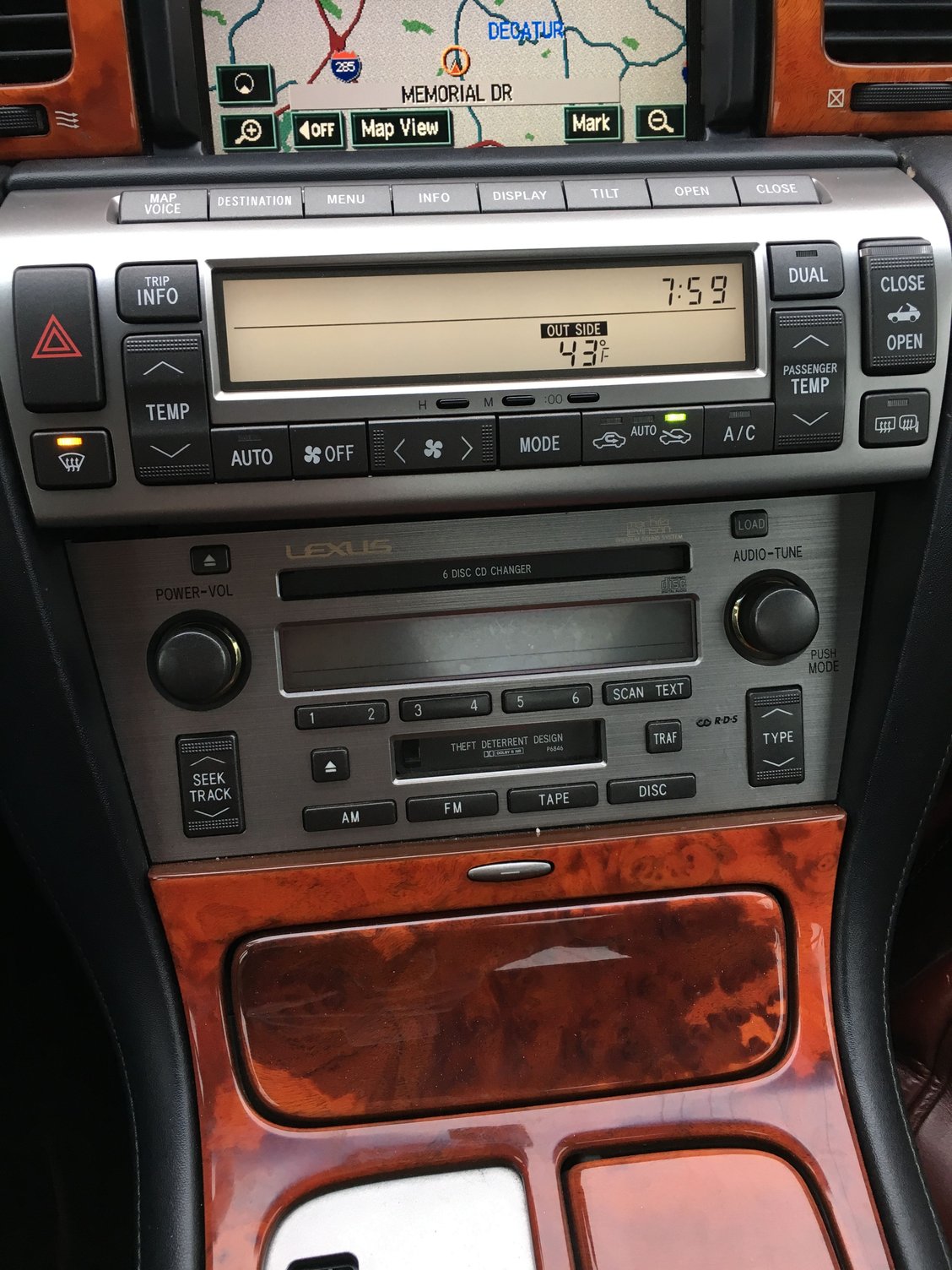

got my new climate control dash unit and it’s beautiful, top is working again. The old unit also had a dim lcd with the on screen text spilling outside of the characters so this is a huge improvement.
