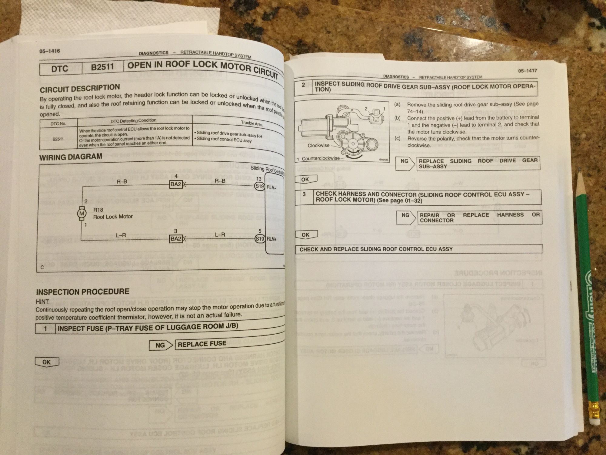

Went to the Lexus dealer yesterday. I had the codes read. DTC # B2511
What was even nicer, they did not charge me for the diagnostic.
they also gave me a inspection procedure.
first step is to check the P-Tray fuse.

Here is the repair procedure for a B2511 code. You can print it out and take it to your mechanic.
Based on the code, it is the motor I had previously told you about. Just as you said, checking the Ptray Fuse is the first step.
Lexus probably doesn't sell the motor separate. They just sell the entire hinge assembly. That is quite expensive new. Usually you can get an entire hinge for a couple hundred bucks on eBay.
Or you can just take the motor in to an automotive electrician and have them fix the motor.

Thanks it was that motor, but it was the gear assembly that was bad.
the metal gear was broken in pieces.
