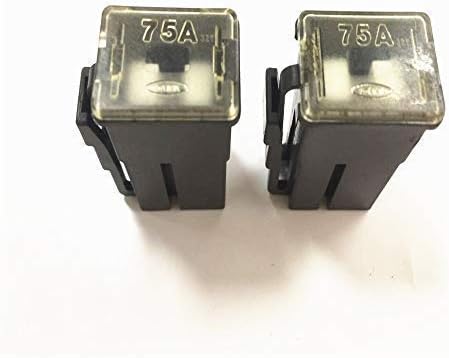

Car is running *_* . The problem was a fuse/fuses with a clear window/plastic 30 amp under the hood on the passengers side. Its not a normal skinny plastic fuse it looks like this:
Mechanic said the clear plastic was kind of foggy and it crumbled in about 20 pieces when he took it out. So he replaced it and all is well. Took him 1.5 hours to find the problem and he didn't charge me for the fuse/fuses because we're good friends.

I'm happy that it wasn't too expensive or a critical part like ecu, etc. The problem was not obvious i've never seen that kind of fuse before. It was confusing because the 4 fuses (on the opposite side of the car with all the relays in the box) were not getting any power with a test light.
