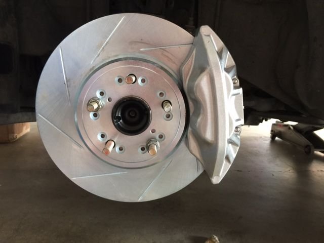

Hello all. I have read various threads here on this topic and still don't know which of the two - LS400 or Supra TT caliper swap will clear my wheels. The specs of my wheels are: Lexus Forged F Sport, 10 spoke, 19 x 8.0", offset: 40 mm (pictures attached). I am leaning towards Supra TT as this one does not need a RCA block in the front. However, want to avoid using spacers. Can someone who has done the Supra upgrade, please help.
Also, how much I could afford to lower (on these wheels) for visual appeal but without issues? Tires are Michelin Pilot Sport A/S 3 (245/40ZR19XL 98Y B). I know I can always experiment but I would like to learn from the experience here.

From the photos look like it should clear both LS and Supra calipers. If your wheels fit the LS400 and/or IS350 or IS F then it would clear for sure since they all have big calipers. I did the LS400 front brake calipers upgrade and used the RCA which lowers the car by 1" front end. So if you wanted to lower the front you might want to do the LS400 upgrade.
Thanks for a prompt response. Did you have to modify anything else in the front suspension when you added the RCA block since you lowered it by an inch? How difficult it was to add the block?

There's no difference relative to the ride to my feel of, it's actually pretty easy to install the RCA and no suspension changes, I didn't even do an alignment and I don't think you would need one, you do need to trim the brake dust shield since the caliper is bigger and the rotor larger as well, overall no surprises. I believe there is a write up here from someone's build, maybe someone can remember who and post a link to it for you.

RCA stands for Roll Center Adjuster, it's actually a spacer between the lower control arm to the wheel hub, since the LS400 front calipers is bigger and when turning the wheel will hit the lower control arm's knuckle therefore the RCA lowers the knuckle and clear the caliper from hitting. Now I am not sure if you need them with Supra turbo calipers but yes, it's only for front end and you can still install coilover with no ill effect, matter of fact that's what I'm going to fo next as well.

I would assume that the wheels would fit over the either calipers.
I don't think you can use bigger rotors than the OEM LS400 rotors since the arc will be different, as for the rear, I think there's not a kit that would be simple bolt on as the fronts and I have not seen any DIY regarding it either. The cars have ABS so it should balance well.

Supra calipers don't need them, that's correct, and I have not found rear RCA for our car to balance the height but I am doing coilover as my next upgrade.
