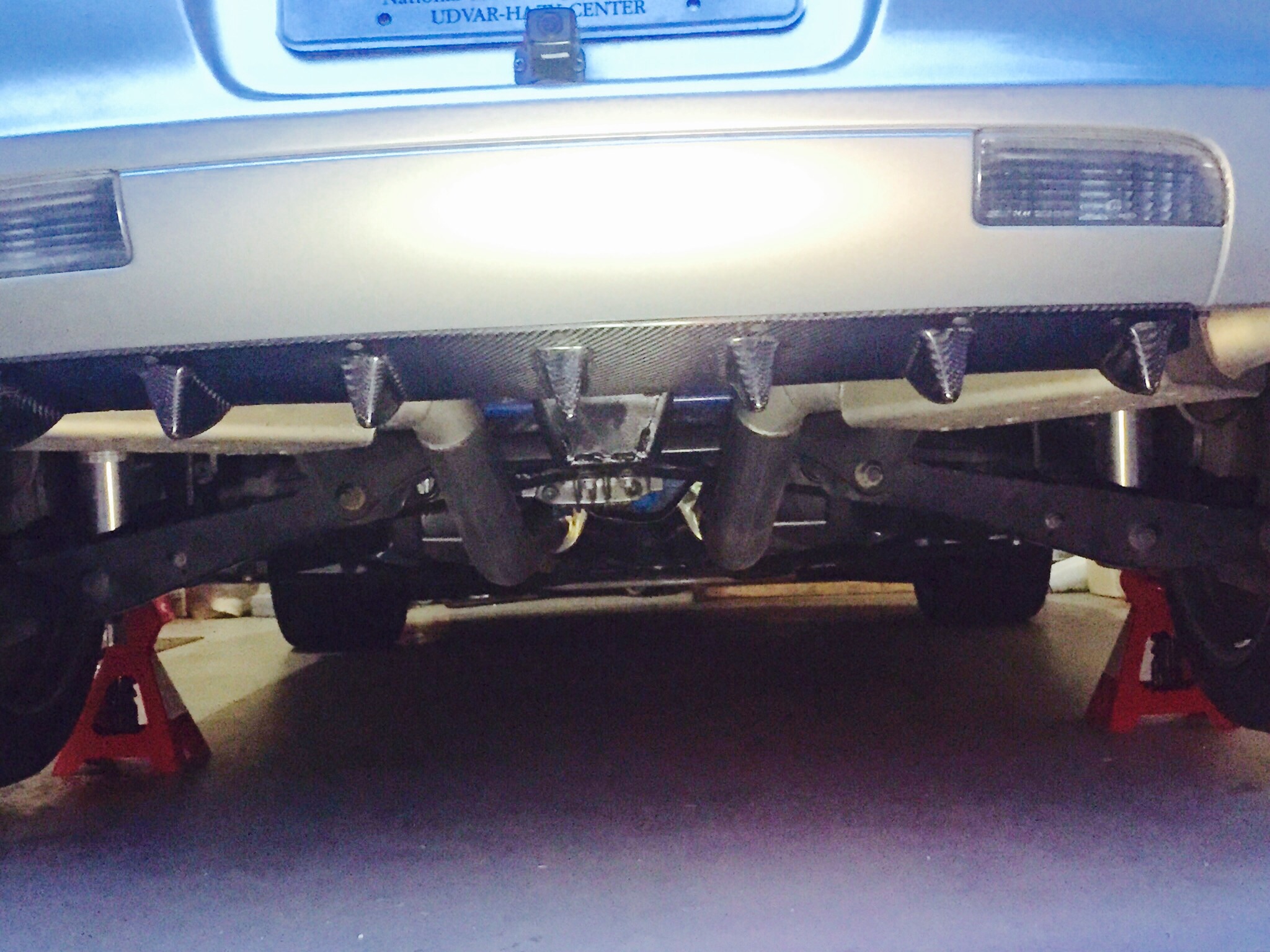

I went for the CF one and installed it last week. I lined the contact edges with 3M Heavy Duty molding tape and used masking tape to hold it in place while I drilled holes. Then I screwed in the black screws. I am not comfortable using self-tapping screws in CF w/o a predrill.
Looks great and nothing to block the airflow. I will probably fill in the sides though. Picture is with the car still on stands.
