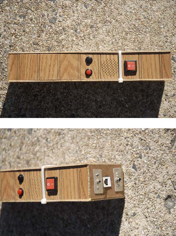

Here's the box...
Across the top - the red button is a manual "lock" button, the black button is a manual "unlock" button (you need to be able to press the lock/unlock buttons if you ever need to program/reprogram the modified key FOB)...a test speaker, and a test switch. The test switch is for troubleshooting. When switched into test mode, the audio is routed to an audio amp and to the test speaker, so we can hear if the box is receiving tones
Along the side - connectors for audio in, power in, and telephone jack that connects the main box to the key box.

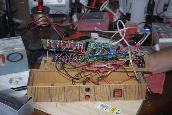

The inside of the box looks like this...
(from left-to-right...the DTMF decoder board, the delay relay board, an audio amplifier (for the test speaker))

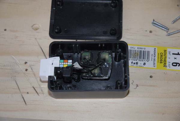

We housed the key remote in a separate box, connected to the main box via a 4-wire telephone cable (for ease of maintenance - aka battery replacement). It looks like this from the outside...
The inside of the key box looks like this...

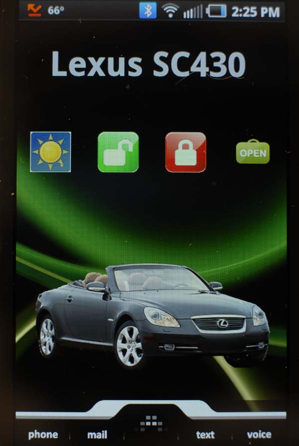

Here's a close-up of Tom's screen of his cell phone (the one he carries around - NOT the one that's left inside the car).
Tom's got a few Android apps installed on both phones to make the system easier to use, and more secure. He'll cover the software side of things in a different post.

The software side is pretty easy using off-the-shelf Android apps. The calling phone (which I carry) has five "home screens," one of which is pictured above. I just flip to that page.
Each of the icons (top down, lock, unlock, trunk) is a widget called "Limit My Call," which provides one press access. It calls the number, waits for the call to be answered, presses the tone for the appropriate function, then hangs up. By using this app, I just press one time and then can put the phone back in my pocket. It takes care of placing the call, waiting, and then hanging up.
The receiving phone, which stays in the car, runs an app called "Auto Answer." This app has a whitelist so that it will only answer when a specificed number appears in the caller-id. This security feature is extremely important so that some bozo dialing the wrong number doesn't put the top down in the rain.
