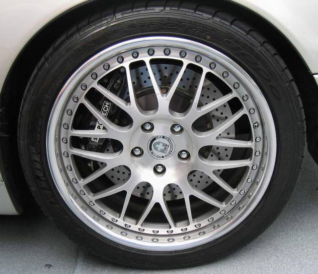

Speaking about the benefit of a multi-piece wheel, another point would be that you can choose
from a wider range of variation.
3 piece wheels are composed of an outer rim, inner rim and center disk, usually wheel
manufacturers carry several size specs of each piece and you can combine these to get
the best setup for your specific vehicle.
