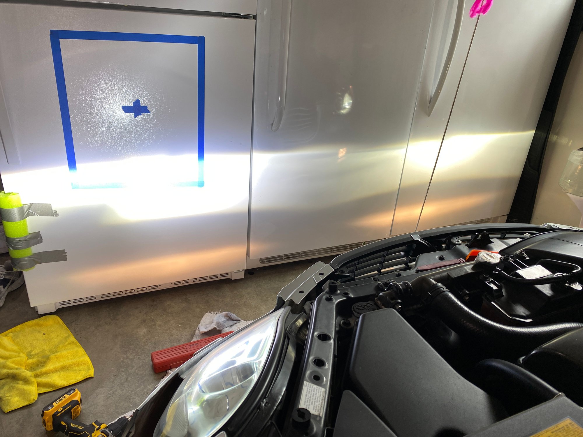

I put these on my 2003 and it was, quite literally, like day and night. Can see much further, broader and brighter and aiming does not blind on-comers. A little bit of fuss to get to headlights, remove ballast and install but not bad. Not hot. Completely satisfied.
https://www.sc430mods.com/product-pa...-on-the-market

^^ how hard is this to install, from what I recall there's little to no space and near impossible to change the fog lights and corner lights. Is the ballast underneath the headlights? Won't it leave a giant hole if you remove it. From what I remember I think all the wiring is inside the headlights, so it's not like traditional halogens, where you plug and play. It's not traditional head light plugs. Cuz power goes to the ballast and it's all wired internally in the headlight.

Here is a video from SC430 mods I found helpful after getting the headlight assembly out. I took off the bumper to do that. There are a number of posts and videos on that.

There is a newer version LED bulb in Amazon that converts hid to LED without any modification. I think that's much easier and also cost less. I will try that this week before my July 4th vacation.

I installed the LEDs from sc430mods recently and really like them. Definitely brighter. Driver side with the LED vs passenger side with the stock HID.
