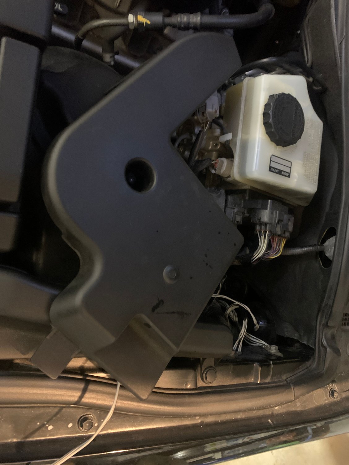

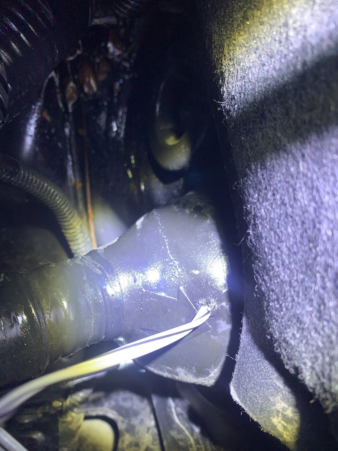

I found it. Ì you unbolt and swing the plastic cover to side, you will see the big grommet. Punch the hole and feed the wire through. Little lubricant would help.
Pretty easy.
