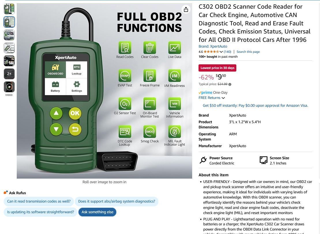

I have a $13 scanner that is MUCH MUCH MUCH easier and faster than using a computer based diagnostic system. Of course a $13 scanner won't read ABS codes, just the generic codes that all cars use.
