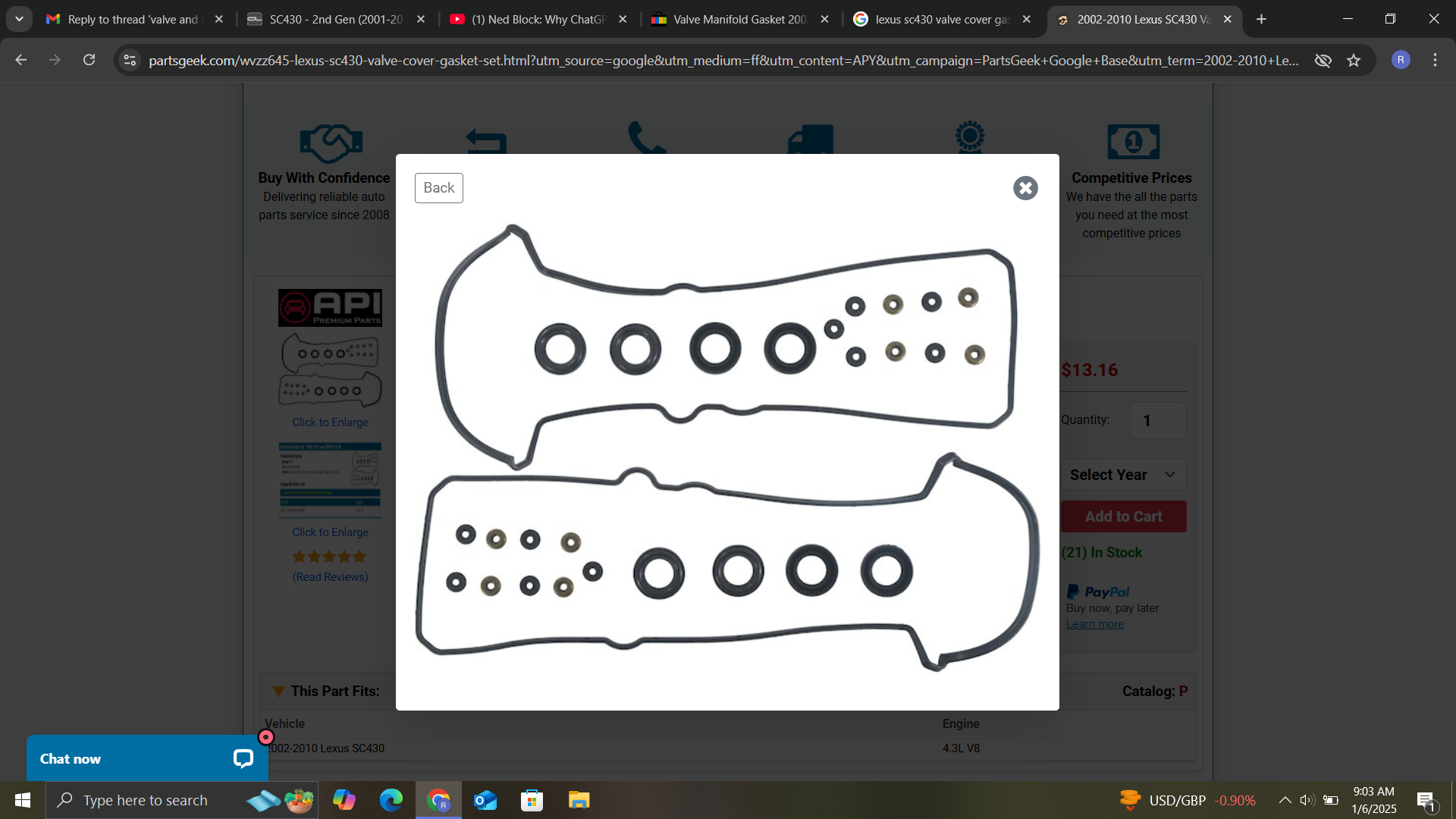

does anyone know what the small little circle things are for? its the only piece i seem to need and i dont know what they are, are they just washers? i was at the dealer and i needed to know... thanks

i will be changing not the two blackgaskets shown but the ones underneath the highlighted red (2x) valve covers because thats where the oil is leaking from as well as the 8 spark plug gaskets that why, (btw im having ptsd from this image), i already changed those gasket by accident to a stupid feltpro which means i have to change those two to oem so much work....

The small O-rings are seals for each bolt/stud for the valve cover.
