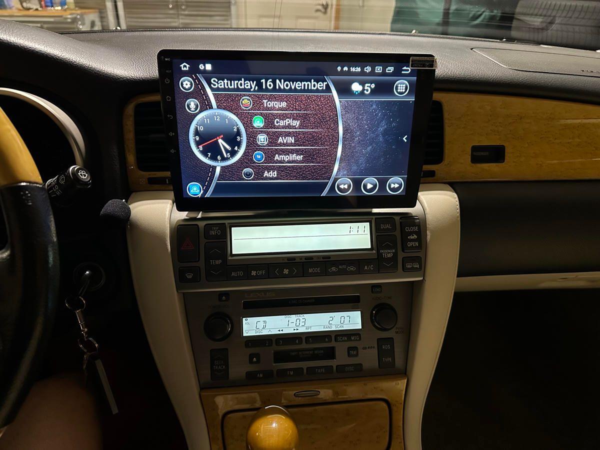

Replaced my 7 inch Carlaoer head unit (https://www.clublexus.com/forums/sc4...r-install.html) with a newer, bigger, faster 10 inch Eonon UA12S-PLUS.
The unit has a floating QLED 10 inch screen, Android 13 Wireless Head Unit
Octacore, 6 GB RAM, 64 GB storage
Amazon Amazon
Was able to reuse nearly all the wiring from my prior Carlaoer installation because the new head unit has the same pinouts os the old one. It's a fairly common pinout in Android head units.

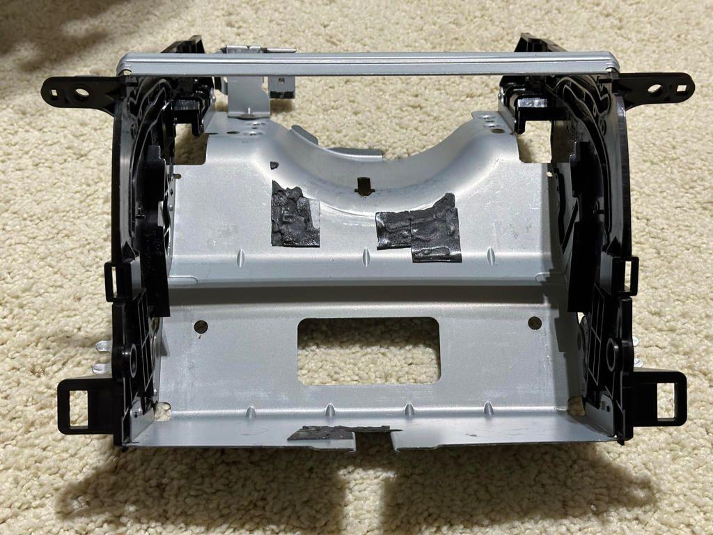

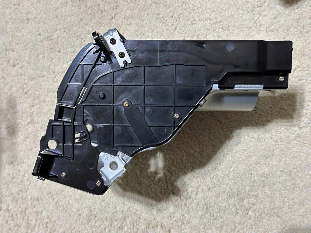

Stripped out Navigation frame to make new installation of new double DIN cage easier. There are about 90 mm depth available. The Eonon head unit is 80 mm deep.

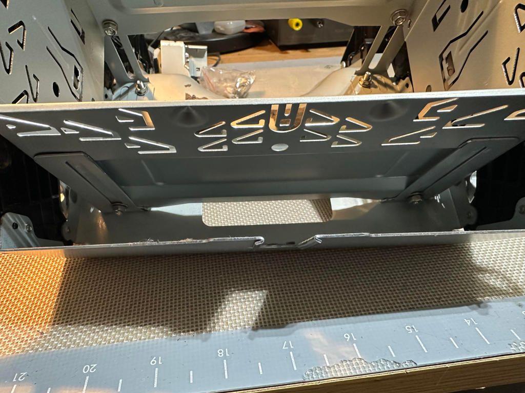

Double DIN cage was mounted in navigation cage using custom fabricate metal angle brackets. I used slotted brackets to enable adjustability of cage angle and position.

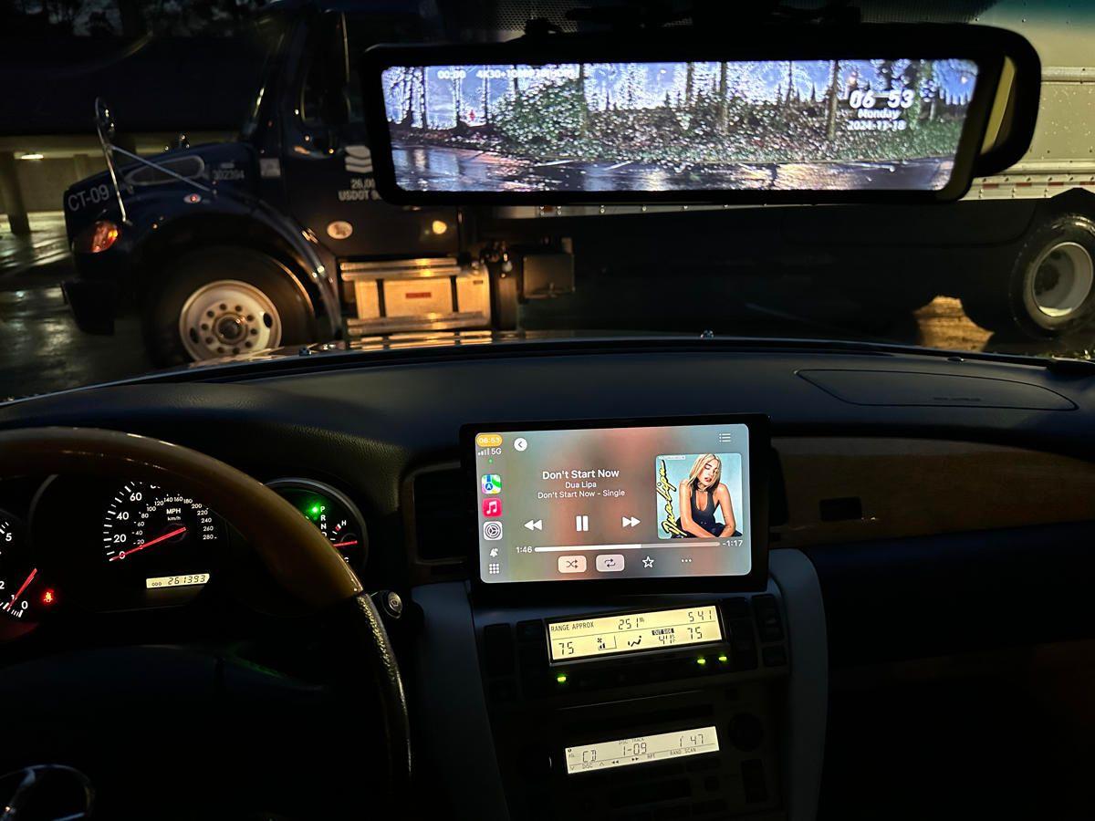

The cage and navigation frame were test fitted and adjusted BEFORE adding the wiring harnesses and head unit. I left enough harness for each connector so hard unit can be pulled forward out of cage without removing the navigation fram or taking dashboard apart. Here it is all put together with head unit and harness.

Love the big screen and how it can be set for height and angled towards driver.
