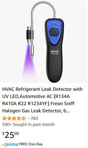

for only $25 it maybe worth taking a crack at it yourself

Thanks for your suggestion. I just went on Amazon first thing and ordered this device. For $25 bucks and excellent reviews, it’s too good to go wrong.
