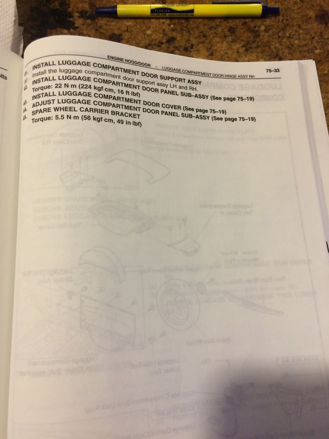

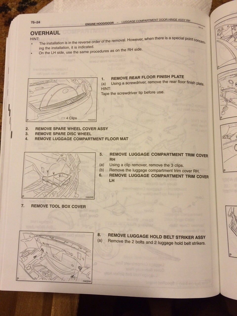

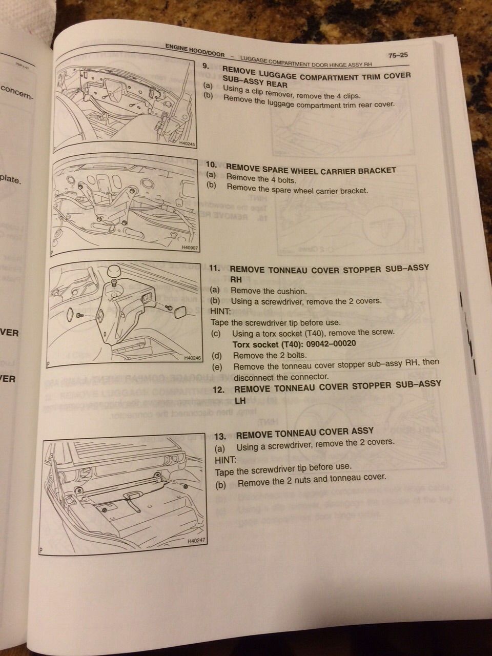

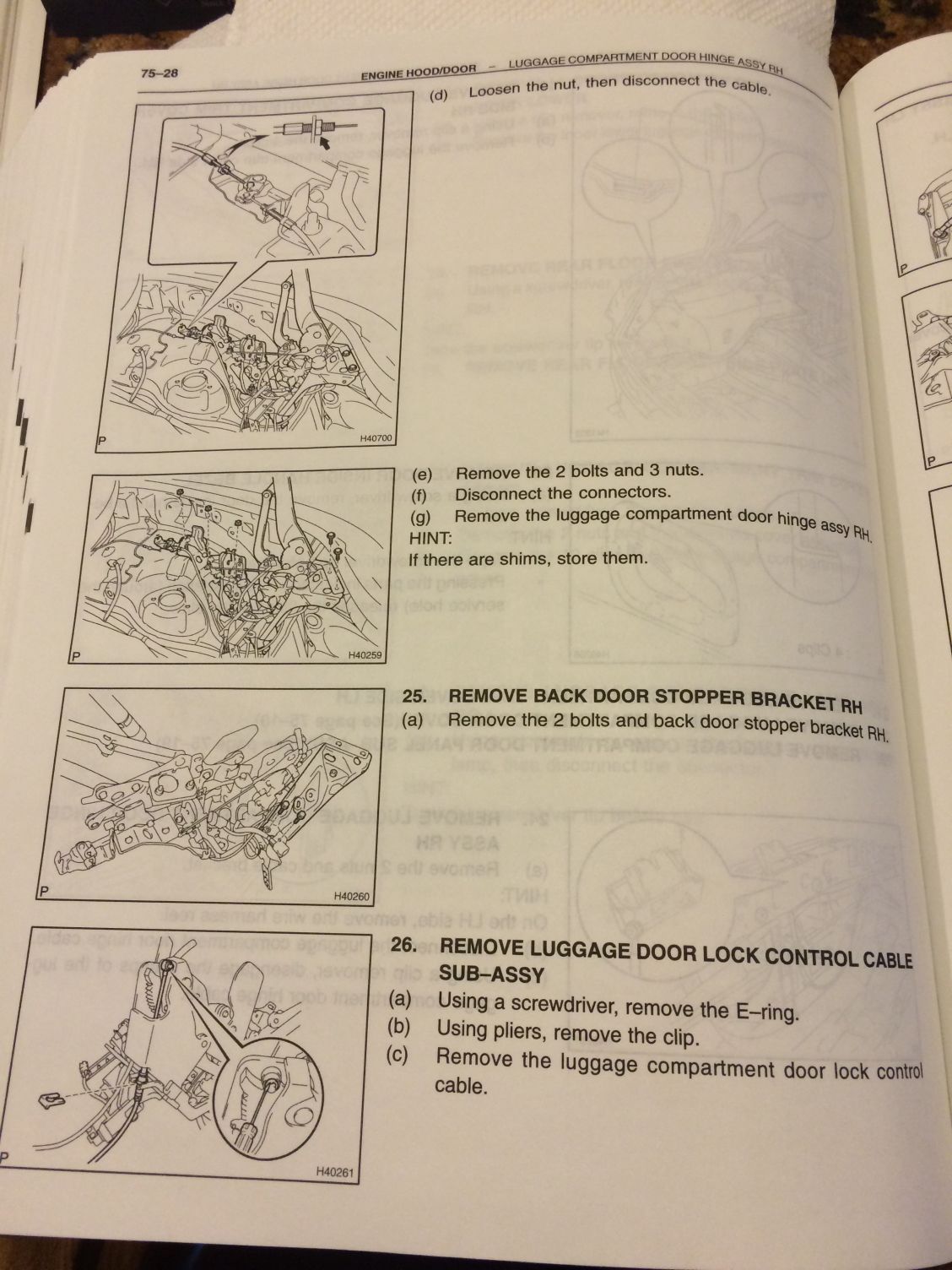

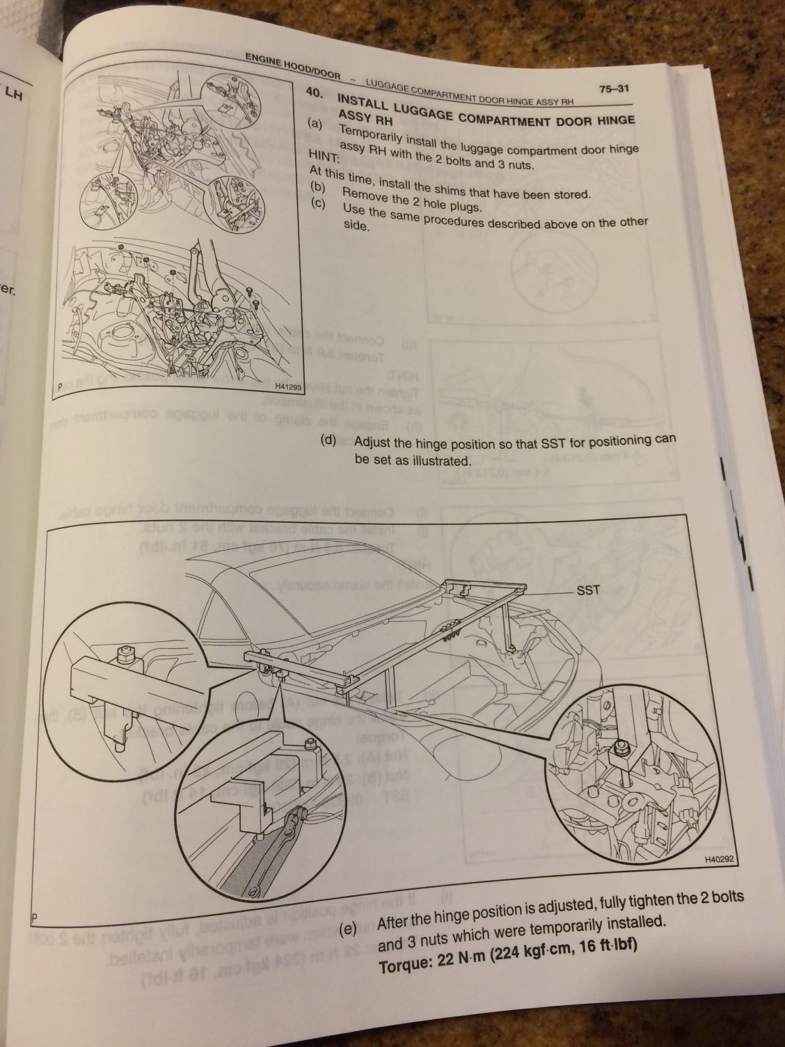

Code B2530 is a bummer, but better than a lot of other Roof Codes you could get.
Here are the repair steps from the Lexus Repair Manual courtesy of @BGW70. He really helped me out with resources when I was working on my top

So after you read through the 12 pages of Roof Operations, my gut feeling is the limit switch is just out of alignment.
I would start by taking out all the trunk carpet. This gives you full view of your hinges and the trunk mechanism
As you look at your hinges you can follow the wires to find the switches. They are micro switches, but aren't really that small and easy to spot.

So just an update, I was able to find the switch, and as the manual shows is a pain to get at. I did verify the wiring was good by disconnecting and putting a jumper wire between the terminals.
Btw the trunk switch on the dash works when I have the switch in bypass.
The bypassing the switch with the jumper wire stops the chime when driving. My son didn't have a lot of time to continue to troubleshoot so I will have to look at adjustment and see how the switch works at a later time.
