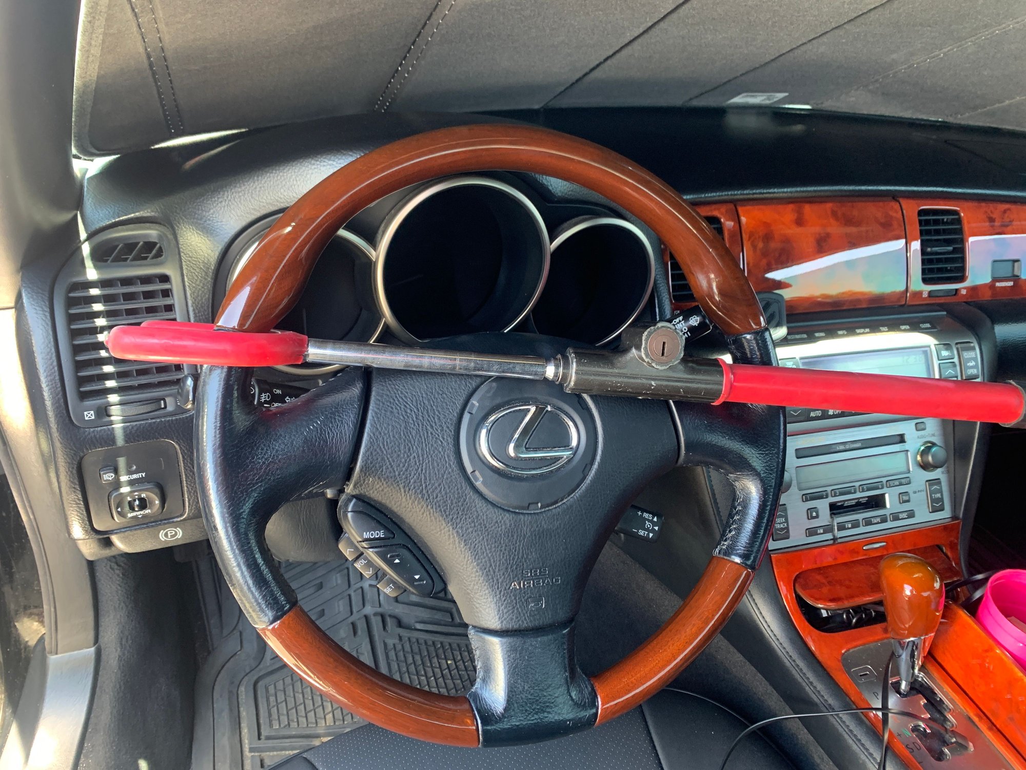

I did, however, use the steering lock, the one that goes across the steering wheel. Occasionally, it presses against the hub and makes the honk when I do the lock. It could be the reason, but it does not make any sense.

Coulf it be this device that caused the fuse blown and fried my horns?

Possibly enough pressure occurred to cause a continuous horn activation....and fried both it and the fuse?

that was a logical answer and what I thought but what baffle me that the fact the key is OFF when the car is locked.

Thanks Daryl. I’m pretty sure that my steering wheel lock bar did kill my horns. I will get the Amazon horns and will modify the lock so it will not touch the hub.
