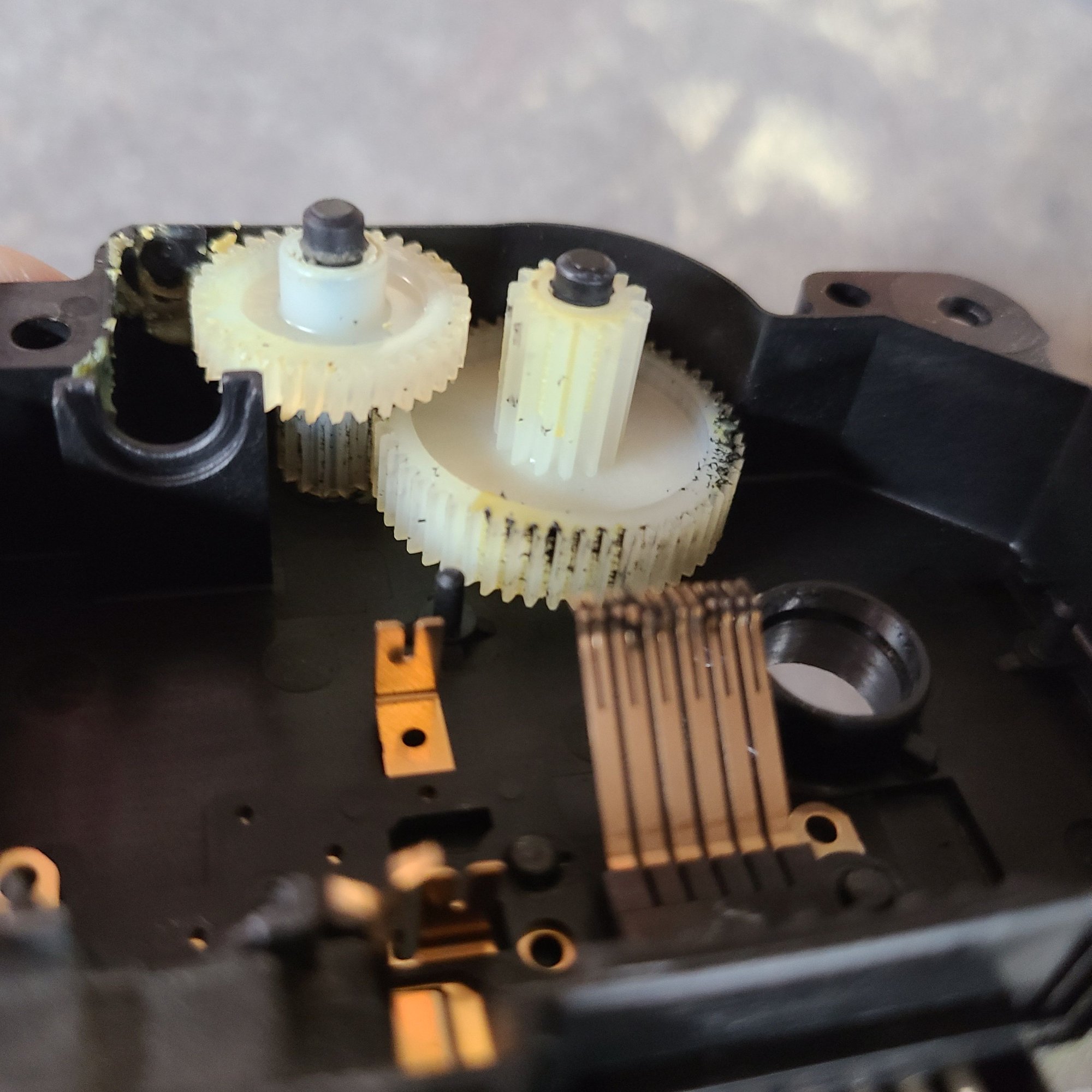

Thanks Bgw70, for your responses. After making one attempt to crawl into the driver's side foot well, I discovered that I was more claustrophobic than I expected, and aborted the attempt. I went back to my mechanic and asked him to try replacing the servo this way, rather than what "the book" says. He agreed, and $150 later (1.25 hrs of labor), my servo was replaced! That's the best $150 I've spent lately, and now I have a quiet car again with consistently cold AC. I brought the old servo home and took it apart, and was quite surprised at the lack of obvious wear anywhere. It makes me wonder why it was so noisy for so long - perhaps dirty electrical contacts? I took some pictures of this 20 year old servo - anybody need any of the gears??

i wonder if all that grease were cleaned up and replaced, the servo work again…then again, it might need a new motor too
