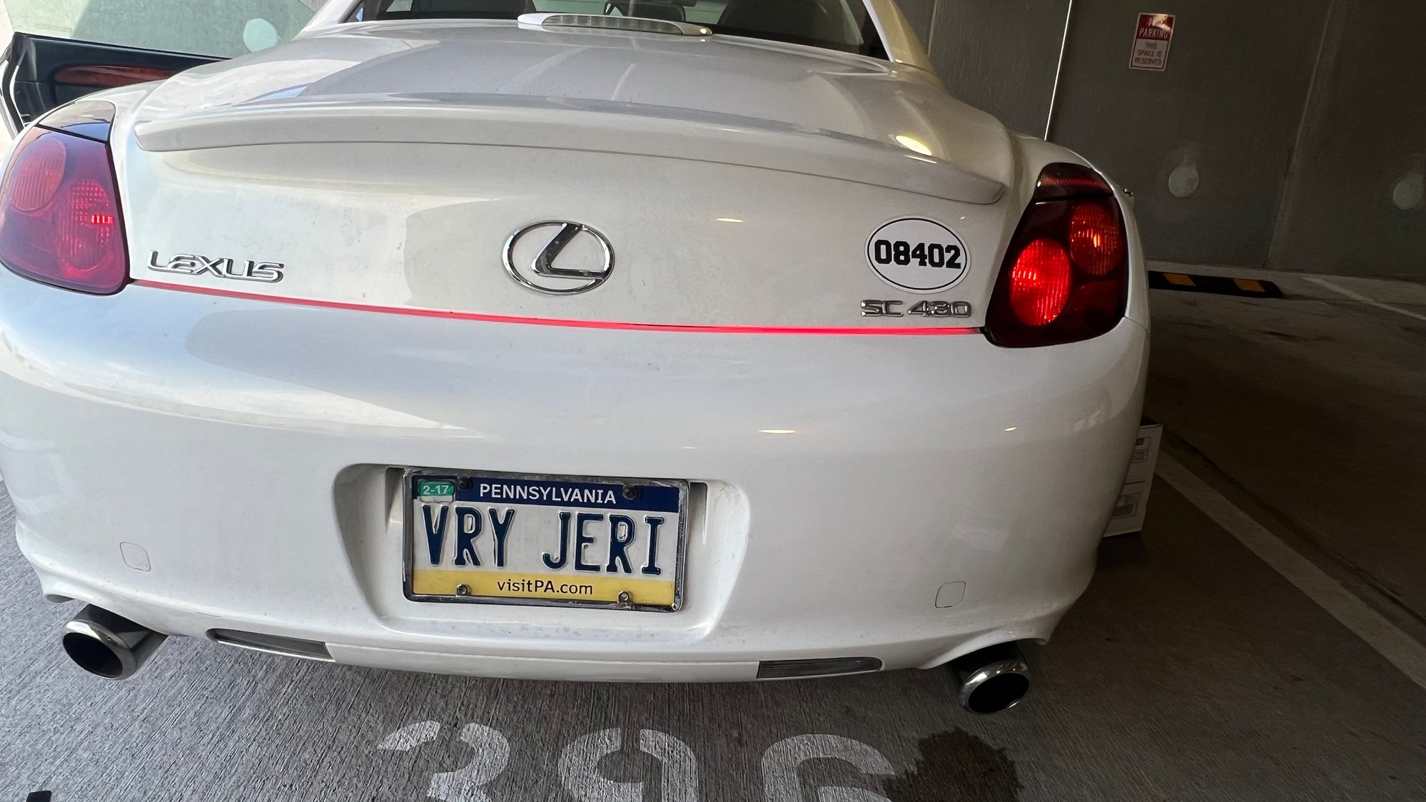

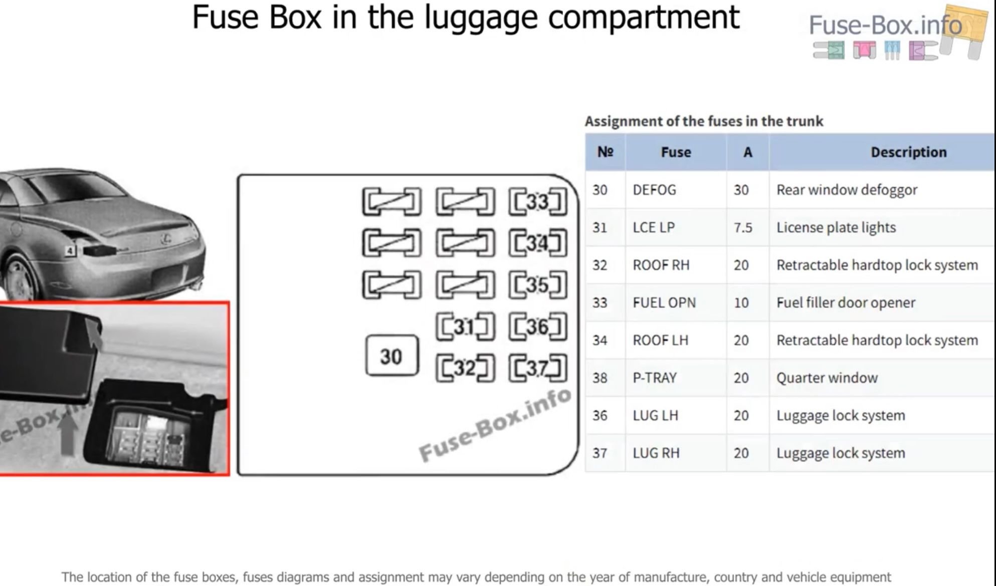

Looks great. I wired into the tail lamps, but ECM sensed LED and shut off the tail lamps. Fuse 31, license plate lamps, work but are HOT when car is off. If I need to run wire into the dash, where do I tap
What are my options?
