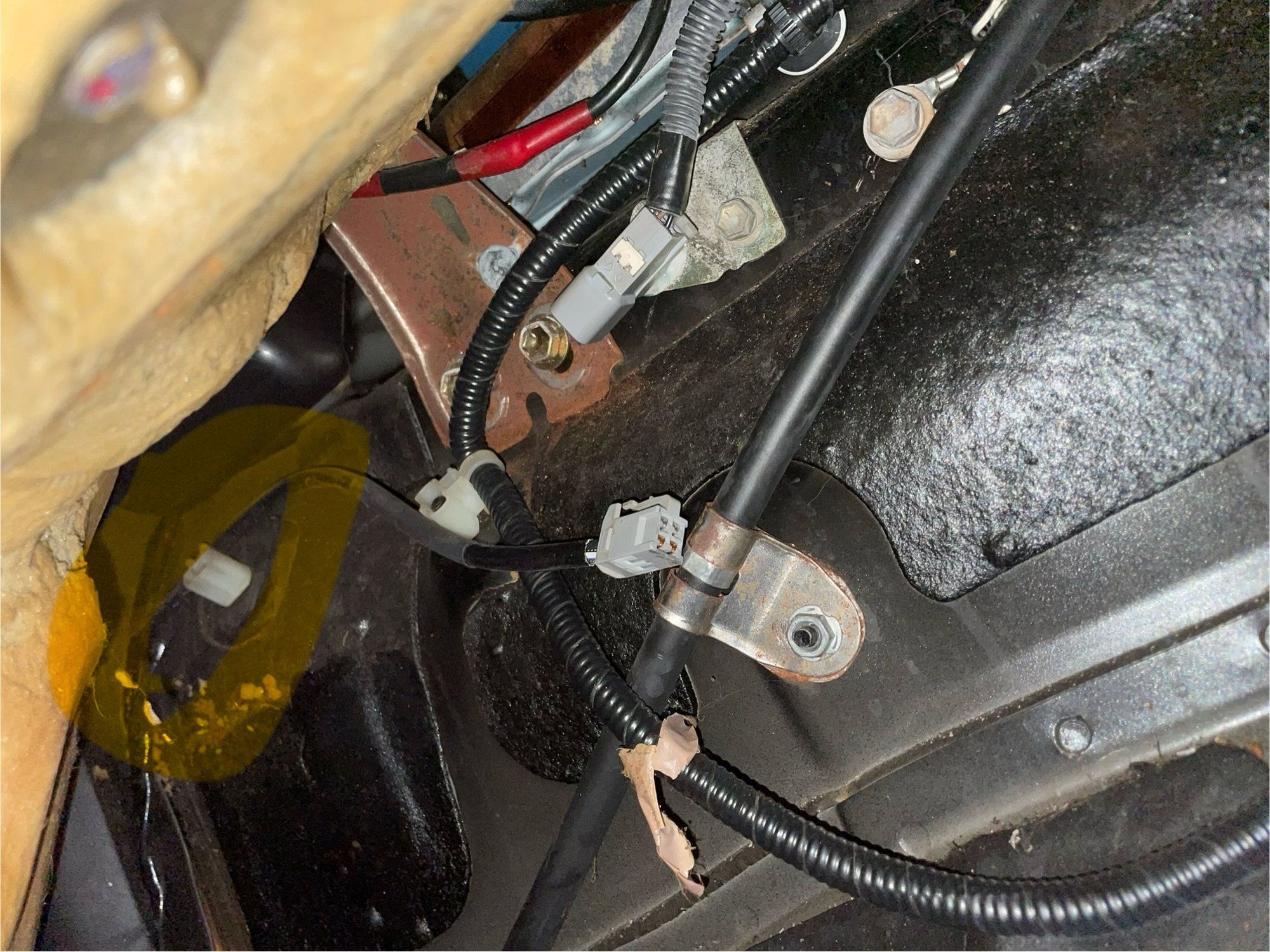

[img alt="Does anyone know where this bolt is located? Im not too sure if it’s on the outside of the vehicle or the center console. I disconnected the o2 under the carpet but this clip is also restricting movement.
Bank 2 sensor 2"]https://cimg8.ibsrv.net/gimg/www.clublexus.com-vbulletin/2000x1504/img_2e380d7d_0f4b_4ca1_a294_48385310af0c_4a93b367253091b15ee9958ade63c6388cabcd06.jpeg[/img]
Does anyone know where this bolt is located? Im not too sure if it’s on the outside of the vehicle or the center console. I disconnected the o2 under the carpet but this clip is also restricting movement. Bank 2 sensor 2
It appears that the photo is inside, under carpet of the driver side center console, judging by this post https://www.facebook.com/groups/2631...4519400591474/
