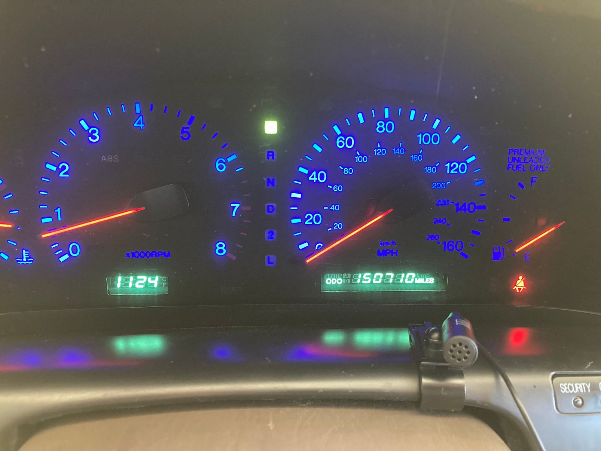

1995 SC300. Sent cluster out to Tanin 3 years ago for LED bulbs and general rebuild. Now have 3000 miles since that time, 1 bulb on tach is out, it will sometimes come on for a few seconds. Forget punching dash, doesn’t work! Contacted Tanin, warranty no longer in effect, they were less than helpful. Pulled out cluster, replaced than one bulb and checked all bulbs and sockets, no obvious damage. Cluster back in. Now 3 different areas are intermittently dark, but we know bulbs are good since they will occasionally come on. Contacted Tanin, they essentially washed their hands but said I could send cluster to them, will take 2 weeks to diagnose and problem may not be fixable. But they will sell me a reconditioned cluster for $600. ( I sang the praises of Tanin Auto Electrics back then, but now would not recommend them to anyone!).
So any ideas what might be going on with that cluster! Circuit board? Bulb sockets? Pin connectors? Please respond with your thoughts….much appreciated, I have learned a ton from this forum!
I will attempt to attach a quick video of cluster. (Video file size too big, attaching still photo, take my word that the areas you see with light out will intermittently come on for a second or 2).

Led’s are the issue. The copper tracers are thick and last forever. Sticking random leds in will get you failures like that. The car tends to have a lot of voltage spikes. SC’s are terrible about it. A diode on the main input was part of my engineering of the cluster lighting. It absorbs voltage spikes and it’s part of what engineers do when they design something versus just sticking an LED in it and trying to make a buck.
id recommend you replace the leds and then consider doing that to avoid failure in the future. It drops the voltage 0.6 in the circuit so not noticeable. You'll need a large one to cover the current of the leds. Thats up to which leds you use so you’ll have to do the numbers.
just ebay some wide angle leds if you want easy. If you’re willing to work a little use strips and get tons of lighting inside. A volt meter will get you set on polarity. Several slots are backwards voltage so it matters which one you choose.

My immediate plan was to go back to the original incandescent bulbs from Lexus ( if I can find them), do a really good inspection of the boards etc., and hope for the best. The diode thing you mentioned is likely beyond my capabilities and knowledge. I love this car and want to keep it going (as close to stock as possible), and have learned a ton, but it certainly comes with its frustrations!
