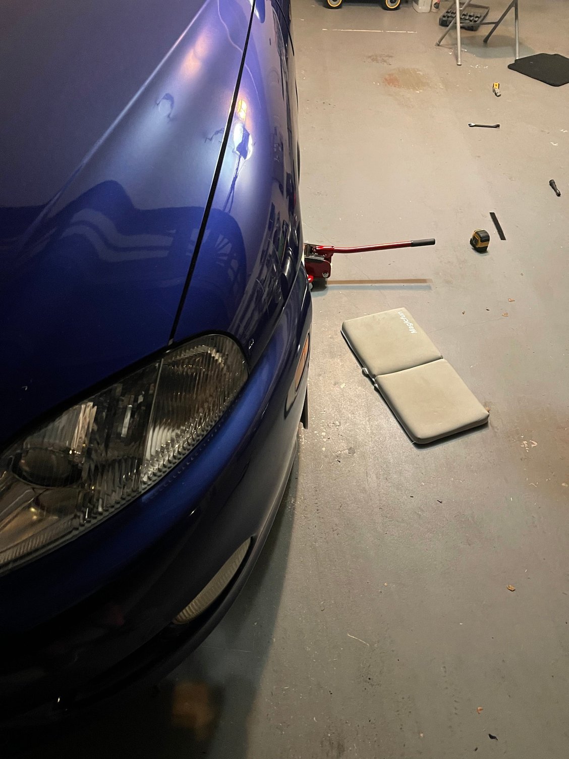

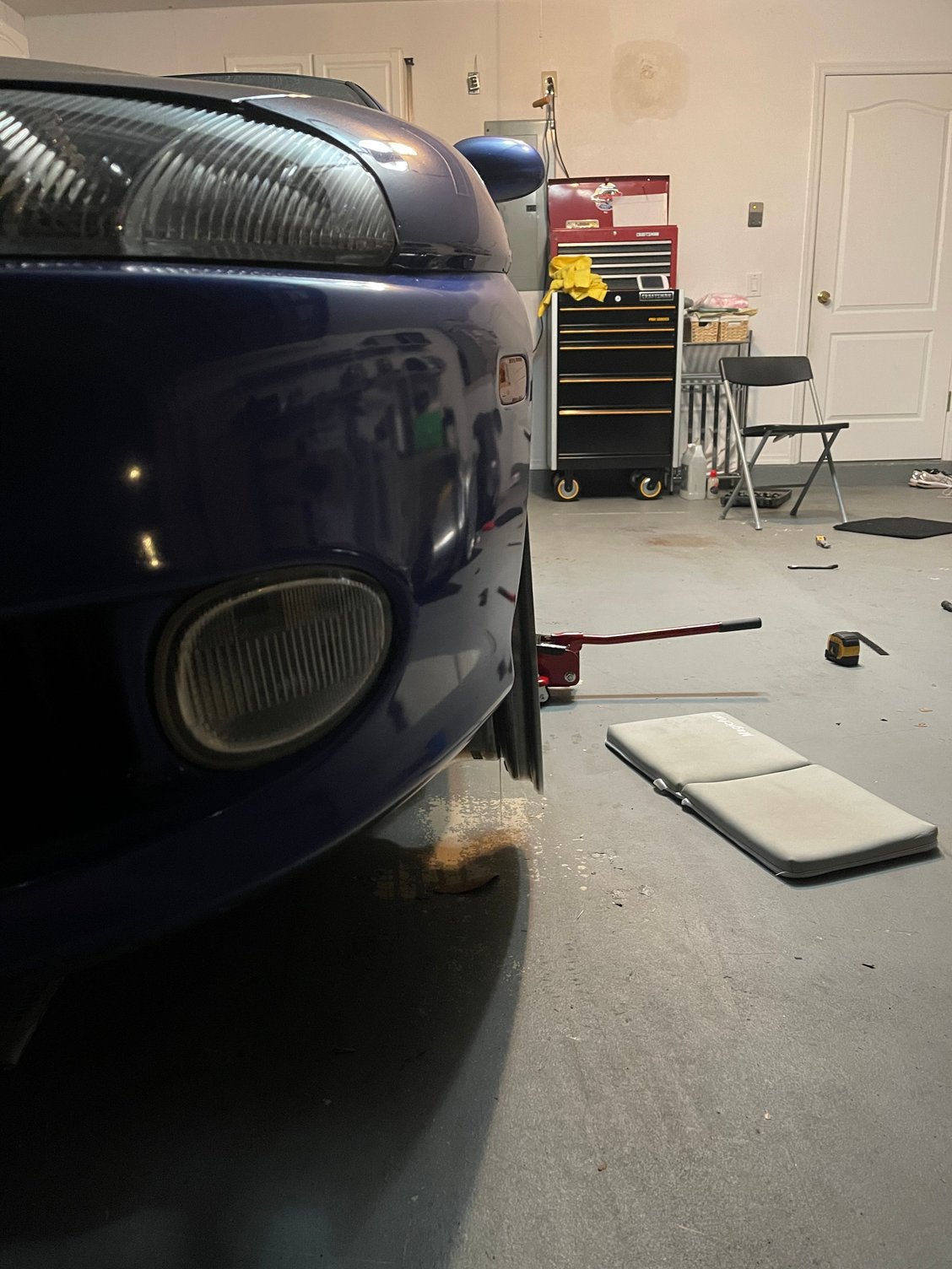

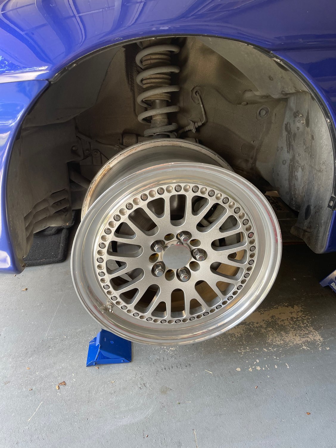

If I go to the 10” front, it will be 7.5” backspace and a final offset of +51. Here are a couple photos of the wheel in relation to the fender:
This is with the 7.5” backspace, but the same 1.5” lip.
The position of the lip won’t change whether I do 9.5” or 10” — this will be how far it sticks out
I did not compress the suspension, and this is all stock
What do you guys think?

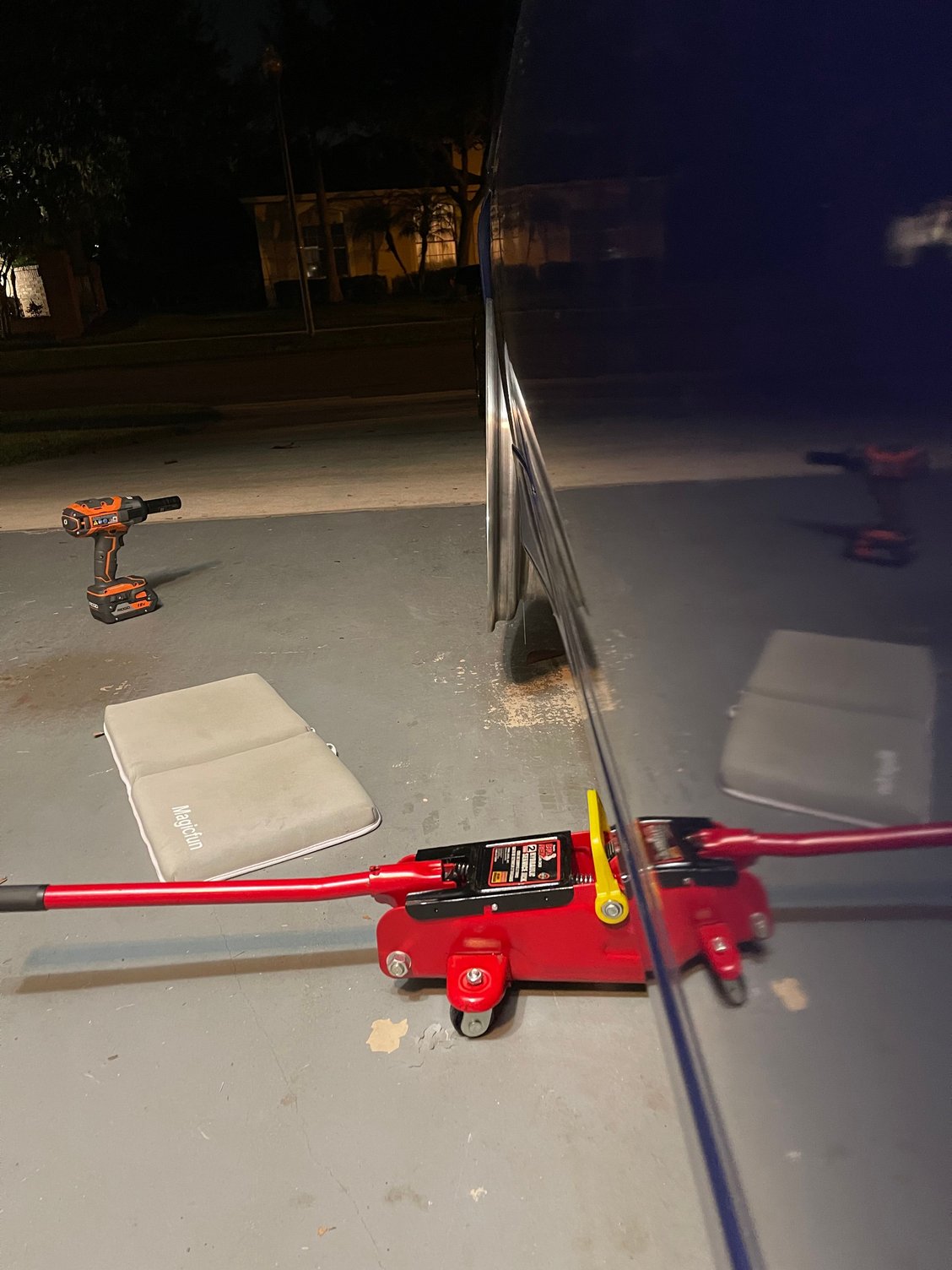

See attached. Admittedly the front pokes a bit more than I would like but the car really turns in well with the wider track. This is 235-40+11 front, 255-35+22 rear rear to give you an idea. 18x10" square.

Very aggressive fitment! I have seen your car in the fitment thread. I love your wheels. Like you said, they do poke a bit much, but still looks good. Thanks for posting.
