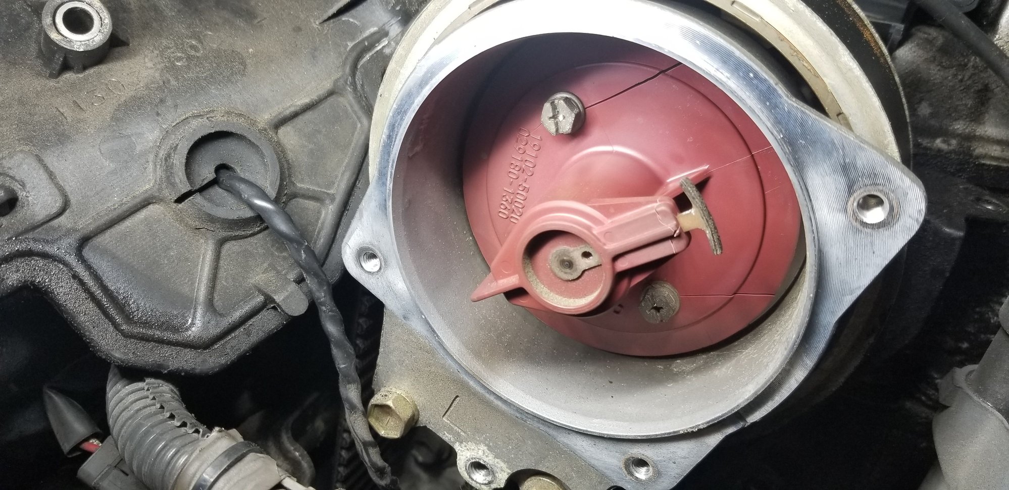

Thanks for all the input guys! I did pull out the ECU to check the capacitors and they look ok just doing a quick visual. I did spark tests and am getting it on all 8 cylinders. The driver side coil has been replaced previously but not the top one. I have to emphasize NO engine light.. and when I do try to pull, it doesnt even flash. I tried this on both the diagnostic box in the engine bay and the one in the cabin. The CEL comes on solid when on accessory as it should. Just to check, I unplugged the AFM and it came on right away...not sure why it's not responding to pulling the code.
Anyways, I also took apart the distributors and both of them basically look like below. I know that clearly the rotors and caps should be replaced but is it potentially able to cause such a severe issue as I am having? Can't even make it above 2k rpm...but only when under load(in gear...any gear).

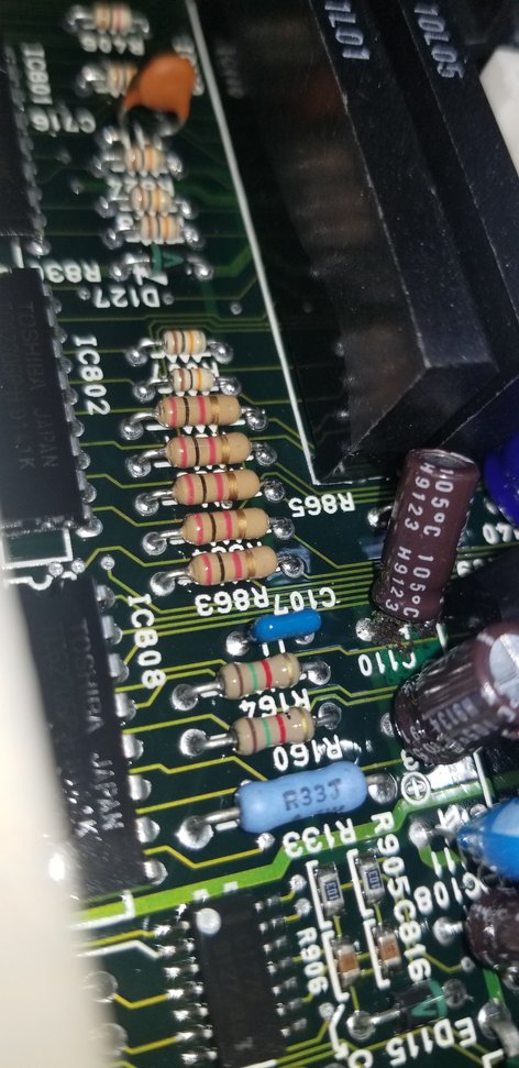

So i took the ECU out again and went over it more closely. Low and behold...at least 1 cap going bad. It feels like it is really loose and obviously the 2 pins are touching eachother with all the corrosion.
Does anybody have any experience with what capacitors can cause which issues? I am going to order the replacements either way, but i am hoping this is the root of it all...
