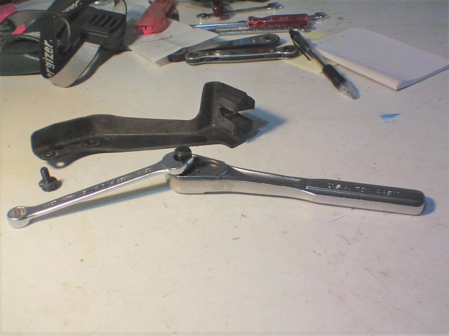

Remove the two 12 mm bolts holding down the cable support bracket. Note the leverage extender in the following picture
Remove the cable support bracket.

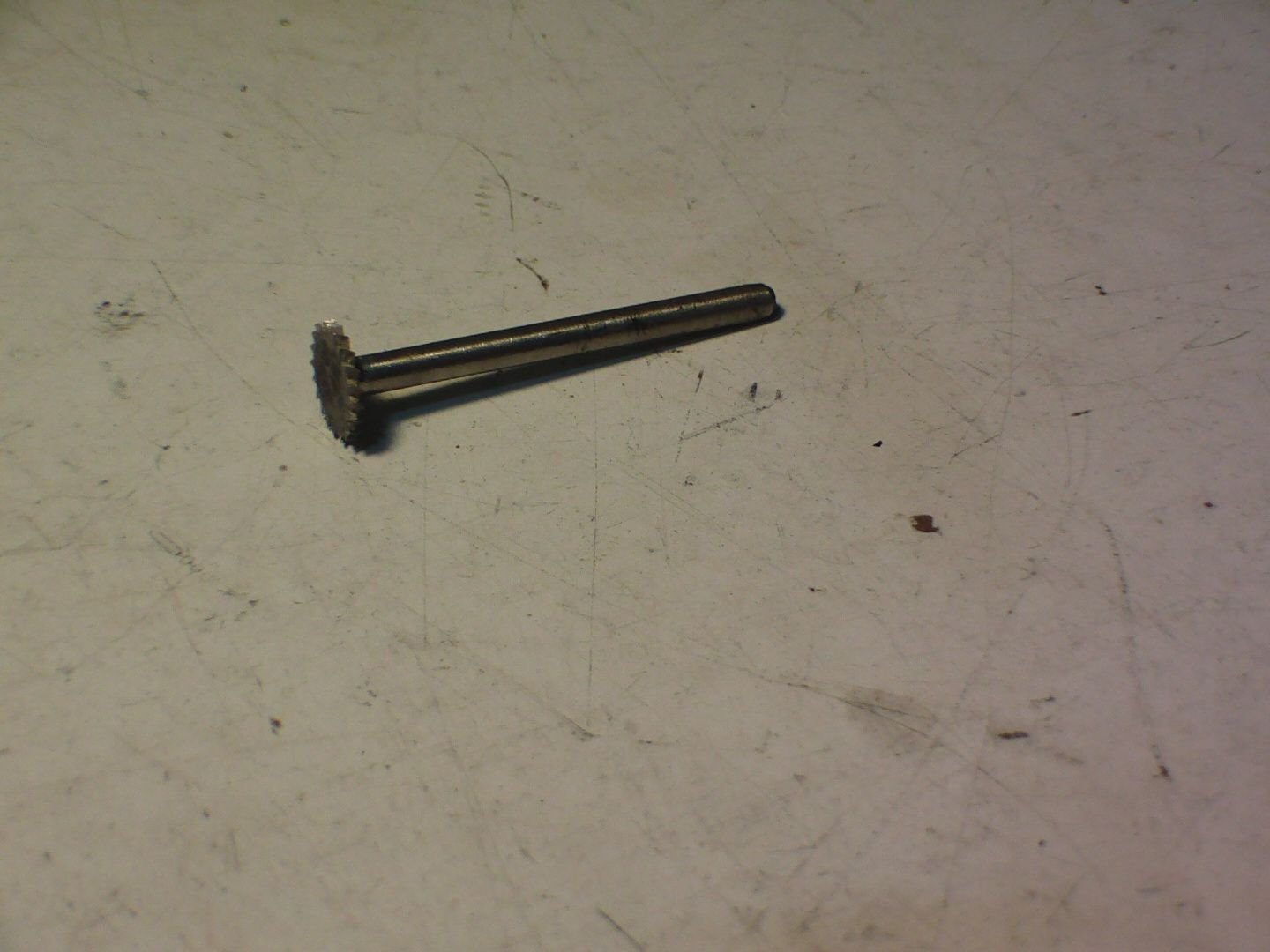

Use a Dremel cutter like the following to open the white case.
The previous repair video completes the middle of this job.
