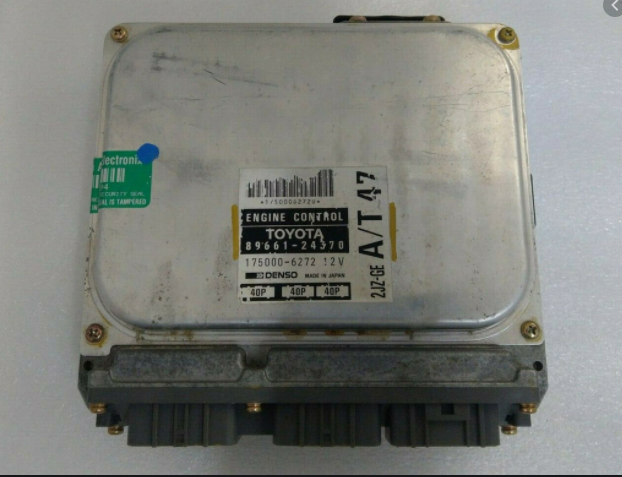

I'm assuming they are interchanging the terms.
This is a SC300 ECU. (Image from Tanin). It's located under the passenger floorboard behind a black panel.
IACVs are not calibrated.
TPS is calibrated. Maybe they meant that?
Also to note- if they just replaced this with some junk yard part, there's a small chance the capacitors are toast since this is a common ageing issue with these ECUs. That could be causing these issues as well.
There are 2 places that repair SC300 ECUs - Sia and Tanin.
BTW - Tanin no longer has the service on their website but they will do the repair if you contact them beforehand.
