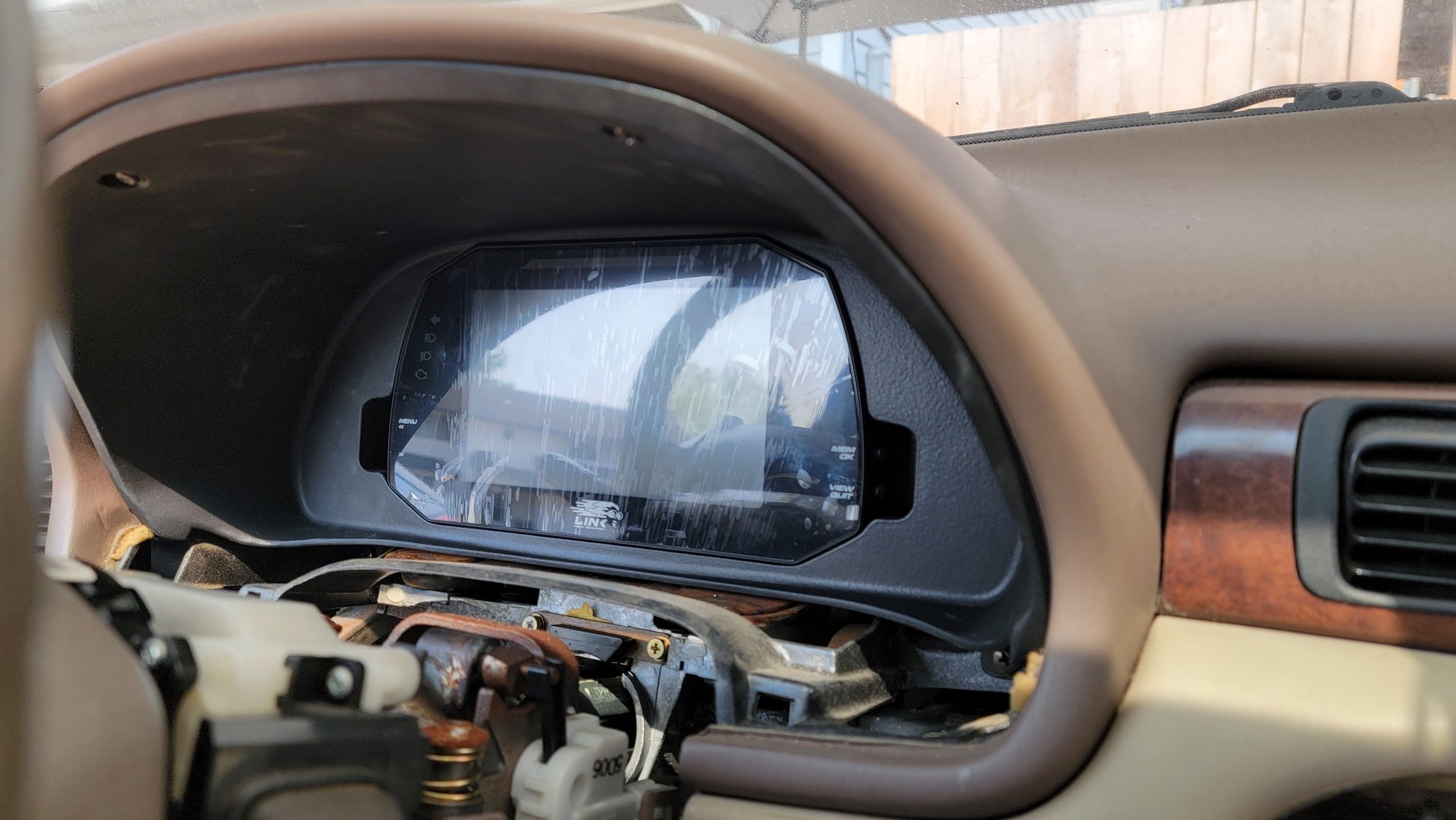

Removed the steering wheel today and got the dash out, and test fit then bolted in the molded dash and test fit it with the link MXG. OH BOY!! I'm lovin it!

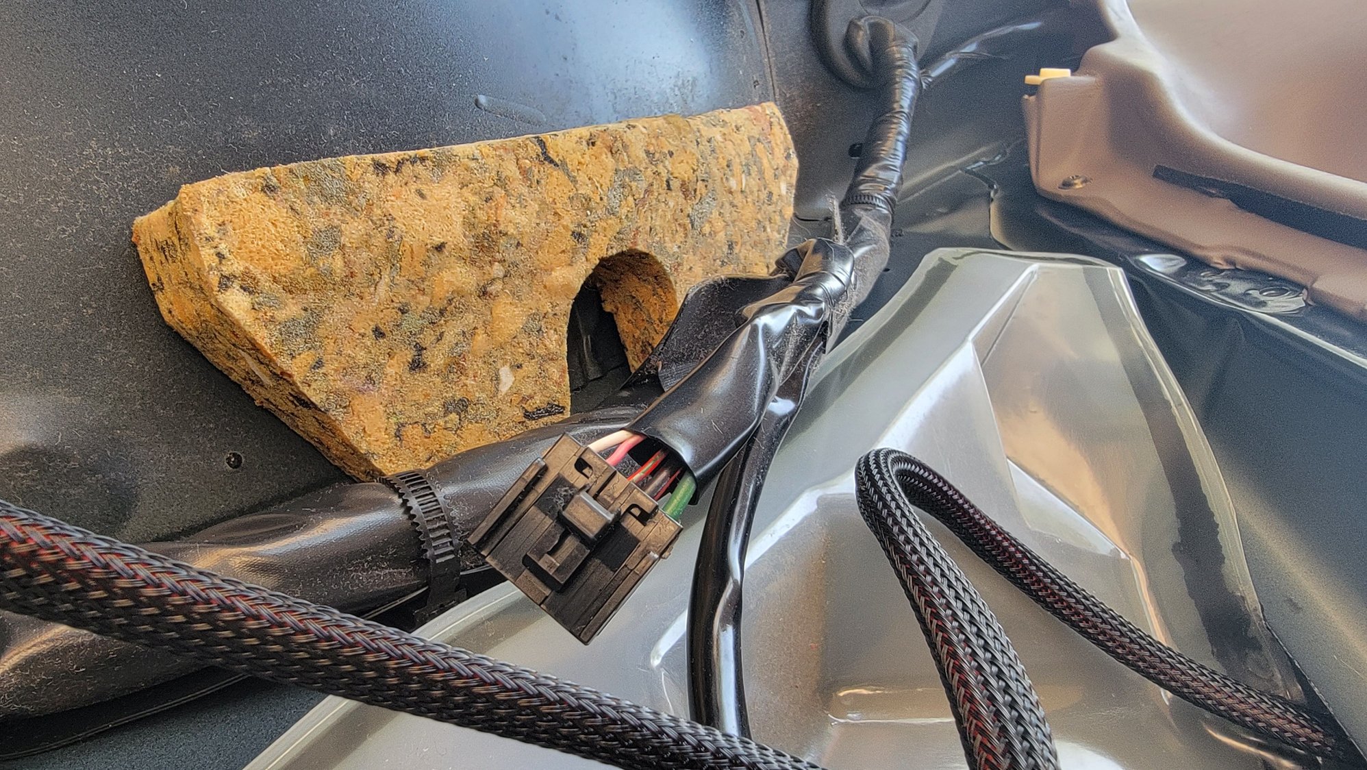

I also removed the rear seats, and started installing the fuel pump relay wiring. I started out by removing the drivers front wheel, along with all of the fender liner. I unbolted the harness plug on the firewall, and then ran the power wire w/ inline fuse through the inside of the car through the grommet hole. Once it was through, I cut a little slit in the grommet, pushed the eyelet through the grommet and got the inline fuse fed through and tightened it back up on the firewall. This allowed me to run it directly up into the engine bay next to the clutch master, alongside the topside of the fender and to the positive battery terminal. Then I back-tracked and tucked the wire under the carpet into the back, under a structural bracket and I mounted the relay to the side of the old fuel pump ecu. Then I ran 14 gauge for a trigger wire through the dash to the passenger floorboard, and around to the driver side carpet alongside the power wire back to the relay. I haven't soldered these in yet because I wasn't 100% sure which wire runs to the fuel pump but after consulting the manual it looks like the FP line is the green wire, whereas the black-red is the stock +B which I wont be running. Also blew me away how small the rear area is, I can't hardly get into the backseat with the seats unable to slide forward. I decided to wait on the fuel pump while I ordered some viton heat shrink.

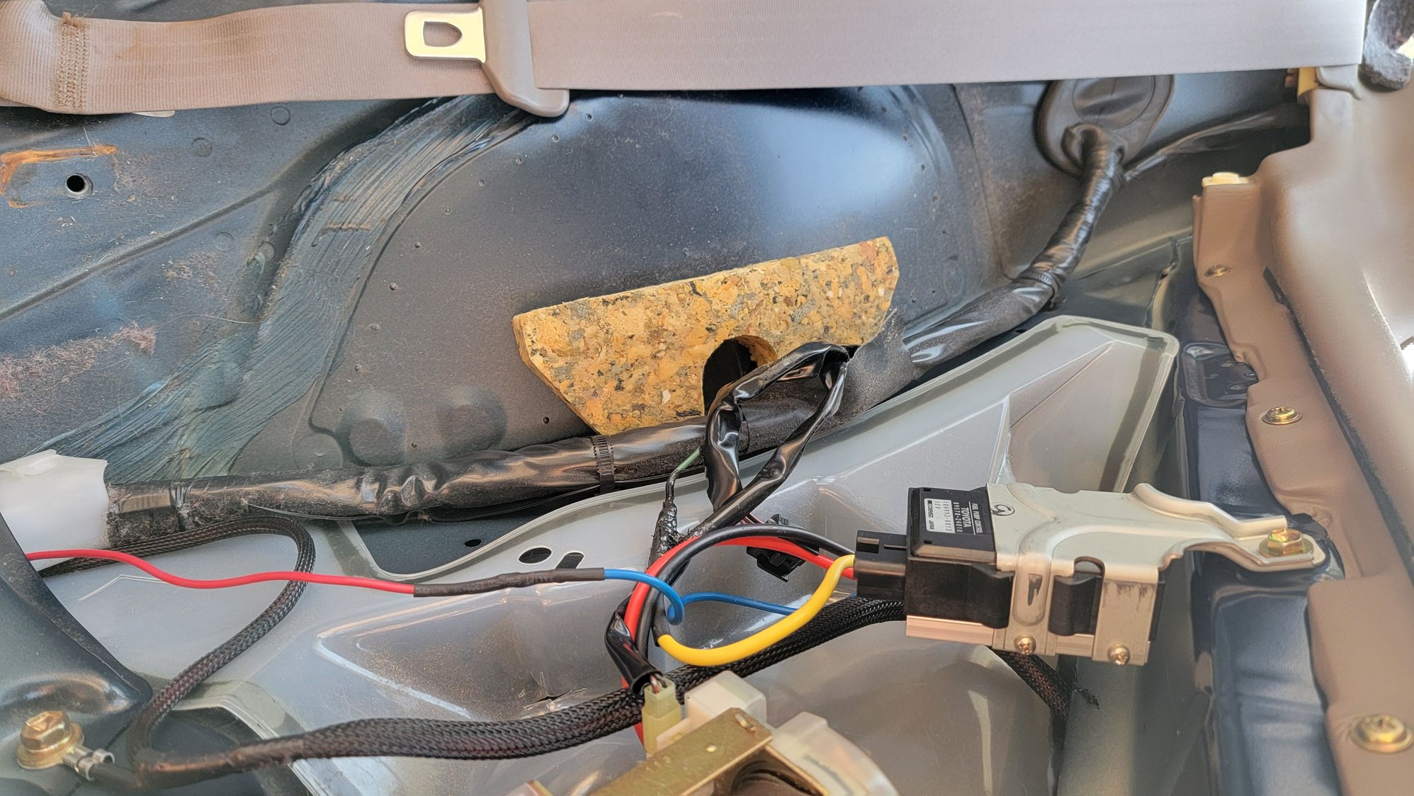

For the wiring, the sheathed wire goes under the carpet, through the fender grommet which I sealed with some silicone and attaches to the positive cable. The red wire is my fuel pump trigger wire running from the passenger floor through the dash, through the drivers carpet and finally the green wire is the stock fuel pump wire. This will be re-done once I get a fuel pump hanger and go twin pump with custom lines for full E85, but maybe next year. For now this will be fine on the single walbro 485. My heat shrink was a tad small, so I used some liquid electrical tape to seal it up and this is all stuffed up where the stock fuel pump ecu is, which is still there but unplugged.

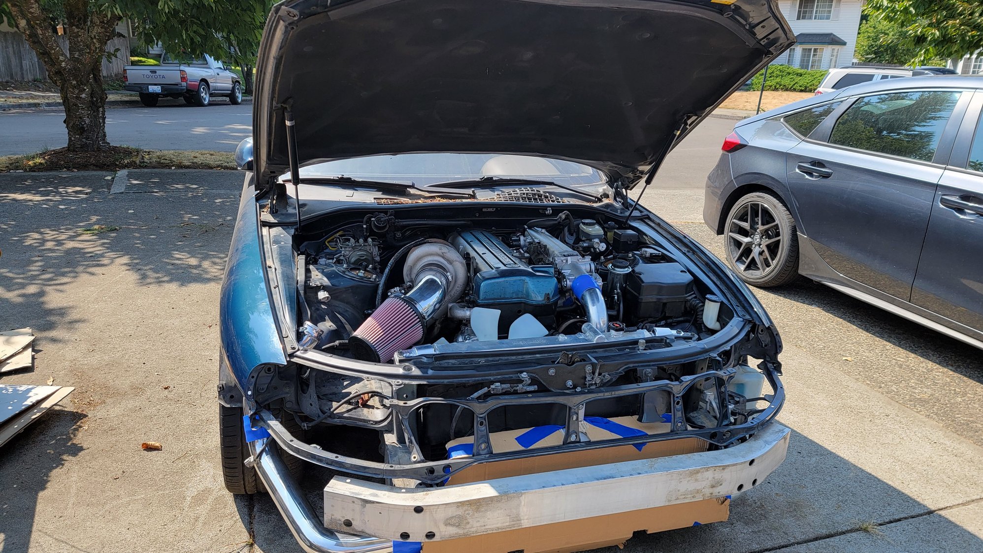

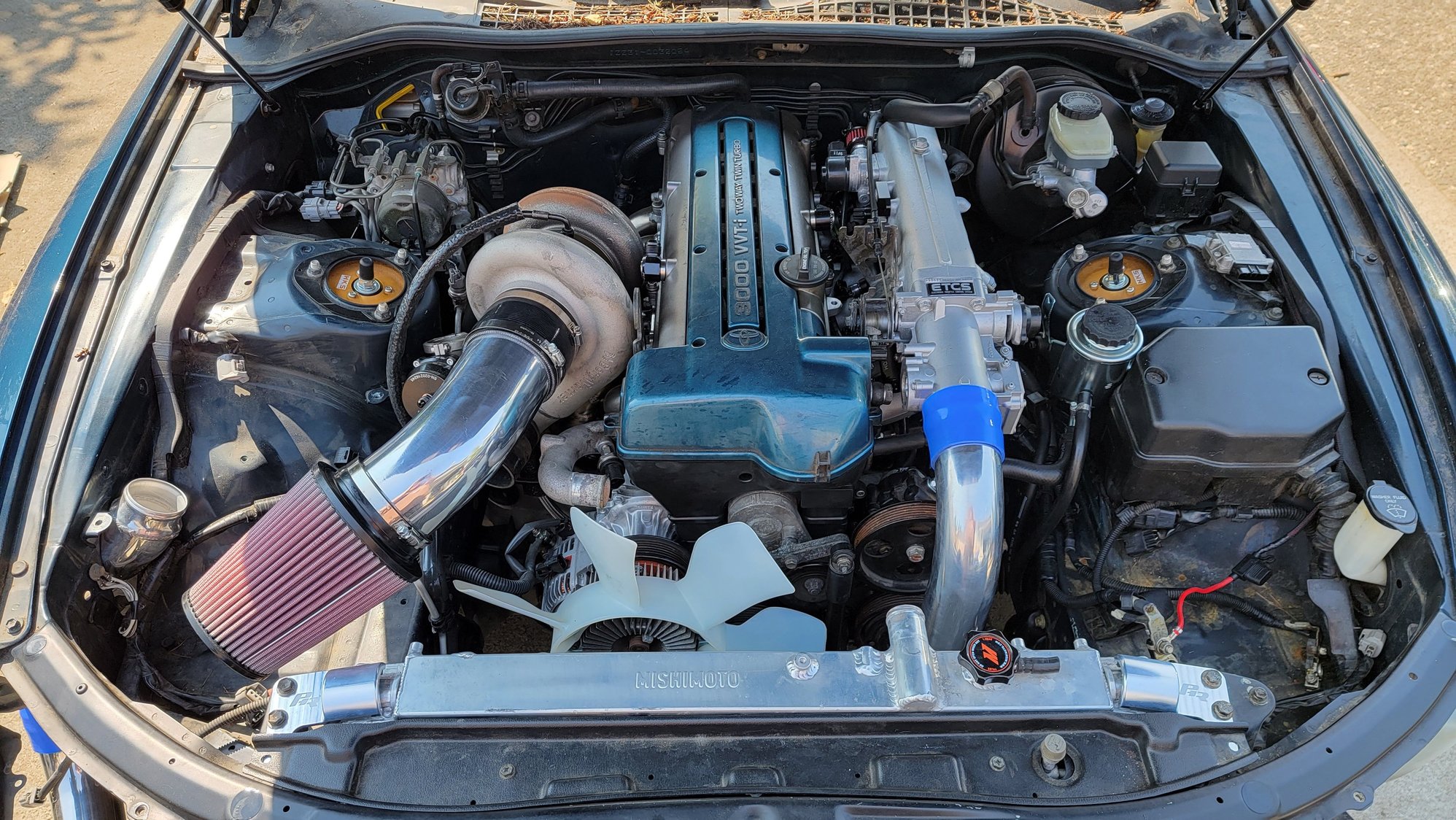

Despite the heat, despite my ailments I've pretty much spent a portion of every day the past three weeks wrenching on this car to make my timeline. Today is one day before it gets picked up and sent to the welder and I'm relaxing! I did set the old radiator in, along with clutch fan and intake so my welder can see my spacing requirements. Decided to take a couple photos. These PHR radiator mounts don't fit very well with this mishimoto radiator. Hopefully it fits better with the Koyo.

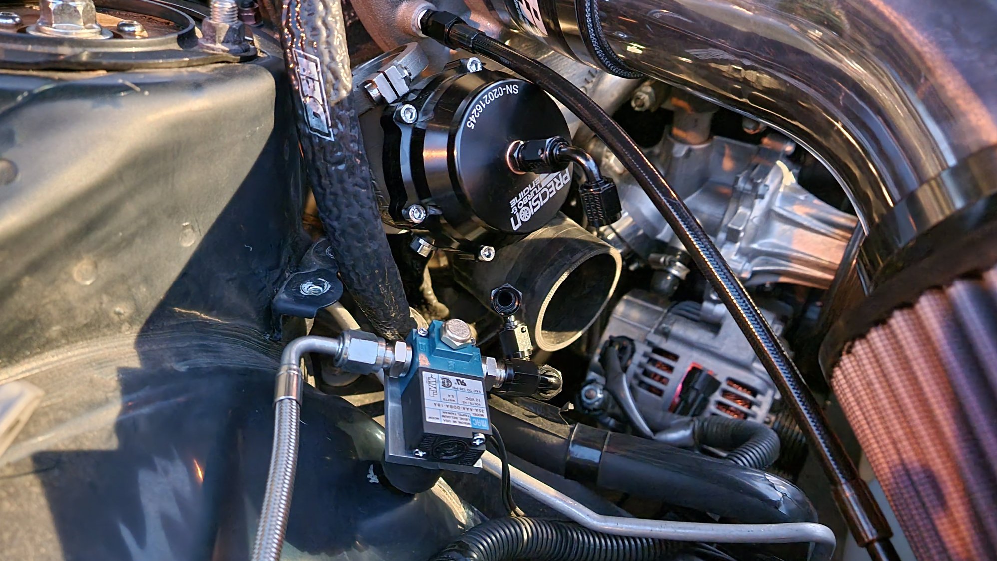

Played around with wastegate lines again, since I turned the wastegates from my original orientation and mockup, I've changed the setup 5-6 times trying to figure out how I can use the lines I bought to orientate them decently, while giving my welder room to make an intercooler pipe. I figure its' important to have this layed out so he can give me a little space for downpipe placement as well.
So while I can get it all together with what I have, I wasn't completely happy with the line going to the top of my front wastegate. So these last two photos show the T fitting I need to connect to to finish it off.

Thanks Rudy! This snail is almost TOO BIG. I almost wonder if a ball bearing Garrett would allow me to fit the strut bar!
Maybe some day I can have a manifold built specifically for my needs on this car but that's for another day. Really getting very close to first start!! I can't wait to drive this thing. Took another side shot of the wastegate lines in the front before it got picked up by the flatbed and delivered to the welder today. I may have to make a custom line here as the black fragola PTFE doesn't come in the fittings I would need or as short in a pre-made. I'll ponder for a bit and see what I can come up with.

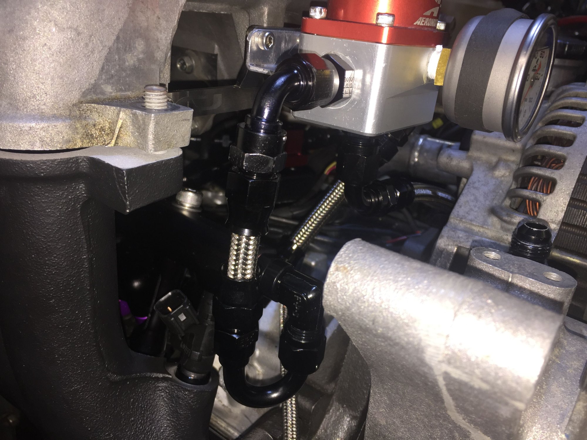

I used Fragola on my FD, very happy with it. PTFE is a pain to work with, but it’s a lifetime product. What fitting do you need? What are you trying to connect? Sometimes you can use existing fittings to create something that doesn’t exist. Look how I do my FPR:
If I remember correctly, I did a 90 ORB, into a 180 with a PTFE line about two inches long, into a standard 90. So, I made what I needed with less conventional fittings or methods.

I ended up ordering a 6" straight premade and two -4 male to male unions so I can connect the 90s i currently have to them. I'm going from a T; which goes from the side of the electronic MAC valve and the two top ports of the wastegates. My problem is I mocked everything up with the wastegates reversed (facing down vs up).
