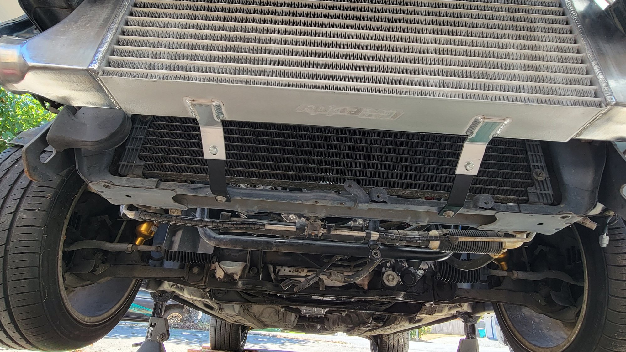

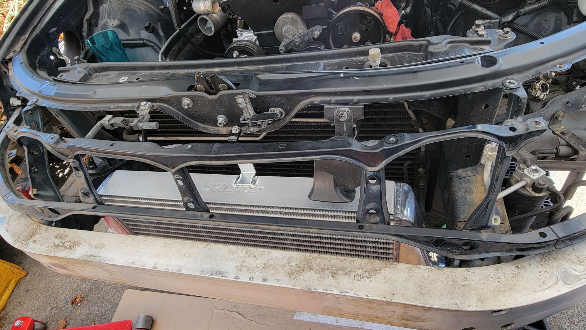

Greddy Intercooler install + piping

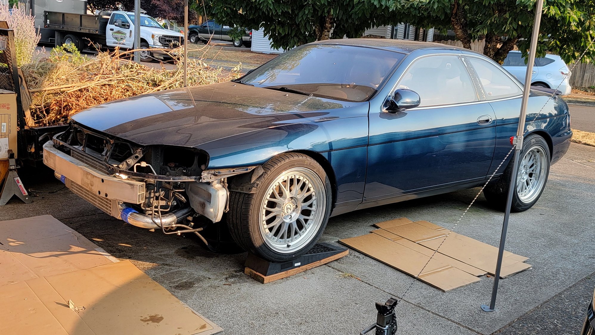

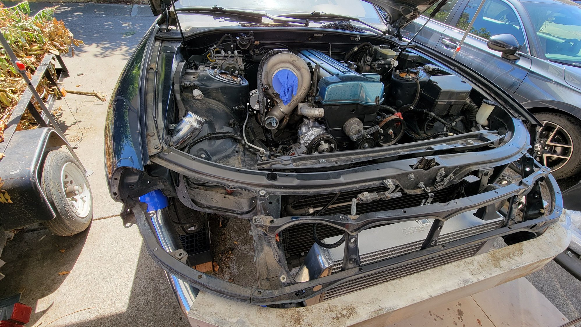

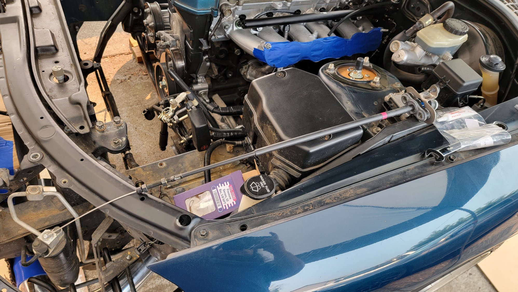

Put the front tires back on, as I plan on dropping the front of the car to have better access to the back of the motor from ontop. Next I started un-doing the power steering lines that go to the cooler, one end goes to the rack and the other to the top port of the reservoir and all of this gets removed.

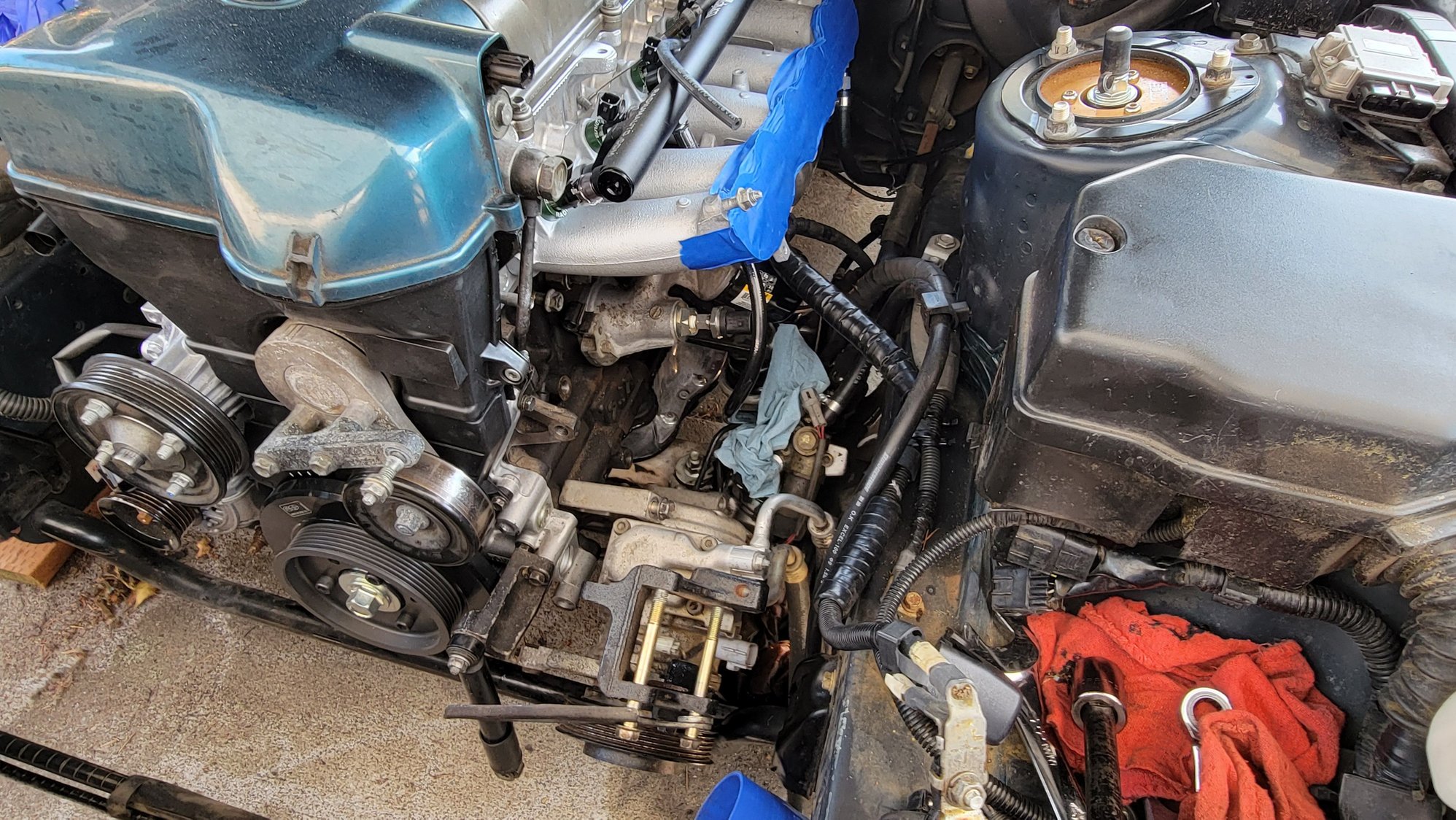

I ended up removing the P/S cooler all together, and cleaned it with brake kleaner and used an air hose to blast it out. This thing had some crud in it that started to ooze out when the sun was on it, so i figured it was a good idea to make sure this was clean. Next I installed the intercooler itself, all of the instructions are in japanese and it seems to come with a bunch of hardware to replace the OEM stuff. I initially had the lower brackets backward, then corrected that; and then I un-did the wrong A/C lines. I kind of can't really tell 100% how the instructions want the A/C lines to go because it feels like the SC300 is different than the soarer which the kit is designed for; so the front A/C line I removed the bracket and bent the lines down and forward, and the rear line I used the bracket that came with the kit to move it down and backward. This allowed the pipe to fit between.

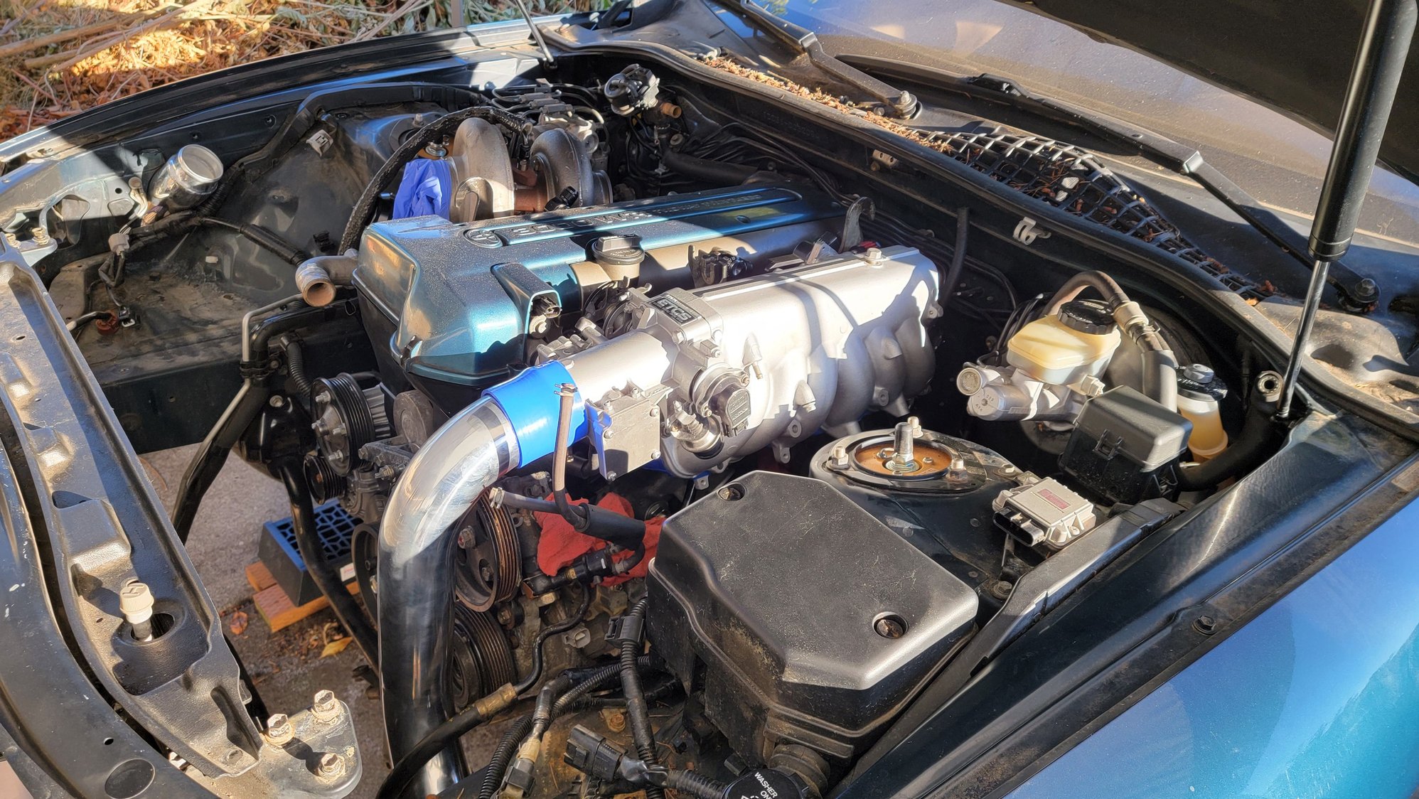

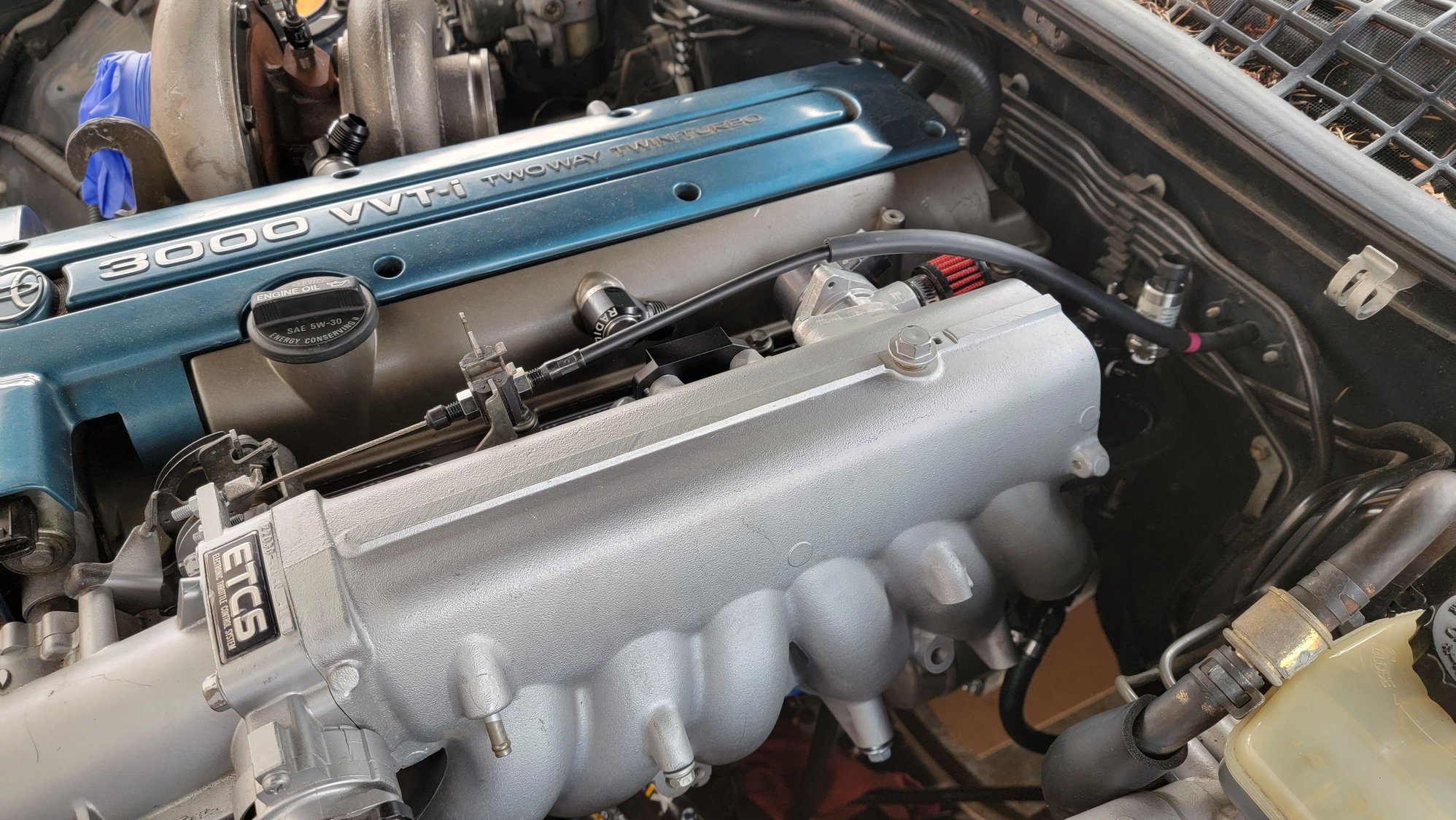

Ended up test fitting the intake manifold on; so I could see how the cold side intercooler piping fits. Turned out pretty well. I really dislike the power steering hose coming off the bottom of the pump, that might be getting deleted here soon! Haha. The hot side piping isn't the best for my setup, you can see it was designed for the stock twin turbo piping, but considering that is the only pipe my welder will need to modify makes it relatively easy.
Tomorrow I'll probably drop the car on its wheels, I need to do this to tighten the return fuel line on the back of the fuel regulator, seal the 90° 1/8" NPT fitting, install the fuel pressure sensor, start installing the heater hoses and maybe the throttle cable. Once that stuff is done the following day I can lift the car back up in the air and work on the exhaust over the following two days. My plan is to have that done by monday night; and tuesday morning my parts from Toyota should be in, and this would allow me to finish my P/S system.

I started off by putting the battery tray and battery in the car to test fitment with the intercooler piping. Everything's good but the reason I did this was to figure out where my BOV was going to be mounted for my welder. I decided that there was really only two locations I liked, one is in the throttle body where the TRAC unit used to be; but this would require the throttle body to be removed, then the track housing would need to be cut off and throttle body hole saw'd to weld the blow off valve there. This seems like more work, and also would just clutter the engine bay more; so I decided it fit perfectly on this lower pipe in the bumper.

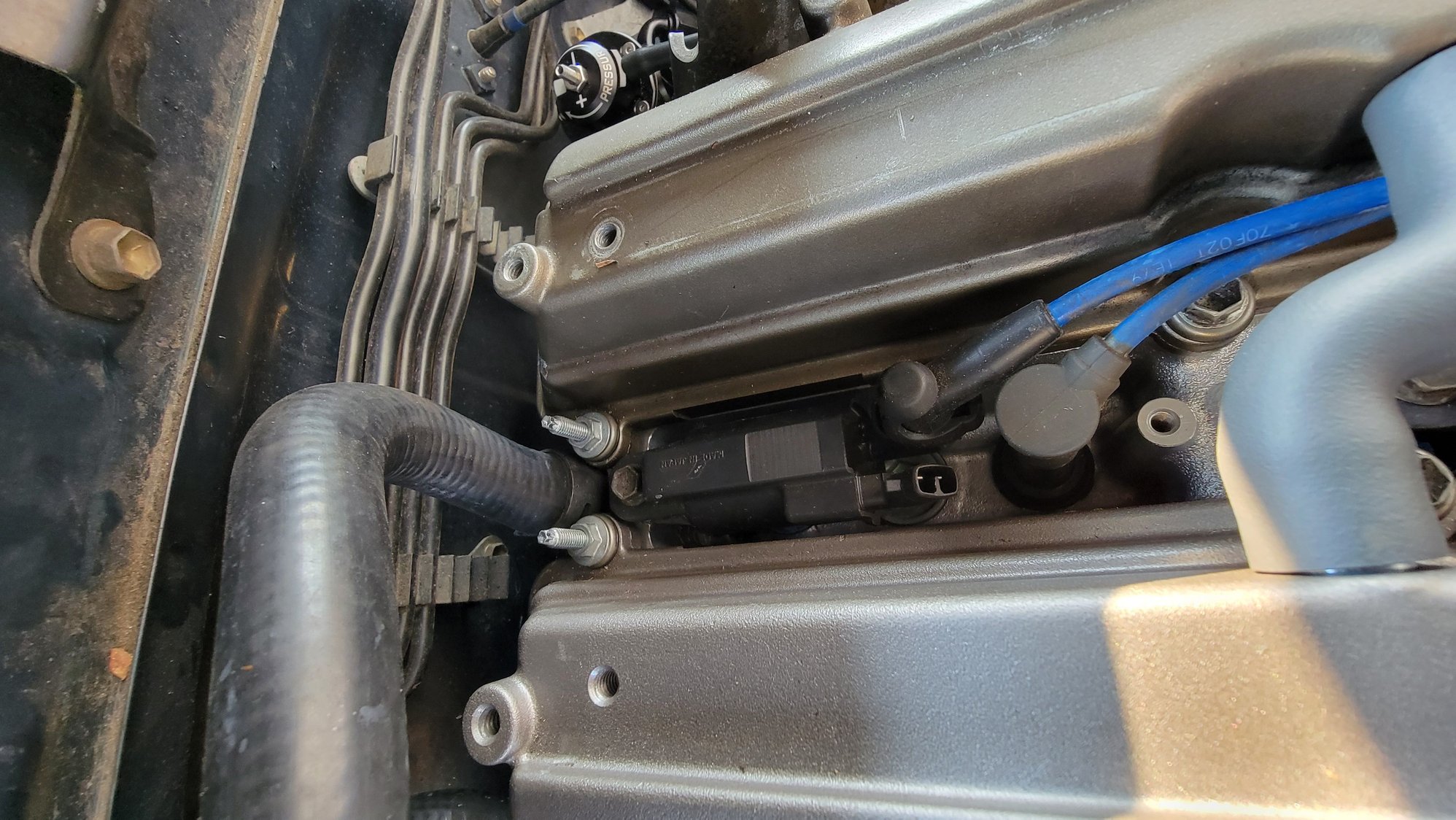

Got the car off jacks and busted the high pressure p/s hose off the pump, then I removed the pump and took the A/C pump off the block so I could take the lower high pressure hose off the rack off. Just need my driftmotion hose to come in and I can put it back together.
I ended up getting the heater hoses on with OEM clamps, I think it came out pretty good. Had to lay ontop of the motor to get the hose and clamp on the back of the head, I will need a new set of long angled needle nose pliers if I ever want to remove it.

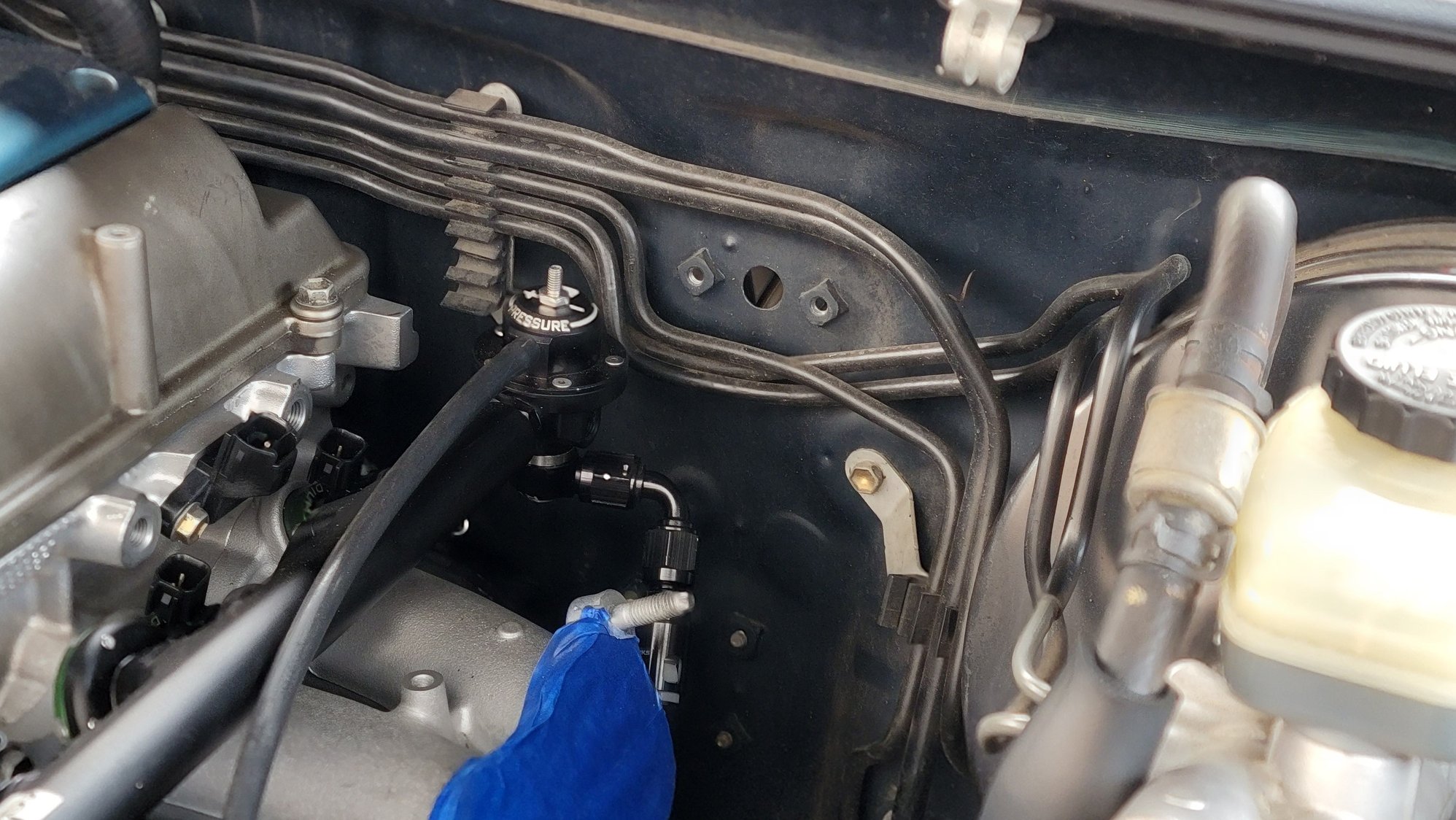

Forgot to add on that I tightened the return fuel system yesterday too, and ended up re-routing my feed line on the inside of the motor mount rather than the outside to give me a little more flexibility and less strain on the hose as I tightened it up. So fuel lines are fully tightened, I just need to install the fuel pressure sensor today.

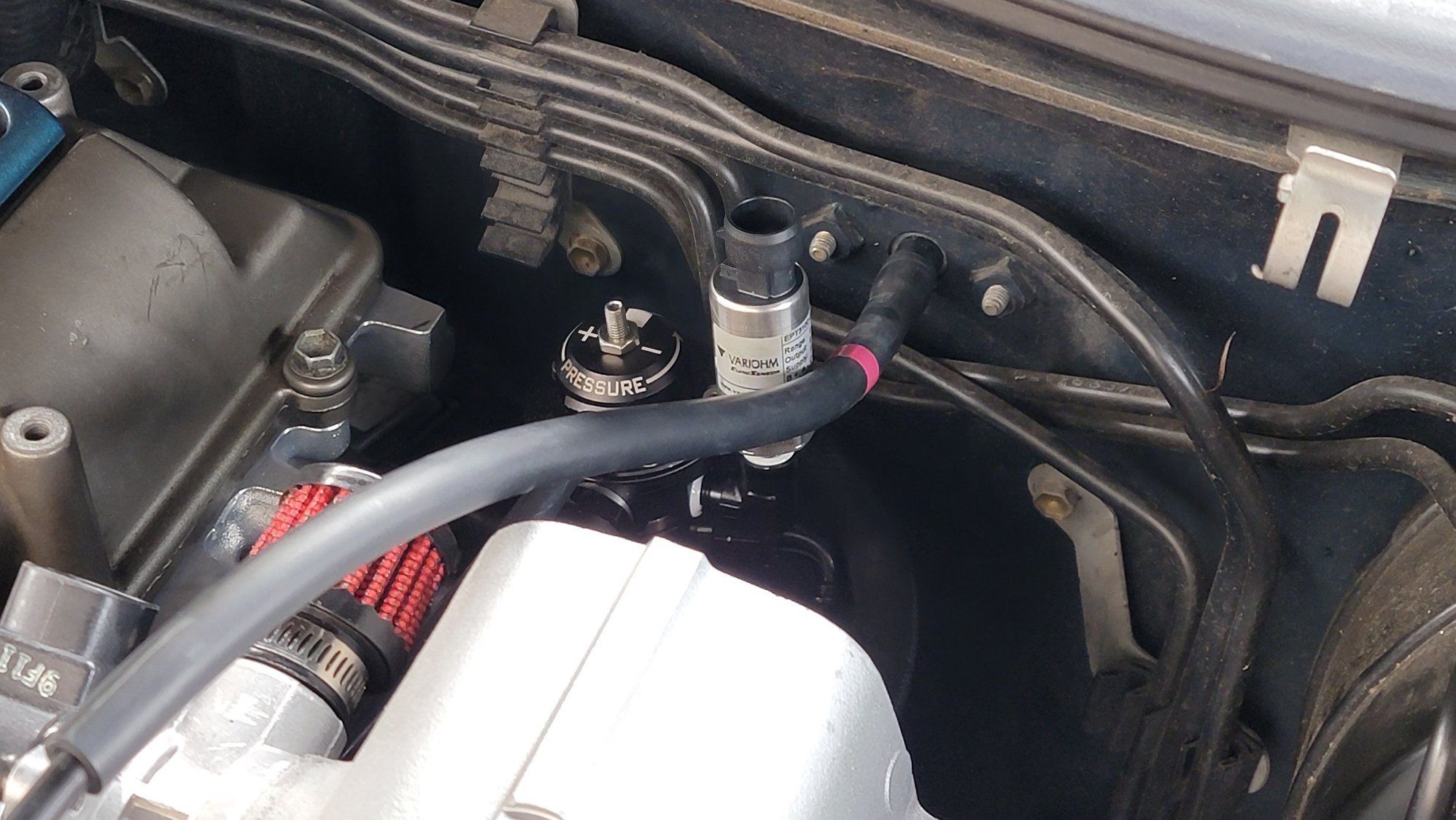

  • Install radium 90° 1/8 NPT + Link 150 PSI fuel pressure sensor with loctite 565

I also installed the radium 90 NPT fitting and the link fuel pressure sensor, just letting the loctite cure up now and praying its tight enough for no leaks, but I got it pretty snug. Then I threw on the intake manifold to test the throttle cable routing and things are looking GOOD!

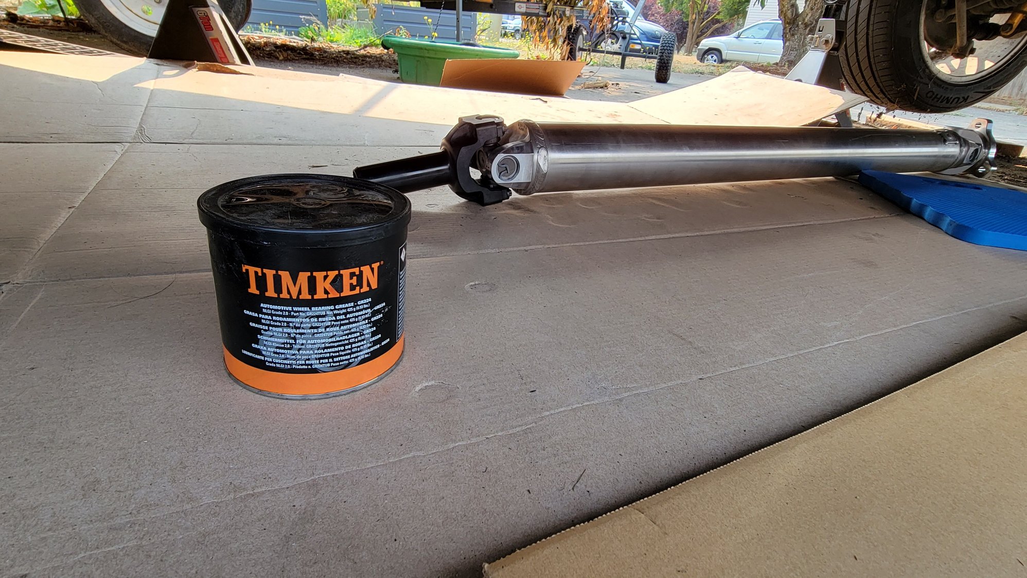

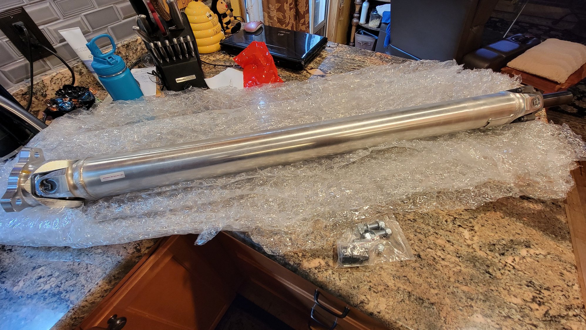

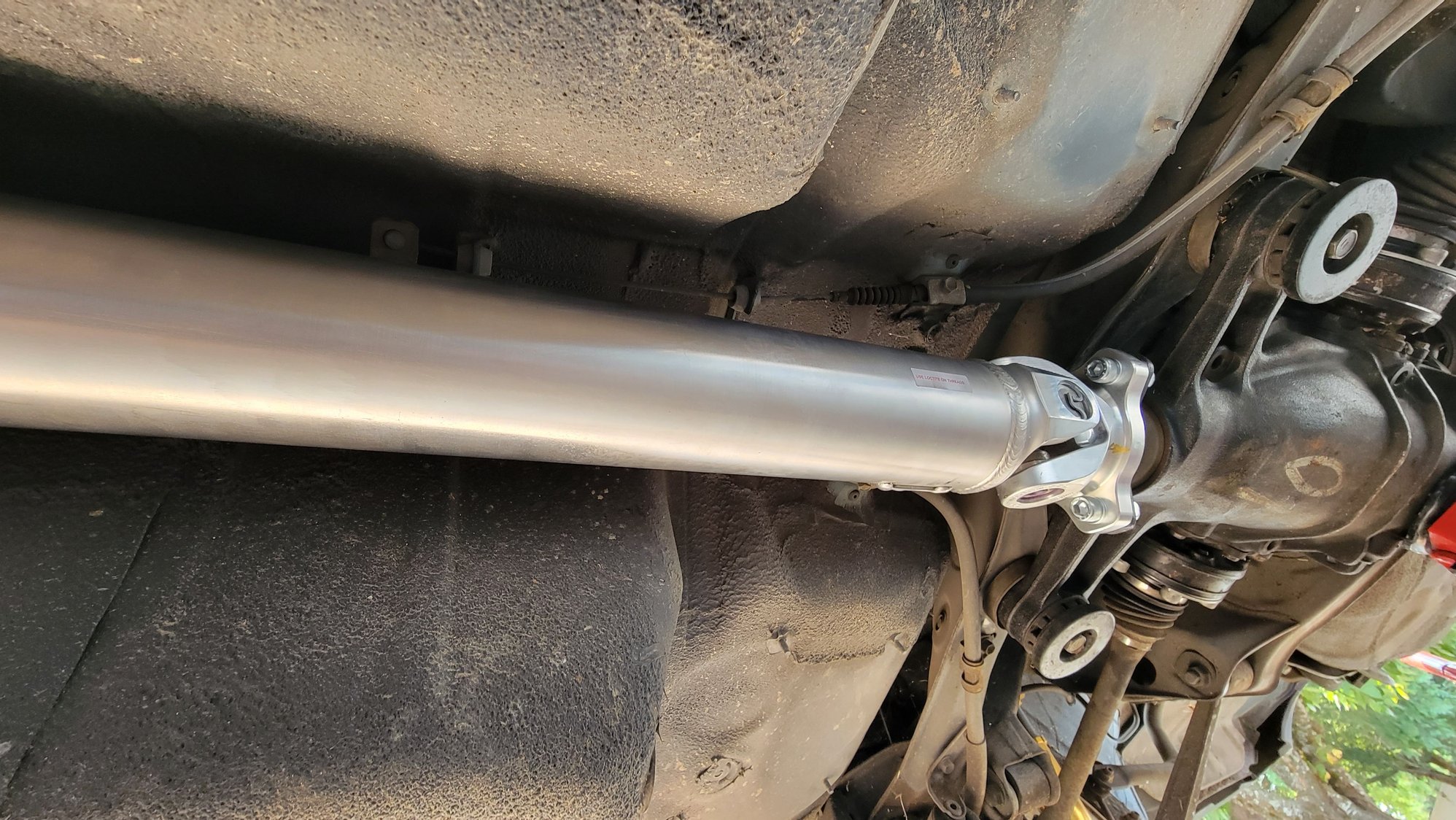

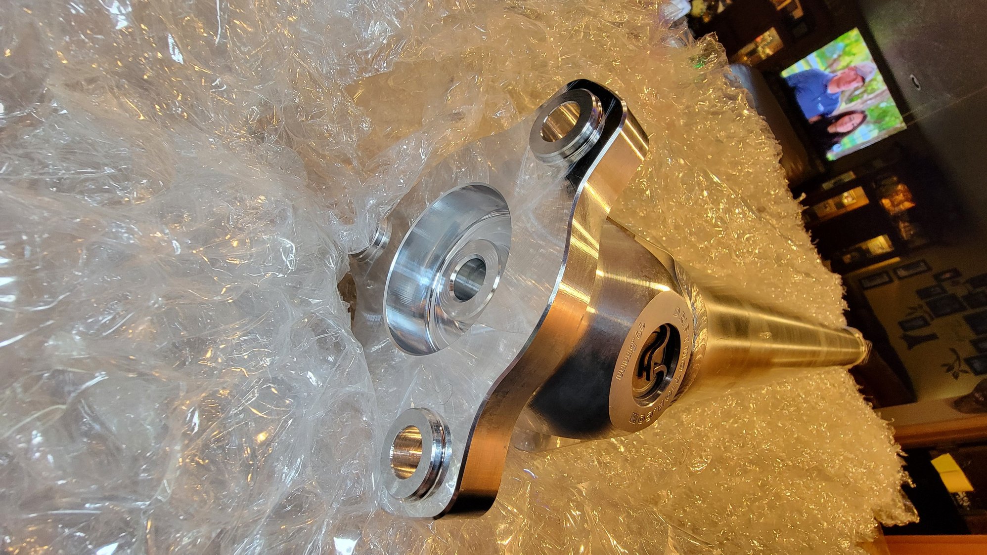

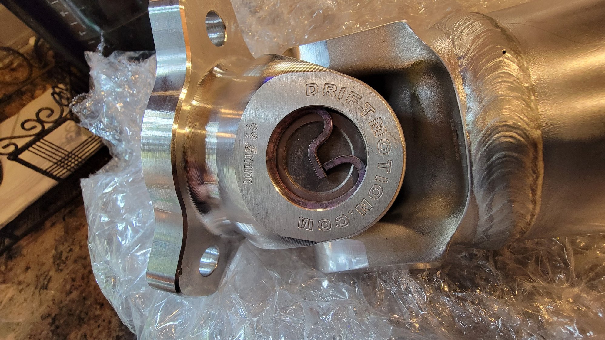

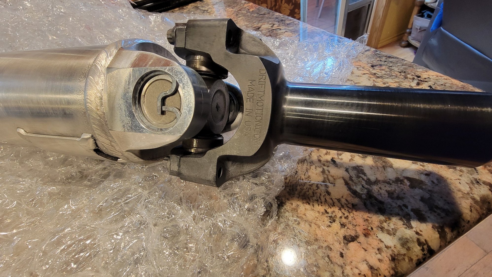

Driveshaft arrived! Man this thing looks BEEFY!
Super happy this is the one I went with, exactly what I wanted. Lets hope it bolts up now. After putting the pressure sensor and throttle cable in that's all I'm going to do for today. Tomorrow drive shaft will go in!

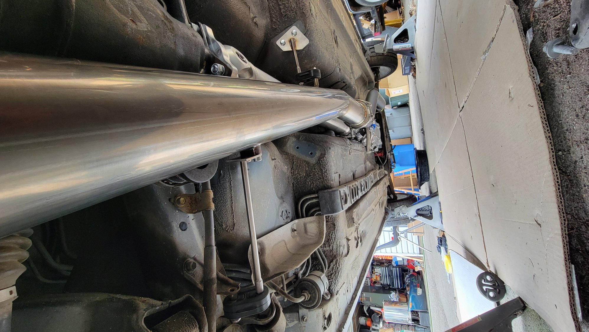

Got the car lifted back in the air, removed my old speed sensor and put the new one on. This is pretty dang hard to tighten with a wrench with the transmission mount; so I may need to use some pliers to help, but its as tight as two hands will get it right now.
Used a piece of wood to tap the transmission dust shield on. I ended up priming this and using some flat black, it should be good enough not to rust. After I used some red grease and put a thin layer on the front yolk, getting it to slide on was a bit tricky, this chromoly drift motion yolk has much tighter tolerance on the spline than the OEM does after 25 years; but once I got it lined up it slid right on. I ended up requesting a drive shaft 50-3/16"; but I feel it is 1/16" long to fit perfectly. With the driveshaft plunged all the way forward, I had a hard time getting the rear past the differential locator pin. I ended up using a hammer and tapping it on, which then allowed me to pull the driveshaft back out and fit onto the flange perfectly. I used blue loctite and torqued the rear bolts to 75 ft lbs although I didn't get any instructions on what to set this at.
Pretty happy that the driveshaft is in! My hands and arms are still pretty sore, and my massage appointment got cancelled so I'll just be taking it slow. I wanted to add transmission fluid and screw on the fiberglass transmission piece.

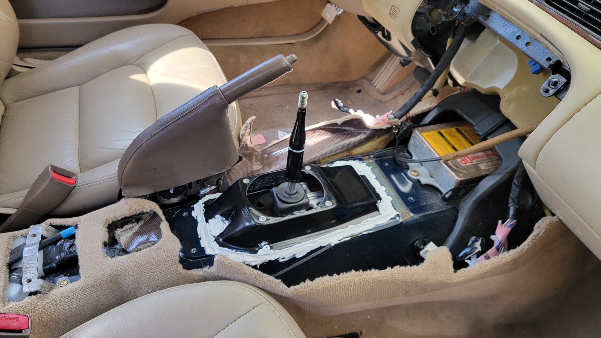

Haha. So for some reason I had it in my mind that I could fill the transmission up from the interior, like I have always done in the past for my R154's. Sadly because the size of my hole, I can't remove the front bolts at the moment and its an external shifter R154 so no shifter hole to fill through. I will have to remove the fill hole on the side of the transmission and pump 3.2 quarts in.

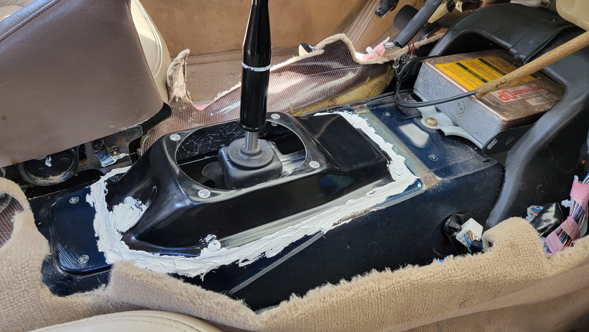

Decided to tighten the shifter up, then I test fit the fiberglass piece under the stock trim. It really fits well, so I pulled out the center console and screwed down the fiberglass panel. Lastly I finished it off by seam sealing it and spread it with my finger on a glove. Before you hate, yes I did seam seal the screws as well. Haha! I'm not too worried about that, but I didn't want any smell leaking through.

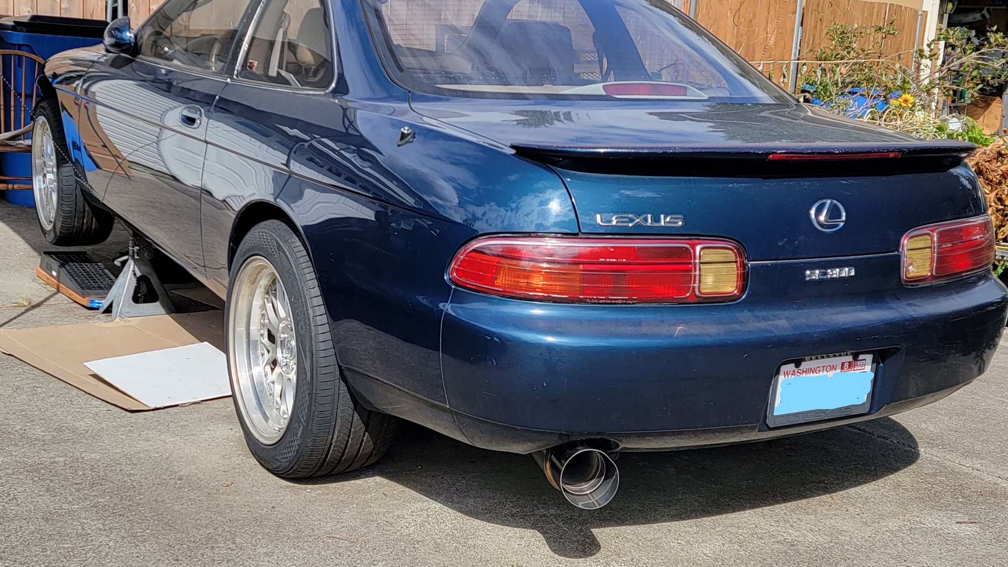

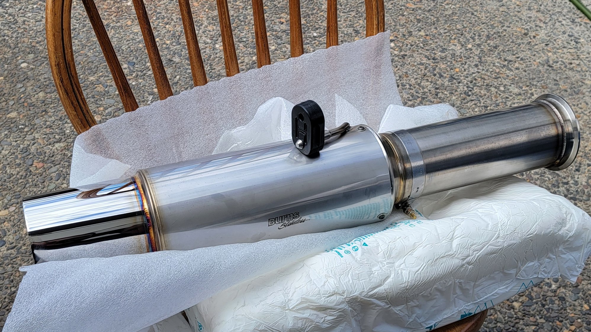

Then I put the transmission tunnel boot on, the chaser setup for the fiberglass piece. This turned out well not too much to say about it although I did order toyota bolts for this. After I started installing the exhaust, I tried mocking it up in three sections and I started out by installing the center section, once I figured out the orientation and where the exhaust hangers were at this went up pretty easily. Then I installed the muffler by removing the stock rear hanger bracket, installing the new PHR one and lifting the muffler onto the exhaust hanger. After that, hooking the v-band was easy. Because I didn't have a downpipe I used a box to hold up the midpipe, attached it to the v-band adapter and have it holding up to the transmission currently with weed eater line for the car to be transported.
Noticed the muffler has a little dent in the tip which makes the circular end stand out to me. I will have to try and tap this out possibly.

Man that big exhaust is brutal - I love it! You're making excellent progress Joe! After a good vacation I bet you'll come back more motivated than ever!
