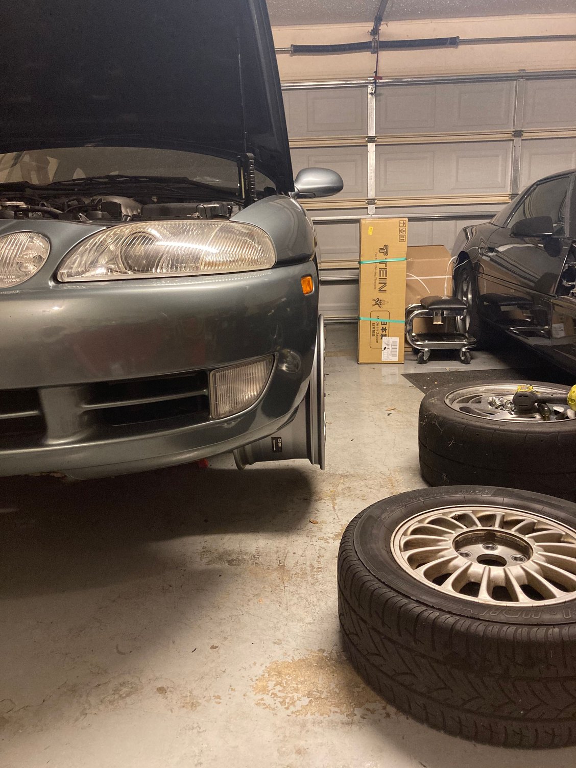

Hey CL world. New to Lexus but not to the world of project cars. Accidentally picked up a clean 1993 SC300 and working on a few things now. Everything I have researched says these wheels will fit both f/r and plan on running a 245/265 tire combo. Problem is they just look really close to the outside fender. I'll try and post some pics if that helps. Also plan on dropping it with Tein coilovers this weekend and don't mind running some negative camber.

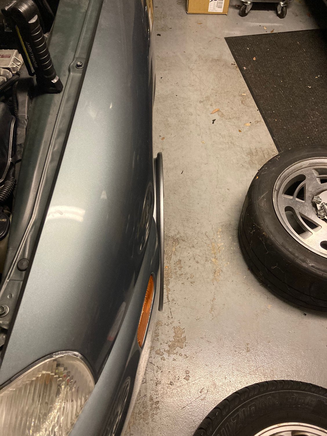

Thanks for the quick response. My concern was more over the clearance of the outside fender as it looks to be almost an inch off when I put a level on it. Will run 245/40-18 and 265/35-18. They had the same size rim in a 15mm offset but assumed that would stick out too far.

You'll have to roll the front fenders, but a 245/40 should fit no problem.

You should be OK, as others have said - may need to trim front fender liner or light roll depending on how low your suspension is set. It's always deceiving how much wheels stick out until the car is actually on the ground at ride height.

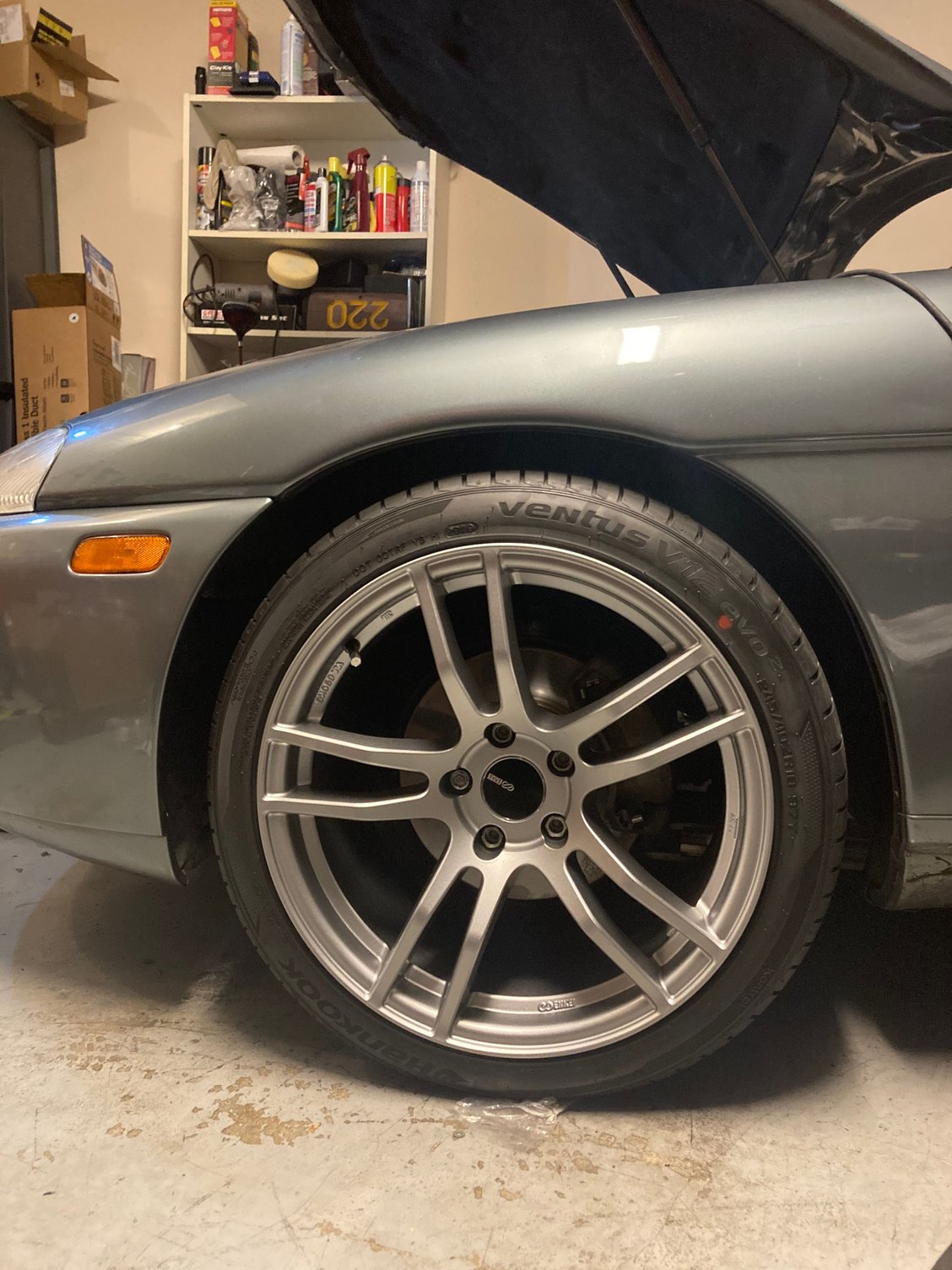

Fronts are one and Teins installed at default height. I may lower it a little more but I’m pretty happy with the current look. Adding some camber will help tuck them up under the fenders next thanks for all the feedback.

The new wheels look great!

Back needs to go up a little, maybe drop the front a tad more, then off to the alignment.
-1 camber front
-1.5 rear should tuck both under nicely.
