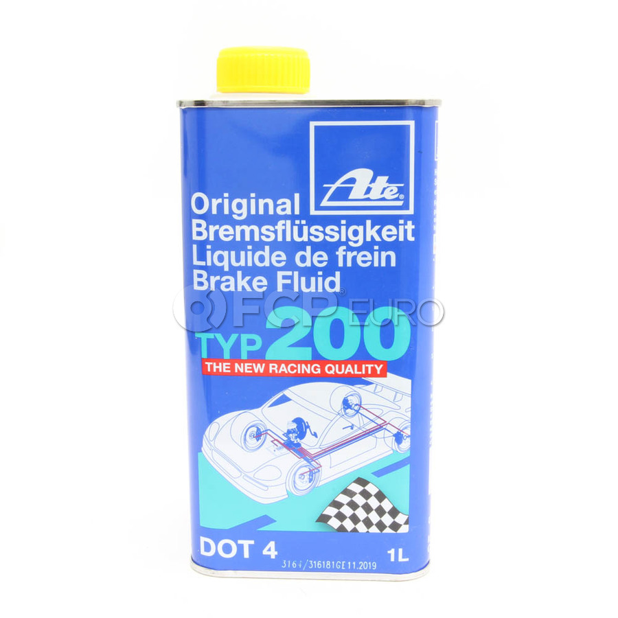

Originally Posted by RXRodger
I have been using this stuff for years in endurance racing (in the SC300) and it works good.
Same, I've been using ATE for 13 years with no issues. I wish it was still sold it in blue though. Made brake flushes so much easier.
