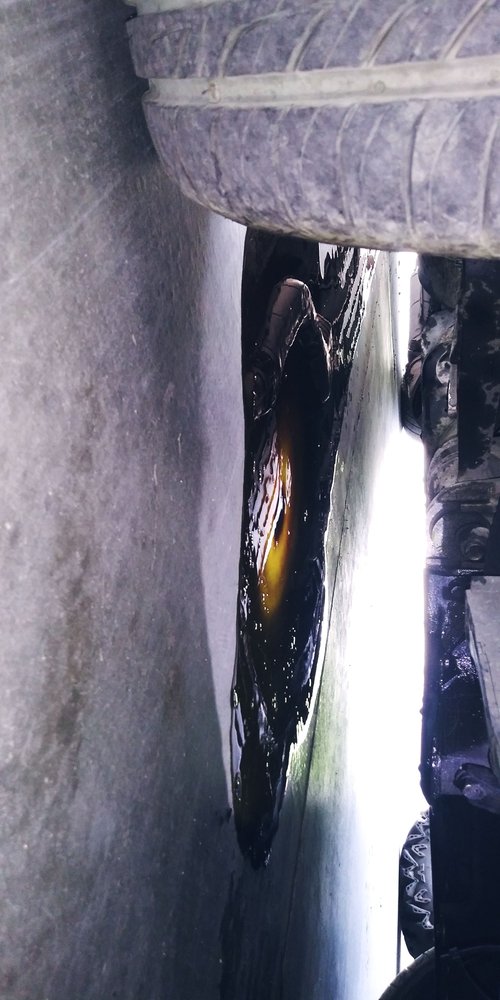

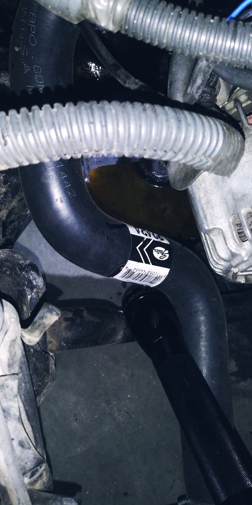

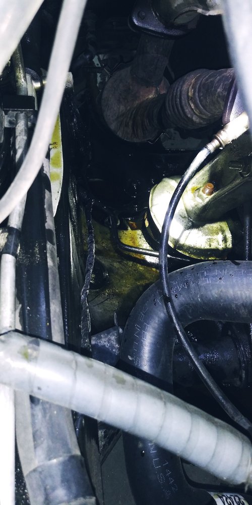

Default mobile 1
These are from moving it 25 feet today.
Mobile 1 filter

Just to note, that PCV does not look like the correct stock PCV, it looks like just a generic elbow with nothing inside of it.
You may want to start with the correct part (the stock PCV is purple), just having an elbow on there is going to suck oil out of the motor and into the intake.
The PCV limits the amount of intake vacuum that can be applied to the crank case (to remove vapors and not suck up bunches of oil), so you either have to keep a real actually working PCV when connected to the intake, or you need to vent the valve cover to air (on custom setups do not do this on your stock engine)... but connecting the valve cover to the intake without a PCV is 100% wrong.
Mrmj2u above was correct, you need to verify that your pcv is working and not stuck open, but I can clearly see that is not even a PCV valve it is simply an open elbow, which is actually worse than a stuck open PCV valve.
If for some reason its not that thing that kind of looks like a PCV but really isn't, then I would start checking other stuff.
