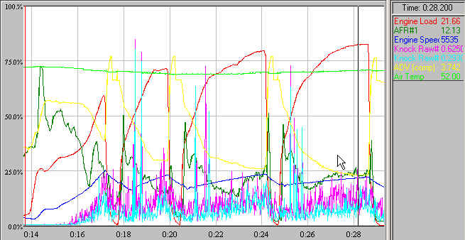

Here's a screen grab of my latest log.
The AFR in fourth gear is a little high, but that's because I hadn't run that much boost before. It's just a matter of adding some fuel to that part of the map. Also notice how the inlet air temps go down. That's a good intercooler.
Timing is about 4-5 degrees. There's plenty of room for some major horsepower. I'll now spend the time to add meth injection. Then I can safely run pump gas at that much boost.
