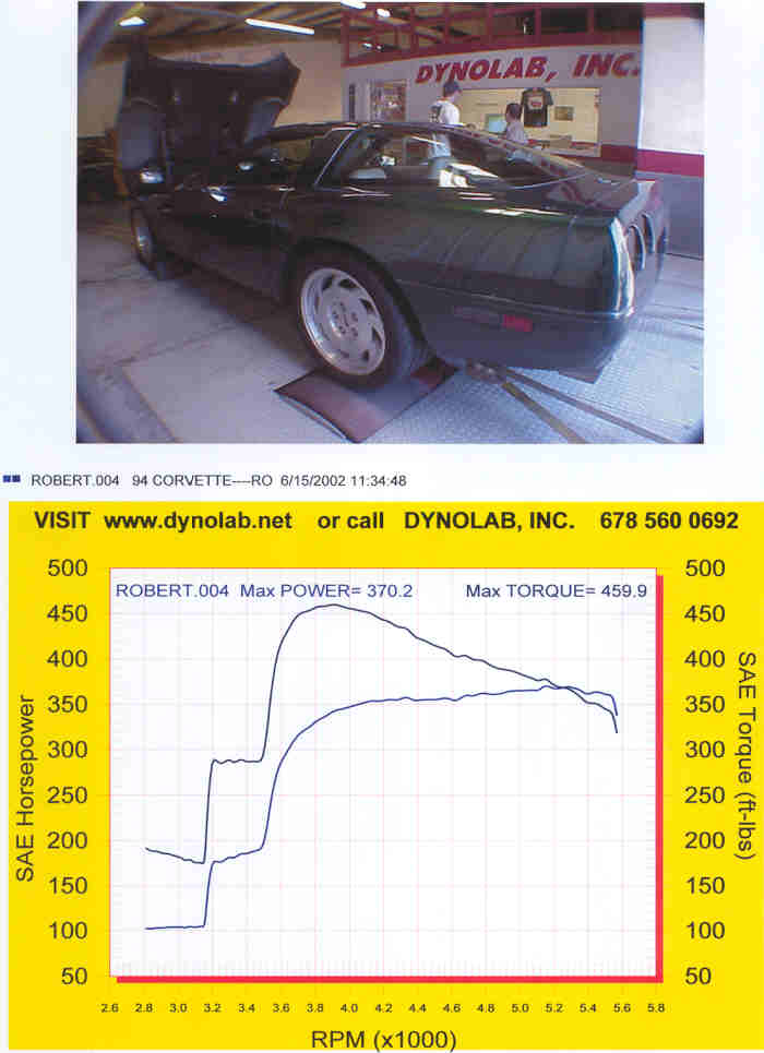

Here's a few random points I want to make. I'm new to the SC300 world having owned mine for about a month now, however, I've been a gearhead all of my life. Exactly as somebody mentioned, the "best" nitrous system is always going to be direct port. There's a reason NHRA Pro-Stock cars use this setup. Intake manifolds weren't meant to flow liquid. With a wet kit, you always have the danger of "pooling" of unused fuel in the intake manifold. This can cause a nitrous backfire. Basically an explosion in you intake manifold. Not good. Dry kits are cheap, and easy, but best used on a mass air fuel injection system instead of speed densisty. The SC300 has a mass air system. My Corvette also has a mass air system and I use to run a 135hp shot dry kit on it. One of the cheapest and easiest dry kits on the market is the Compucar "Bag Kit". This is a universal system that can be installed on ANY vehicle in less than 30 minutes, and comes with the appropriate jets for anywhere from a 30 to 150hp shot. This kit injects the nitrous upstream of the MAF sensor, and as it passes by the MAF, the MAF richens the A/F ratio to match the nitrous. The only concerns with it are than you need to make sure you have a healthy fuel pump, and that you aren't already maxing out the duty cycle on your injectors. This kit is $396 with a full 10lb bottle. Depending on your area, refill prices vary, but you can normally find it for $2-$3 a pound. So 10lb bottle will cost you $20-$30 to refill. How often you will need to refill is greatly dependant on the size shot you use and how frequently. On my Corvette with the 135-shot, I could get 6-8 full 1/4 mile passes out of a full bottle. So obviously a lower shot and less use would allow a bottle to last longer. People get too wrapped up in the HP of nitrous also. Nitrous has a greater impact on torque. Without getting too much into the physics of it, HP doesn't really exist. HP is defined as the numeric representation of torque applied over a period of time (RPM). Torque is what matters. It's what accellerates the car. When you dyno a vehicle, the dyno ONLY measures torque. It then uses an formula to use the torque value and the RPM value to derive the HP value. This forumula balances out at 5250rpm, this is why if you look at the dyno chart for ANY internal combustion motor, the HP and torque curves will ALWAYS cross at 5250rpm because this is when the forumula balences on both sides. When I had the 135 shot on my Corvette, it picked up 117hp at the wheels on the dyno, but almost 170 ft-lbs of torque at the wheels. A 170 ft-lbs jump at the wheels feels like a Mack truck just nailed you in the a$$ when you hit it. This is the reason my Vette would bust the tires loose at 60mph when I sprayed it. Just for reference, you can see the noticeable jumps in power curves when I sprayed it on the dyno. If you can't tell, I hit the nitrous at about 3500rpm.
http://www.hi-psi.com/bbpics/dyno2.jpg
I am by no means a "nitrous guru", but I'll happily answer any questions anyone may have that I can.
