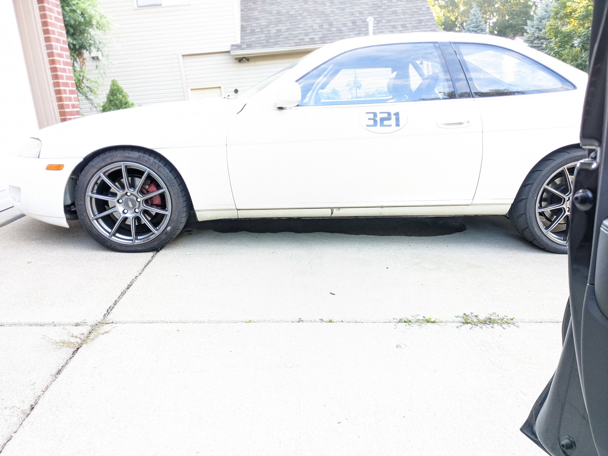

Post dyno I parked the car on my slanted drive way. An hour later there was a serious oil spill under the car, roughly a qt. With the car in the air, its clear the rear main seal was pushed out due to excess blow by. I'd done 10 dyno pulls. I pushed the seal back in with some screw drivers, but I dont really expect it to work properly anymore
Decided to buy a GM smog pump and run it as a vaccuum pump. It comes on only at full throttle, as I've read they do not work well under continous use. I converted the existing PCV lines from an atmospheric catch can vent to PCV->catchcan-> intake with check valves The hope was all this suction would keep the oil in. Also added a PVC Vacuum sensor w/ data logging. It shows the pump can pull 1" of vacuum. The pump does help notably on the street too, the crank case never gets over +0.5in

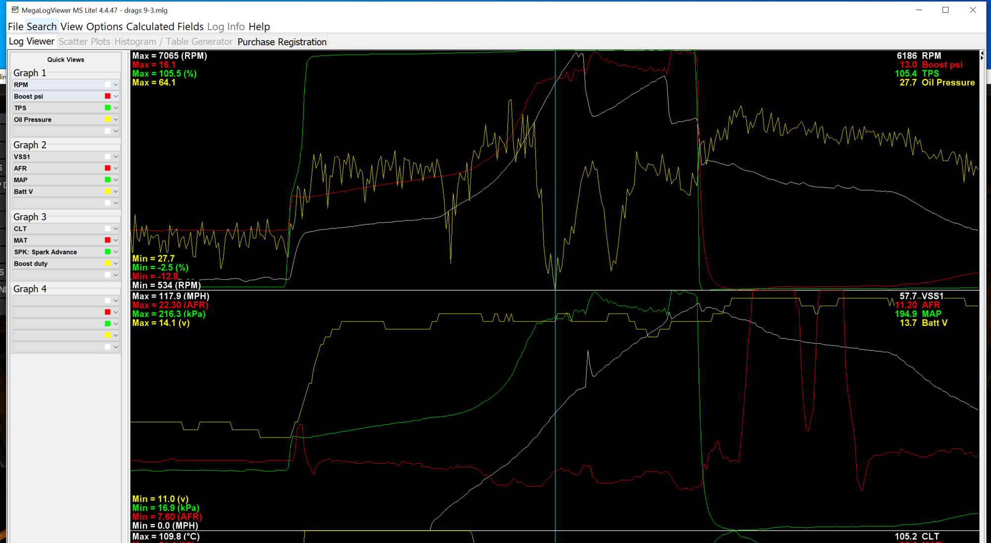

Took the car drag racing. At the 1/8th mile mark, the power disappeared, just like at the standing mile event. Still ran an 11.2!
Data log shows no oil pressure (20 psi only) on launch, or for 5-6 seconds after. Also shows the turbo died and stopped making boost.
Bought another new turbo....
And an accu-sump

With the new accu-sump in, oil pressure was much higher and only dropped to 27 for a split second. The car dumped oil on the track at the start line, out the rear main seal and I was ejected from the track

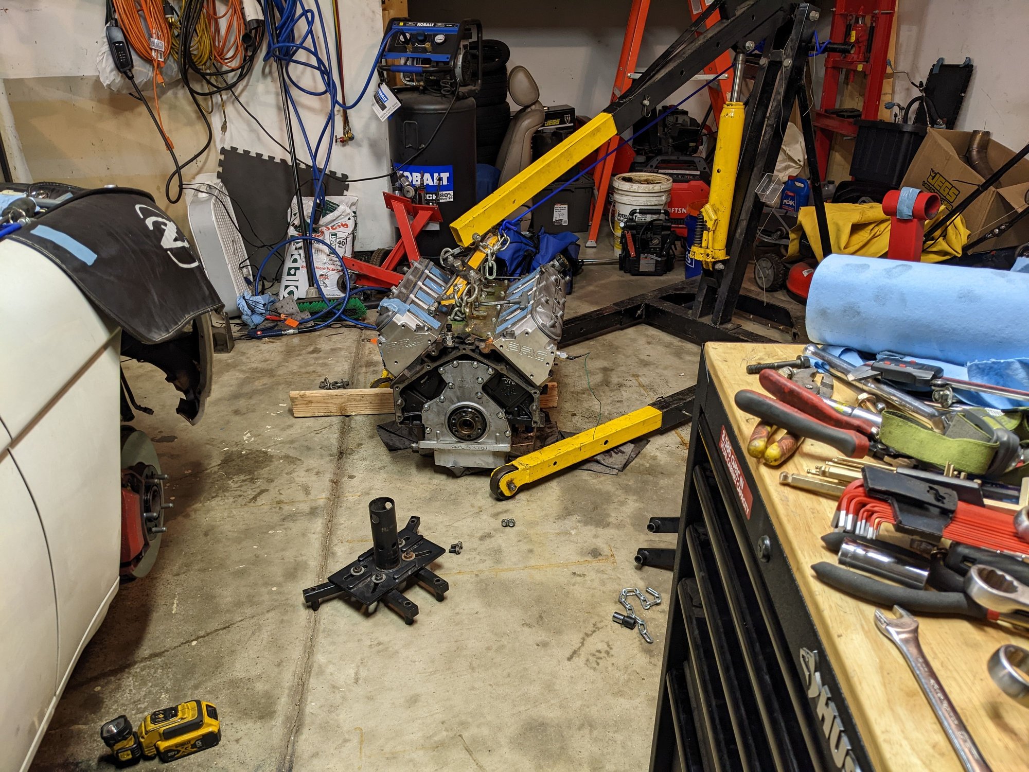

Teardown time
Found the Turbo Bearings!
More turbo bearings
Dang.. Oil pump is trashed!
Rod bearings were replaced by me ~1000 miles ago. Worn through to the copper, about to spin?
Main bearings are scored up, but mostly intact. Crank has some grooving. These are the original 175,000 mile bearings. Pretty amazing
Both engine mount bushings have failed. Thinking about going solid...
Camshaft is in good shape except for a big chip on lobe #1. Lifter #1 has matching damage. I wonder what happened?
Cam looks pretty good, but will be scrapped due to lobe damage
Cam bearings worn through to the copper. Cam journals looked OK though. Maybe thats from the 20W50 Oil I was running, haha.
Very bad design on the oil pan. Think this is my main issue. Aerated oil from my turbo scavenge pump is being put in at the red fitting towards the top of the pan in this image. Right near the pickup
The rear part of the pan is sloped on a ~30 degree angle, encouraging the oil to leave the lower sump on launches. The holes in that baffle plate are too big to do anything at all. Will be cutting up and modifying this POS oil pan which has killed 2 turbos and ruined this engine. I wish I could go dry sump, but there is no space left to fit a pump due to the turbo manifolds and turbo exhaust.

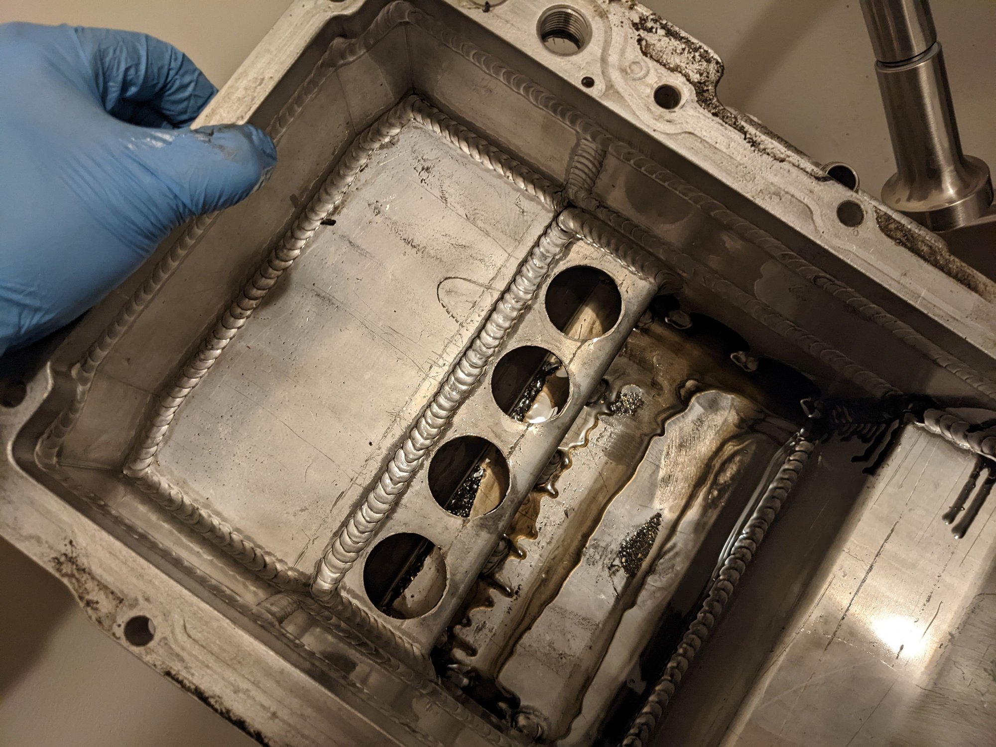

There are four major design flaws in the oil pan, which caused the engine failure.
  • There is a 30deg ramp at the back, under the angle plate with the circular cut outs. On acceleration, oil goes up this ramp and away from the pick up
  • The "wings" have no hole to let air in. If the pickup sucks the center part dry, oil will not flow from the wings to the center, as air cant get in to displace the oil. There would be a vacuum in the wing area
  • Aerated oil from the scavenge pump is being dumped into the wing of the pain, below the oil level, adding a lot of air to the oil. This will be re-done to dump the oil into the head instead.
  • The capacity of the pan is only 3.5 QT!!!!!!!!! That's less than my old 2.5L Toyota.. Just wow...
Here's the work done to hopefully fix the oil pan. The newly added bottom adds 1.1 QT, and is just a few mm above the lower subframe for ground clearance
Found more turbo bearings
Cutting out the poorly designed parts
Planning where the trap doors could go
Cutting the bottom out of the pan
Used a Jigsaw to cut the bottom out
Making a new bottom. Made a paper template, traced it onto Aluminum and cut it out. Used some tape for a mock-up fit.
Tack welding
Fully welding inside and out on this new piece
Welding finished
Time to attach it for good
Paper template with some off-the-shelf trap doors
Turning the paper templates into real parts
Added a hole to let air into the "Wings" then tacked into the pan
Test fitting the rear wall. This prevents oil leaving on acceleration. There was a 1" lip added to the top of this rear wall, forgot to grab a picture. The lip went forwards so that oil could not go over the top of this pan
