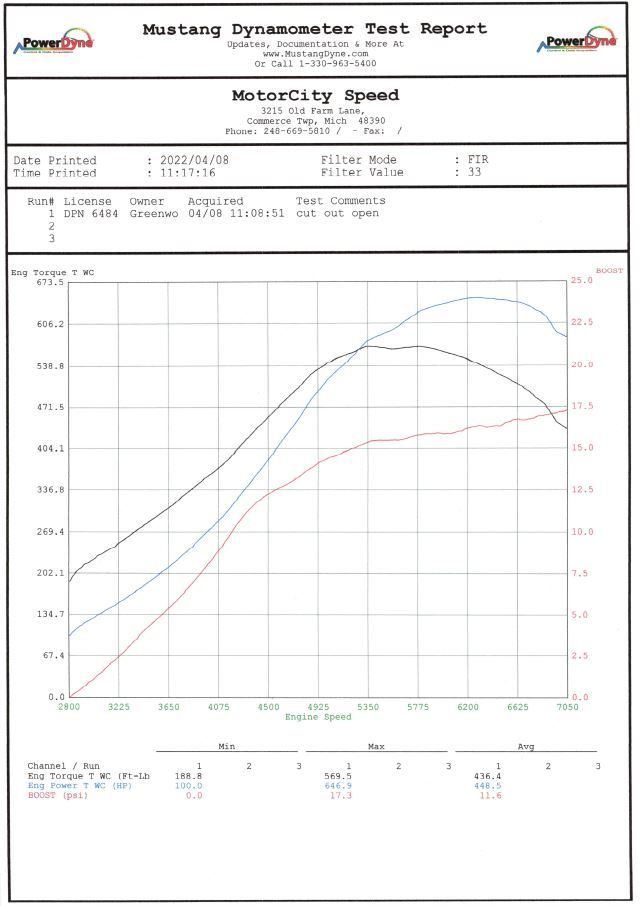

With the cut out open, and the underdrive pulley keeping the alternator alive, it made nearly 650 whp! Not bad..
Water methanol dropped the IATs below ambient, awesome
For the ECTA mile I need to add a block off plate With the plate it only made 575 whp and had trouble revving out
Used they dyno data for the blocked off cut-out to calculate shift points. Seems I should just rev it to redline in every gear

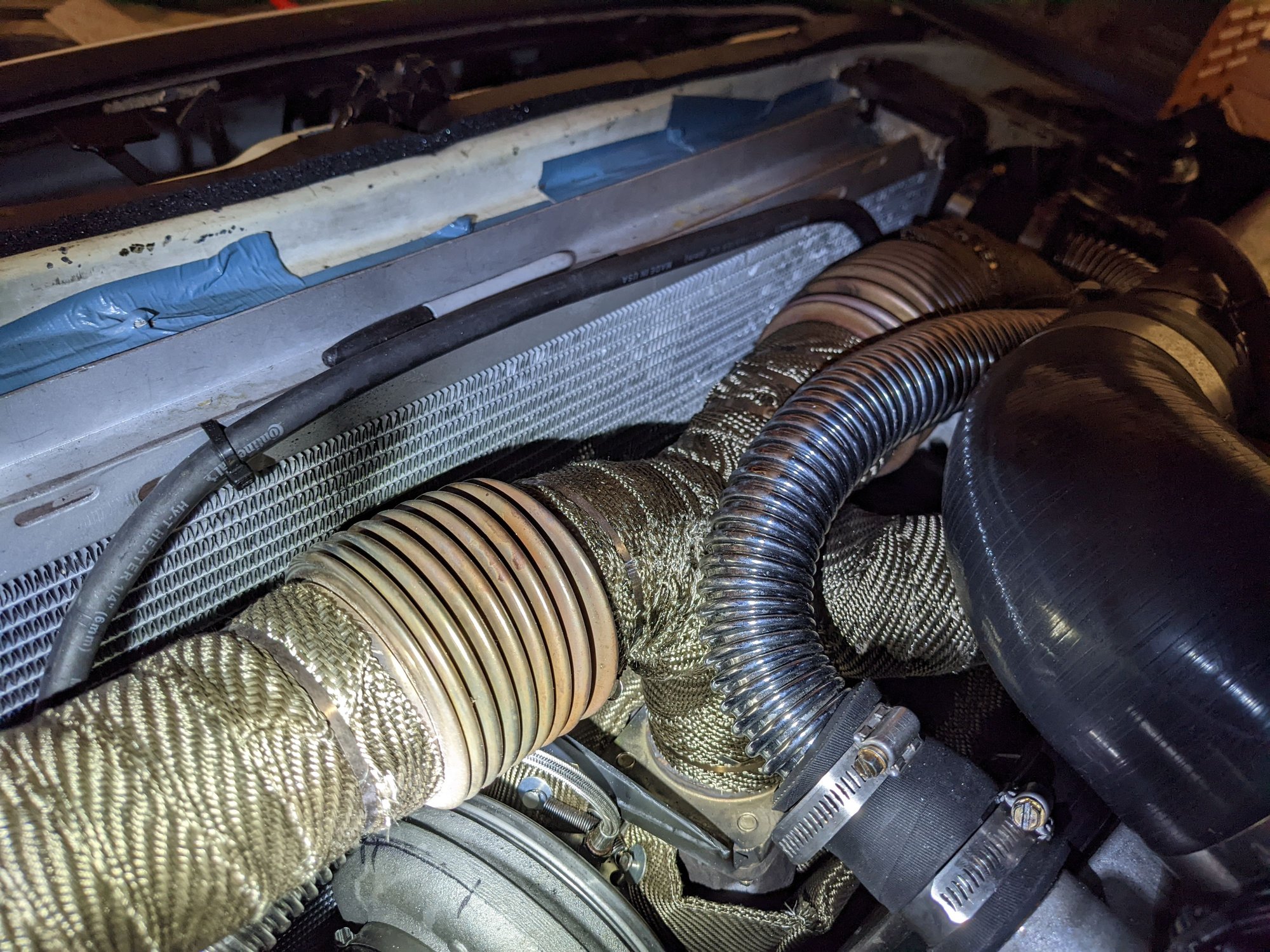

At the ECTA mile, they made newbies like me run a training run at a reduced speed. The second run I made was the class record taking 183mph run. I planned to continue running through the day, however on the next run both of the exhaust bellows joints right above the turbo broke. The passenger side exhaust seems to have warped and bent the bellows into a very strange angle. The drivers side just plain ruptured and sprayed exhaust straight onto the radiator leaving a cool stain pattern.

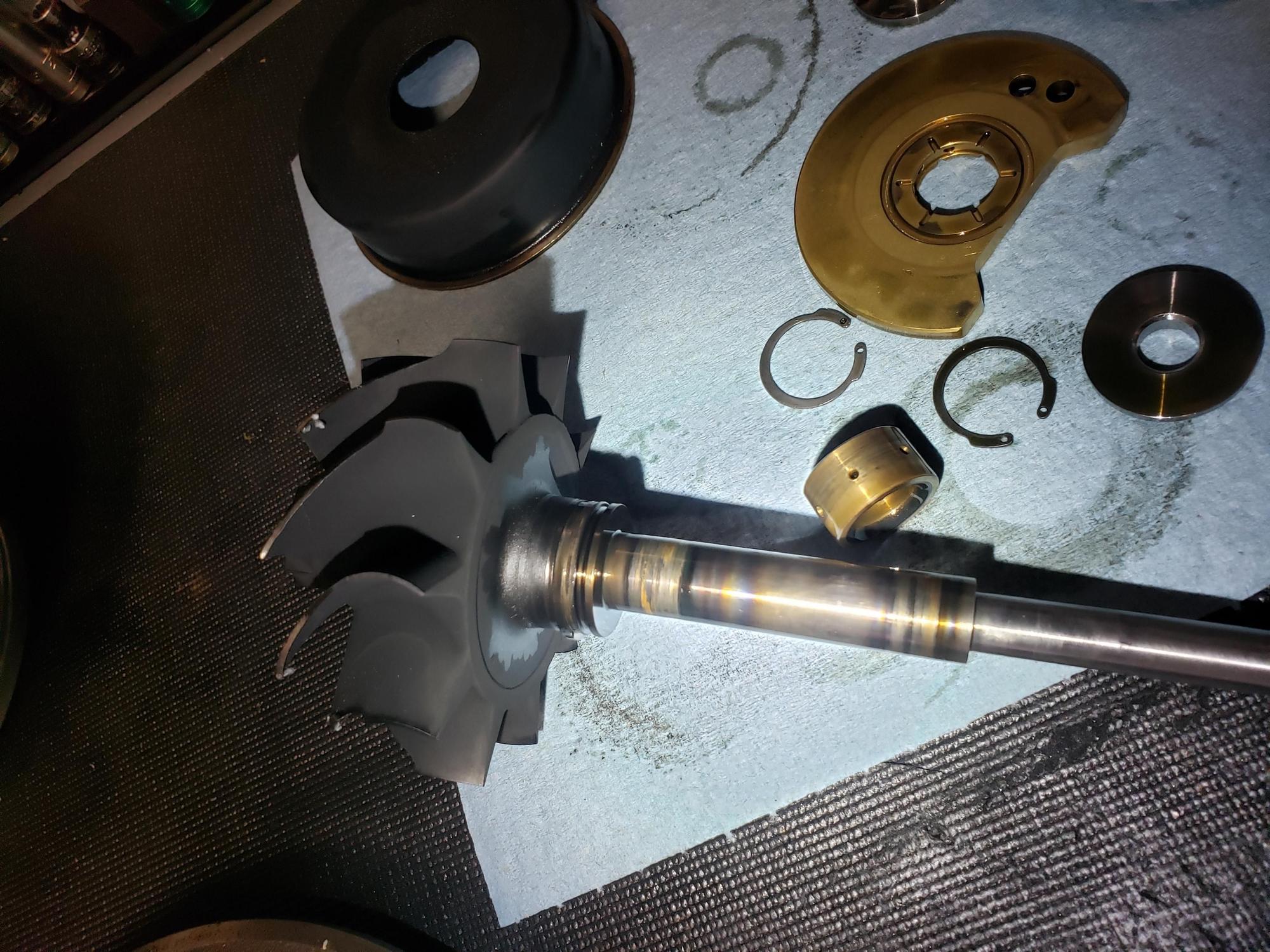

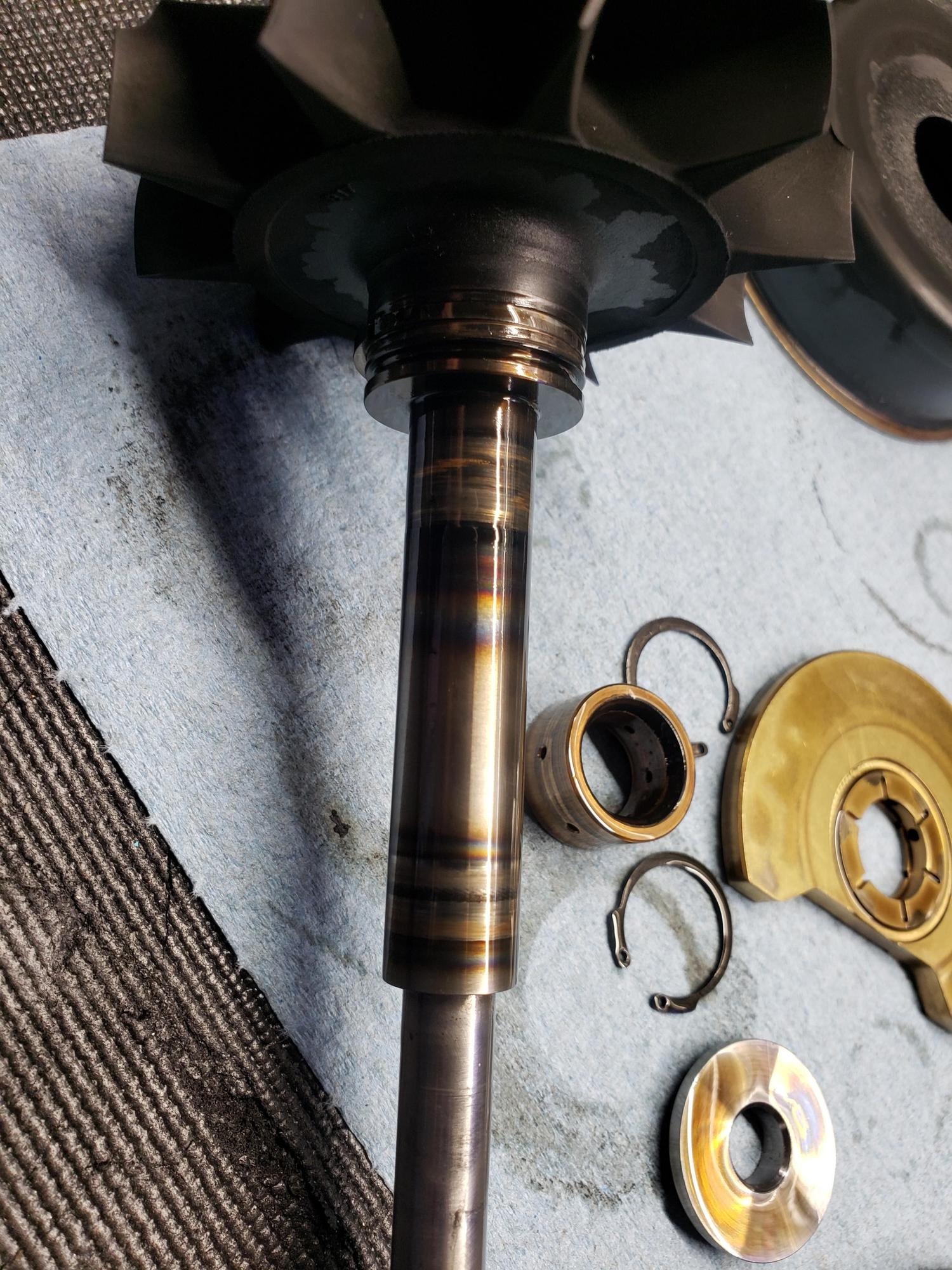

The turbo failed... Blades have contacted the housing, both are shredded.

This is an AGP turbo, and those guys have some of the best customer service I've experienced. The turbo was pretty new, I shipped it to them for a teardown, within 24h they sent me pictures and explained that it was a lack of oil that led to the bearing failure. Looking back through my run videos, sure enough oil pressure dipped down under 20 psi half way through my last pass.
AGP gave me a deal on a new turbo even though I'm at fault. A+ company.
My oil pressure gauge is visual only, I'm going to wire it into the ECU instead of the fuel pressure sensor and set up some safety's to kick in if it dips.

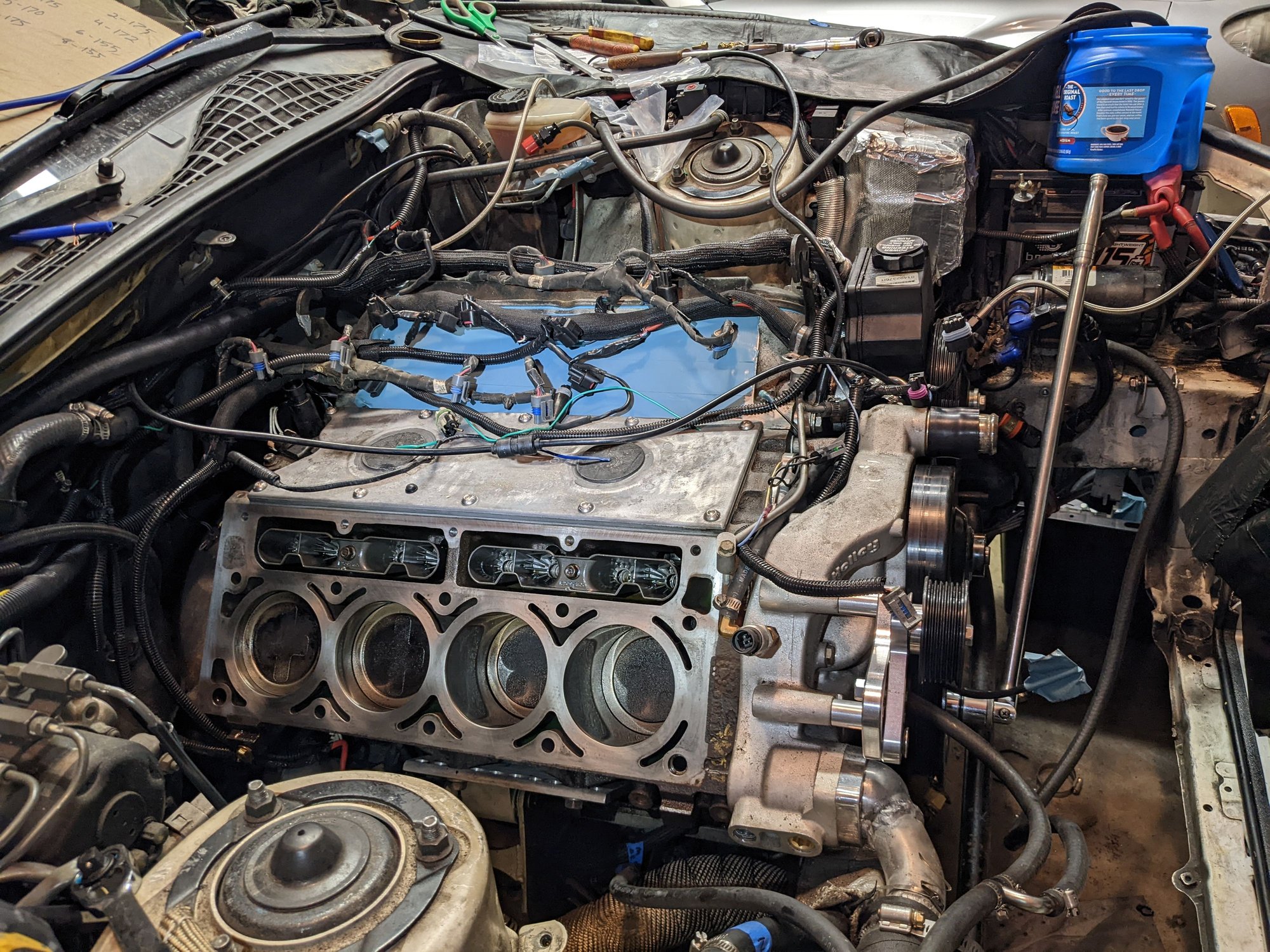

Teardown
Old Cylinder Head
Block is pretty worn, roughly 0.010" oversized through wear. Some scoring in the bore too. I'm amazed it runs as well as it does
Surface prepp'd for new head gasket
PRC 220 as cast head. 2x the flow of stock
Chceking PTV clearance. Didnt work, ended up using a dial indicator
This is a summit racing brand cam and lifters. I'm really disappointed in the wear. There is grooving, and a noticeable amount missing of the top of the lobe. I will not buy this brand again
Gasket was leaking, replacing it
Intake was hitting the ARP studs. Wonder if I had a boost leak? Clearanced the intake with a dremel
