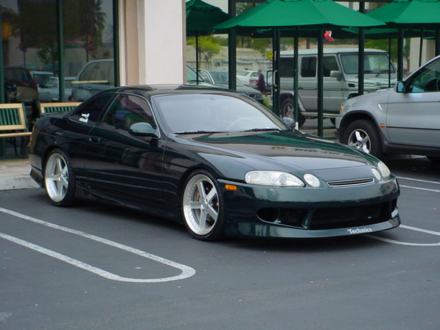

Default cut springs w/pic
heres a link of the pic...for some reason i cant put the pic on this thread..
There you go

Looks very good....I like it

NICE! I love that front bumper.

What springs are you using? Also how much did you have to cut them?

Looks sweet but cutting springs is ghetto.
Hows the ride?
If you can afford it, you should have gone with coilovers.

Your car looks sweeetttt joey...Is there any side effects of cutting springs..?
What kinda wheels are those...looks nice..

I believe those are 19" Racing Hart C5's, I love those rims.

The wheels are Manaray Sport Hyper Revolution. 18s are the biggest they are made in.

Whoa cut springs??!??! On an SC? I always thought that once the springs are cut they're no longer captive?

What you mean captive?

i must say joeyc2, you really make me think twice about turning my green sc into a metallic blue sc. More green sc's !!

what kit is that?

T&E Vertex Kit...

By captive I think he means the base of the spring will no longer seat well on the strut perch? The ends of your springs flatten out to seat evenly on the strut perch. When you cut the ends off, you lose that quality of the spring as well as integrity/strength. Your shocks must be hating you right now, just don't hit any bumps in the road too hard or they'll explode on you. There are other reasons why it isn't a good idea to cut springs, including imperfect geometry. I don't know why you didn't just buy Eibach lowering springs? There's a brand new, unmounted set in the classifieds right now for $200. That's $150 off retail! Please, no more spring cutting...

Cutting springs does offers some practical alternatives to off-the-shelf performance spings. The first is that its much cheaper (ie. free, aside from your labor). You also get to cut the springs to any length you want, vs. aftermarkets which typically come in only one side. There is a trick cutting them properly (dont use a torch) and seating them on their perch. And if you get it right, it should have the same geometry as Eibachs; you should get an alignment using either setup as toe-in will change.
Its defintely not something for the first-timer on their Lexus (learn on someone's Mustang). Sure seems JOEYC2 knows how to do it right.
For those who dont know, buy the Eibachs.
