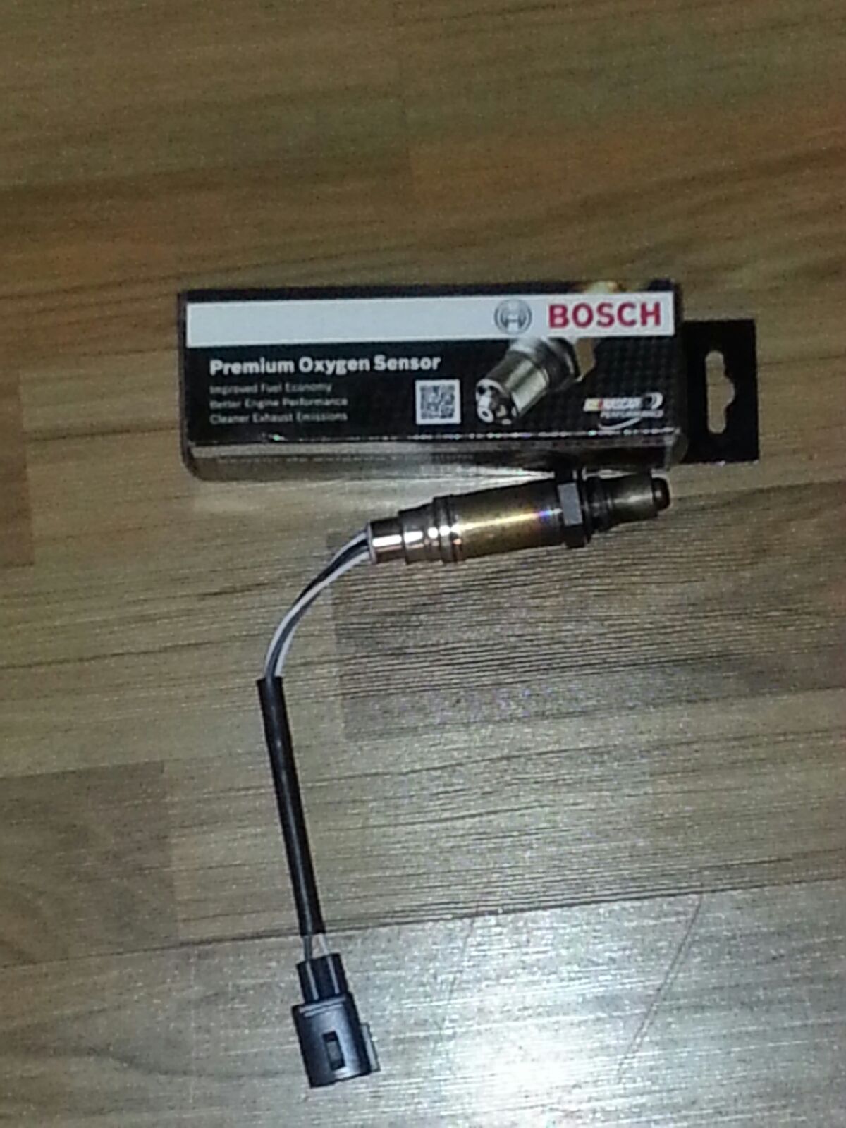

1JZPWRD, just wanted to say thanks for the DIY information on the o2 sensor.. Other than the grime from the oil pan it was a very easy fix. No need to pull back any interior carpet. The clip was probably the hardest thing to remove located on the outside of the car.
New timing belt, power steering pump, water pump, & belt tension pulley to be tackled tomorrow.
Here's a look at my o2 sensor
at 133,300 miles.
at 133,300 miles.
I ended up replacing both upstream o2 sensors to remedy the code 25 problem I was having.
