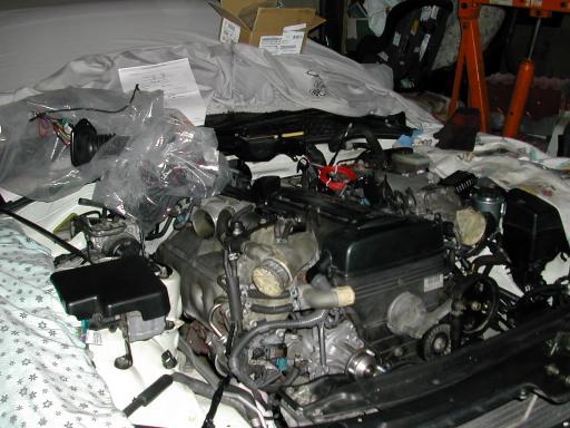

Here are a couple of pics.
It's a 98 US spec gte with 30k miles on it
I've removed the fuel pulsation dampener and I'm replacing with a -6an line to help feed the beast. Also waiting for my egr block off plates as well. Might as well do all of this stuff while the motor is out of the car much easier to get at!

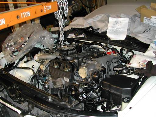

Here is a pic of where the oil cooler taps into the block ( on the left side) then exits and to the right the hose connects to a metal tube that wraps around the back of the block. I hope this picture helps.

Old Mar 10, 2003 | 08:51 AM
motorheaddown's Avatar
motorheaddown
Joined: Aug 2002
Posts: 714
Likes: 14
Chris,
According to the '93 Supra new car feature book, the oil cooler picks up the coolant from the block. In the picture you provided, the coolant "feed" line is the one on the left that's visible. Can you tell if there's a coolant bung on the block? If you still have your ge motor, can you give me an idea of whether or not that bung can be tapped for the coolant feed?
Thanks,
-scott
