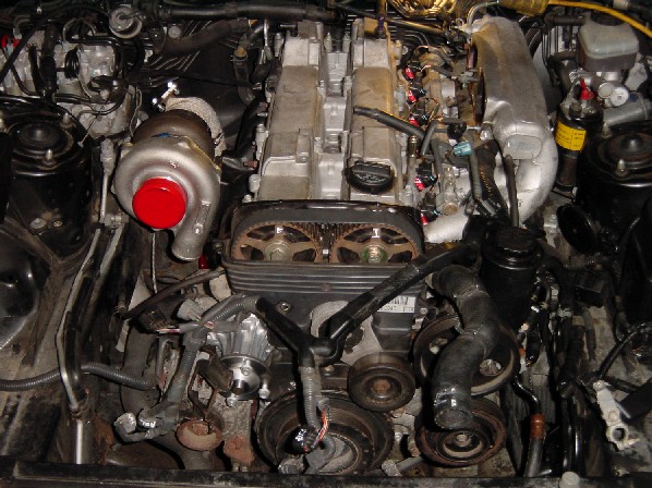

Alright the injectors are in and the car is beginning to be put together again.
Updates:
I bought dual electric fans to provide room for intercooler tubing.
I bought one of those yellow batteries.
I bought a Universal Greddy 60mm Piping Kit to make some intercooler tubing.
The company that was getting me the Strut Tower Bar was crooked and I had to stop my order. But I will get it through another company.
The midpipe now fits perfectly after some modifications. I will use the stock exhaust until I get the 12psi tuning.
I had to buy a Supra O2 sensor since the stock secondary O2 sensor does not mount correct.
