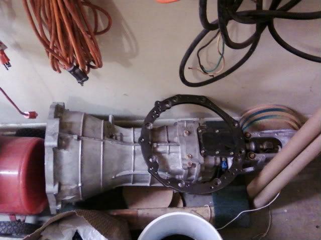

Ok i will shine some light since I'm doing this to mine. 1uz to z33 trans
I'm using the flywheel from a toyota 4 runner 3vz (modded slightly)
Clutch disc: nissan sr20 / 300zx / 350z etc.. all them will fit the input spline
Pressure plate: mr2 turbo
Throw out bearing needs a spacer (seems to release the clutch but i haven't driven the car yet)
You need an adapter to fit the pilot bushing (very simple)
custom transmission cross member (trans mount from a 300zx or 240sx is the easiest)
Drive shaft: you will need a slip yoke from either a 350z or a nissan titan and have a shop either weld it to your oem drive shaft or make a new 1 pc
Shifter assembly sits far back so you will need to cut it and re weld it about 4 inches ( or buy the custom bracket which $200)
I'm not done but that's what i found out first hand so far. There is very little info out there and that's why its taking me so long to complete. I bought so many parts that were not necessary.

you got any pics of the adapter plates you made
