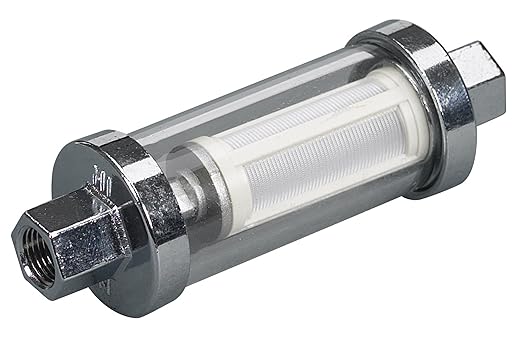

Shane - is there a small filter at the end of that line ? if it is open dirt / dust can get in through it.

Somehow depending on your fuel pumps (especially if you have dual or big pump) , a vacuum is created inside the fuel tank when flowing a lot of fuel in high HP... so IMHO dusts can be sucked in , so many of us put filter under the fender on that hose.

that a good point, I used to use a universal fuel filter from the auto store, cheap and helped keep down some fumes and keep the lines clean. kept it where the charcoal canister was next to/ under the new catch can.

Would just a regular old gasoline fuel filter work ?? Any ideas??

probably but not sure, those are kinda bulky though. I used something slim that I could see through like this.
Gerrb probably has some good ideas and more experience with it I ended up re-installing my canister lol.

As Ali had said, a small enclosed cylindrical fuel filter for me is better since it helps keep the smell / vapors from within. A small air fuel filter we put on catch cans will do but you won't totally keep the smell out , though will filter air in.
Some will cut it all the way to the back as SCereal had mentioned, before a filter is plugged at the end.

Small fuel filter it is then.
