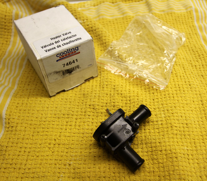

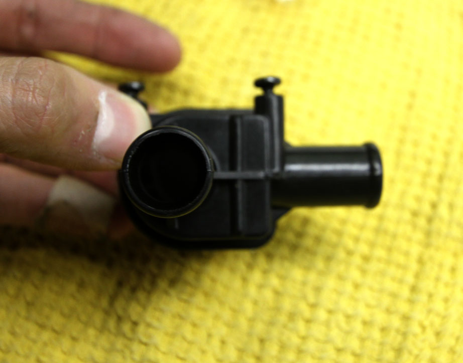

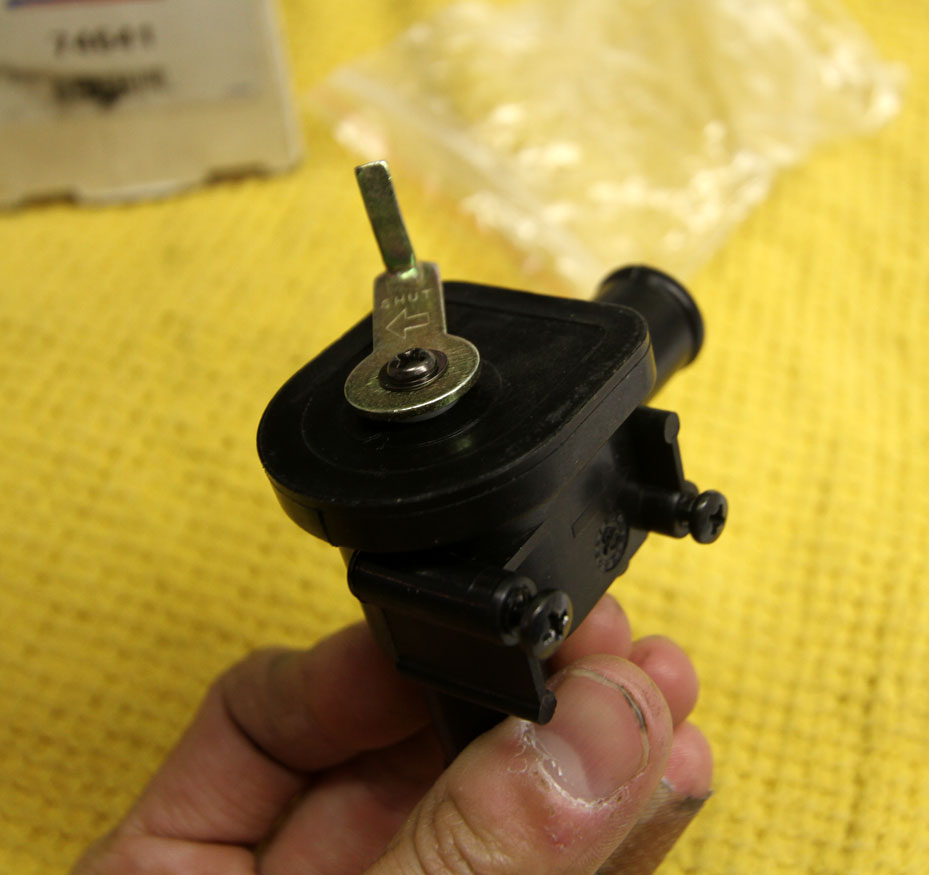

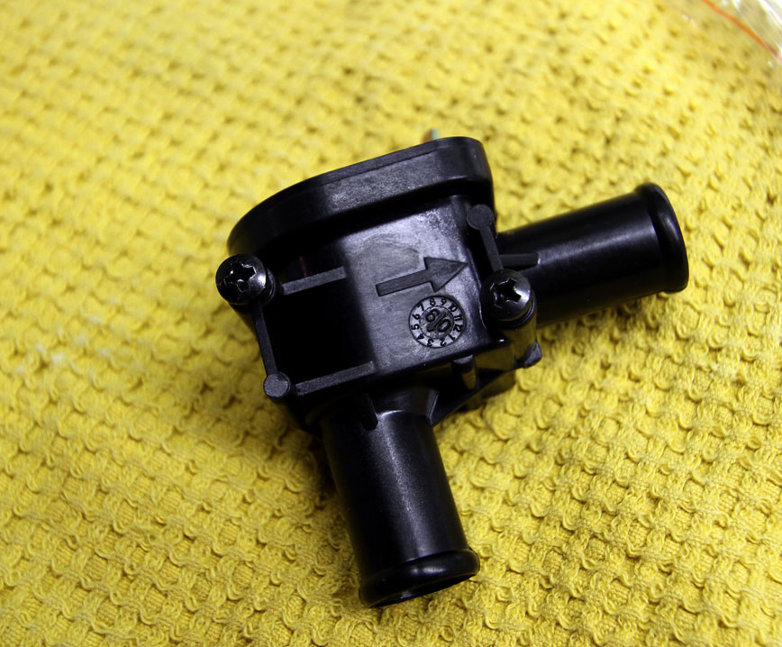

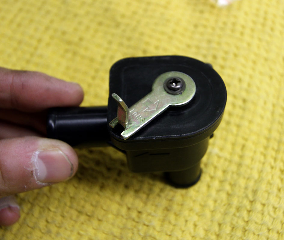

As promised, here are some pictures of the Four Seasons #74641 heater control valve. Again, I have not yet tried this on my car as it seems my original heater control valve is still working for now. It does look very similar to the Lexus SC valve.

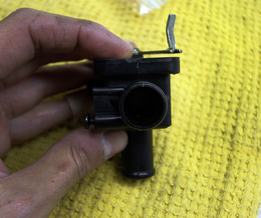

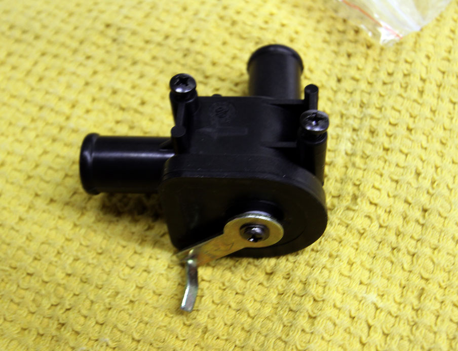

Okay. So I've taken a few pictures of the heater core control valve and how things orient with the changes. Hope it makes sense.
Picture 1: The HCCV straight out of the box. The default is for the fluid to flow as opposed to the OEM version where it's set to be closed.
Picture 2: The HCCV modified.
Picture 3 (bottom right): How the two compare straight out of the box. I ran into an issue whereby using the original bracket is almost impossible without modifying anything.
* Now, what I'm not sure about is whether the flow direction arrow show on the valve has to be oriented the same way. If not, then ideally all one needs to do is make no modifications to the Motorcraft part, just spin it so the flow arrow is opposite and voila, heat is now "cold" and cold is now "heat".

Well it happened: my heater control valve didn't fail so much as completely snap at the block hose connection. So now I am forced to try my solution with the Four Seasons control valve.
Some good news: the #74641 basically identical to the Lexus valve and bolts right in. The little template connection for the arm fits as well. All would be good EXCEPT: Four Seasons made their arm guide template face in another direction. Now this isn't the position of the arm itself, just the mounting template it (and the Lexus part) fit into. So this is a VERY CLOSE solution but I suspect I will need to order either the #74004, #74636, or #74637 versions. I forget which one was basically identical with the arm facing 180-degrees opposite of the Lexus valve but that's the one I am going to try to identify and order now.
It sounds counterintuitive but it may be the ticket since basically everything else bolts right up. If the other version means the Lexus valve arm bolts into the correct position, I think we'll have yet another viable alternative. I'll post my pictures and findings into my valve thread as well once I know more.
Another thing this tells us is that Toyota/Lexus really doesn't re-engineer everything. They undoubtedly used an existing valve design and added the Soarer control hardware and solenoid to it.
Update: The Four Seasons (aka Everco) #74637 is NOT a potential fit either, as the arm still rotates in the opposite direction compared to the Lexus valve. Tomorrow I am trying #74636 and if that doesn't work, #74004 the following day (soonest it could be obtained). Note: all of these still bolt in exactly the same way.
So far (updated 1/15/2014):
F.S./Everco #74641 -- fits, but arm rotates in wrong direction
F.S./Everco #74637 -- fits, but same as above
F.S./Everco #74636 -- WORKS, but requires slight Dremel modification to non-mounting side and re-use of Lexus valve arm
F.S./Everco #74004 -- fits, but arm rotates in wrong direction

I'm reposting here to keep things consolidated.
So I recalled talking with the guy at the Autozone store I've been going to and he owns an MKIII Supra Turbo. He mentioned that the HCV assembly for his Supra looked very similar to mine and that he was having a hard time looking for a new valve himself.
So I researched here:
http://www.supramania.com/forums/sho...ol-valve/page2
And especially here:
http://www.supraforums.com/forum/sho...-valve-bypass&
And this led me to the Four Seasons / Everco #74850 heater control valve. Unlike the others so far, this one has an arm moving 45-degrees in the CORRECT direction. If you look it up anywhere for sale you can see that the arm's direction arrow is facing correctly. It also appears to bolt up just like the others do.
I'll be ordering one of them tomorrow to test along with the #74636 (which I now think won't work either but who knows -- update: it DOES).

Everyone, the Everco (aka Four Seasons) #74636 valve WORKS. It fits and the arm rotates in the correct direction for open and closed. All that is required is that you swap the arm over from your blown Lexus SC valve. It mounts in exactly the same position with the template guide. The mounting points on one side protrude too much into the rest of the assembly but this is an easy fix with a Dremel. Pictures to follow.
The #74850 was mentioned as a tried and true fix in Supra MKIII threads and I was going to try that one next but I'd consider it a mere footnote now.
If the rest of your assembly now works, buy the Everco #74636 valve.
