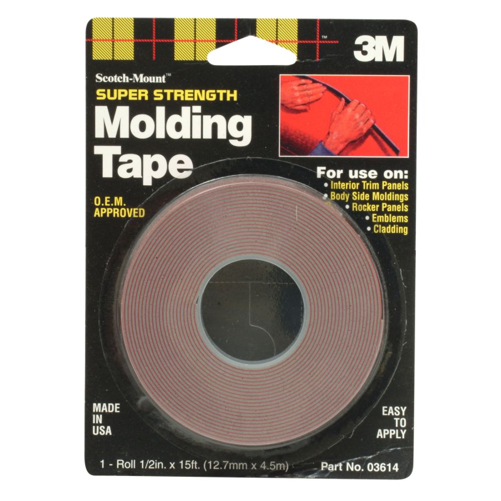

ok does anyone know what i should use to put the emblems back on?
im reading reviews about 3m double sided tape and no one body seems to have good results for their car emblems as it to think and the foam gets wet and the adhesive parts get wet.
im thinking about buying some 3m rubber glue?
Old Jan 25, 2011 | 06:24 PM
MrBrock's Avatar
MrBrock
Joined: May 2010
Posts: 188
From: Iowa
3M makes a double backed molding tape that's not foam and works great. I put mine on with it in may and they've held on great so far.

+1 on 3m molding tape, works great! Dont buy a cheap knock off, get the real deal.
