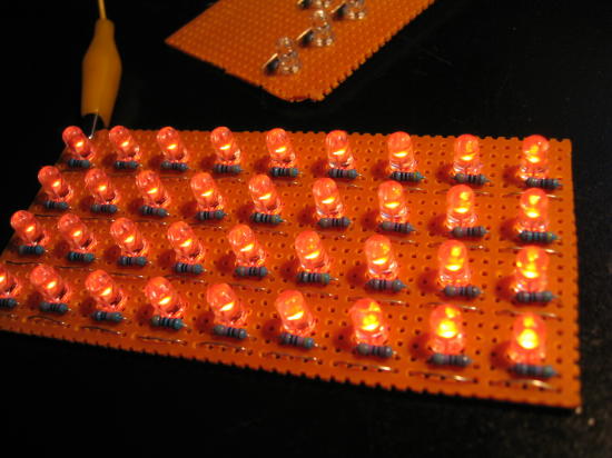

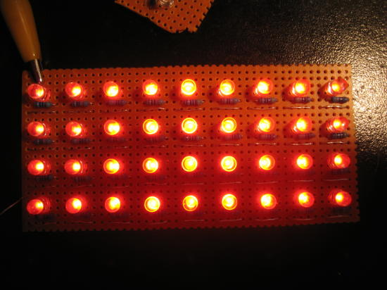

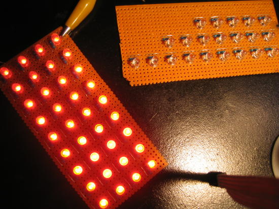

so i do alota headlight mods, with tht finished on to the taillights
heres sum teaser pics of whats to come
ive always been a fan of the led rings in taillights and wished my car had em... so customs the way to go! the white is the ring thas always on i made it white so it stands out more and the middle is red for the brake light in red
i need ideas for the turn signals... gimme idea CL fam!

Props for something different. I think spaces between the LED's need to be filled with MORE LEDs. I don't believe that alone would be bright enough to actually signal traffic behind you that you're braking or signaling. Besides that, like I said, def deserve props and can't wait to see the final product! Goodluck!

mount them on a pcb so they're not pointing all crooked and more evenly spaced. definitely add more. you know you can use two different resistor leads to light leds for parking AND braking right? with a couple diodes you can even use the one set of leds as parking, brake and turn signals too. keep playing, you'll come up with something.

It's a nice start. The led's are not evenly distributed, some are farther apart. There needs to be at least three rings around each other or they will not look filled out or be bright enough. Oh and one more thing, since the SC has such terrible voltage spikes from the most power hungry electrical system I've ever seen, you may want to make it accessible to get back in and replace led's and I've never seen any led tail attempt that is "easy" to go back into and repair since most people do it like you and solder them all together. If they are in series it's even worse..... when one fails, they all do. Saw someone do that once too.
An example from 2004 https://www.clublexus.com/forums/sc-...led-tails.html
Then see post #3 here: https://www.clublexus.com/forums/sc-...installed.html
You have to pack those led's in to make it look good. Otherwise it looks very amateurish and poorly lit.
So I say keep going! Pack'em in.

like klaus said lens is amber/red so the lights show up re/amber i chose white because its brighter
hmm do u knw which resistor would do the parking and brake? i wanna try tht
im gonna add more to to it so there isnt spaces
i have each one wired seperate so if ne does go out i can go in and change just that one but they all thread to one power wire for easy plug and play
ill be doin more work tonight ill post up wen i get more progress
these leds are small but for the price its worth it $.99 for 20 leds along with resistors so i orderd 100 right now for trial ill order more once i have a design and i knw how much i need
