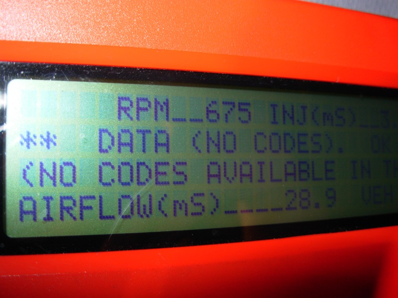

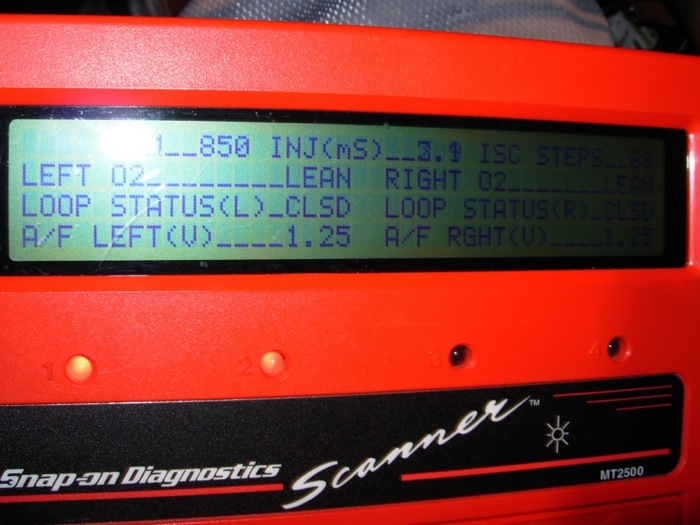

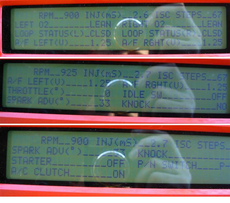

Doesn't matter, the scanners they have and you'd buy aren't capable of reading the computer. Those scanners rely on a light to be on, but Lexus computer scanners read the actual computer fault log and tell you what it logged when the system threw the light, why, etc. With an intermittent problem if you are lucky enough to catch the light on it might not be a bad component you can replace not knowing which part it is before it fails and the scanner only giving you a general area. So, take it to Lexus and bend over for a diagnostics charge, or wait until you are on the side of the road.
If you want to see what a (was then) $2500 Snap-on scanner will tell you about your early model SC, look in my gallery for my snap-on pics from when I had my big scanner.
It still isn't even close to what the Lexus computer will tell you because it cannot read the logs.

From my '92..........
