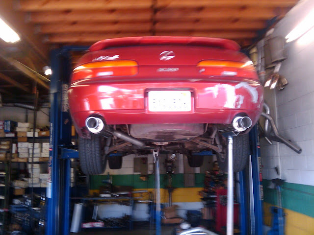

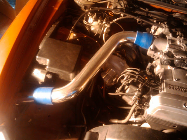

I'll let the pictures do the explaining. More pics tomorrow with videos of the car complete....i just have the install pics as of now but the car is fully running.
Thanks to DaveH for a great kit...thanks to CL for the great help on the many questions i had. I waited 2 yrs to do this and finally found the time and money. I love it...its my first boosted car and what a way to enjoy it with an SC.
couldn't of done it without Blk97SC300's help!
** VIDEOS!!***
1.
2.
3.
These are just the install pics! The car is complete and more pics coming soon.
7psi...custom exhaust from DP back, no cats, aem wideband, safc II, aem tru boost controller, walbro, daveh manifold, egr mod, 12v fuel pump mod, eh many more too lazy to list
stock clutch went toast in few hours after install time for the heavy duty clutch!

took it down to PCH today on manhattan beach...ah man whata nice increase of power from stock...def hooked on boost now

yeah its a custom manifold...(daveh i mean...its made by BL fabricators)

if u toasted u stocker on 7psi becarful cause the same will happen to ur block safe and happy boosting

What AFC are you using?
and does your car stall when you let off the gas? (I see your BOV isn't recirculated)
Yeah i know but the stock clutch was holding great just high gear and RPM wasn't performing good and it was burning with a lot of smell...ACT is on the way thru fedex!
SAFC II...I am OBDI however i have had people that i met that had problems using the DEC AIR feature on OBDII to stop the stalling. But yes my car did stall until i got used to it after a few drives. Just down shift and let the car come to a stop without throwing it in neutral and letting hte RPM fly down. BOV isn't recirced...when i show u videos...u'll know why its not recirced...the sound of it is just appalling

cant really go into 4th gear hard cus my clutch will start pooping. But u'll all get the idea
