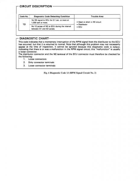

This is what I found for code 13, they indicate that it is probably a connection problem. I would suggest also checking the harness for signs of damage.
